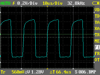

          Thanks for the link to your faq, I understand, which also explains the other two values due to 330k pull-ups I guess.
          I had some progress. So, R5503 was not replaced by me, checked it and it was shorted pads under resistor due to someone using 0402, replaced it now with 0201 from a donor.
          Now there is power on some of the ones previously missing:
          PM_SLP_SUS_L: 3.324v
          PP3V3_SUS: 3.326v
          PP3V3_SUS_EN: 3.324v
          PM_RSMRST_L: 3.295v
          PM_PWRBTN_L: 3.408v
          But still missing:
          PM_SLP_S5_L: 0v (99.1k ohms to gnd)
PM_SLP_S4_L: 0v (100.4k ohms to gnd)
          Added screenshot of clock pulse on U1900 pin 12 taken with a DSO201.

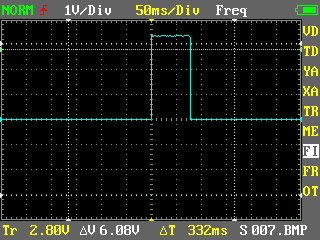

            Re: MacBook Air A1466 - 820-3437
            Also PM_SLP_S5_L does in fact pulse for a few ms right after connecting power.
            Can this at least rule out dead CPU/PCH, also since PCH actually provides PM_SLP_SUS_L ?
            See attached screenshot from DSO201.
              So actually all these has one pulse after turning on power:
              PM_SLP_S5_L
              PM_SLP_S4_L
              PM_SLP_S3_L
              PM_SLP_S0_L
              After the pulse and when signal is low, PM_SLP_S0_L is the only signal that seems a bit dirty low, it has tiny ripples.
              Based on this info, is the S0 power rail the place to start looking?
