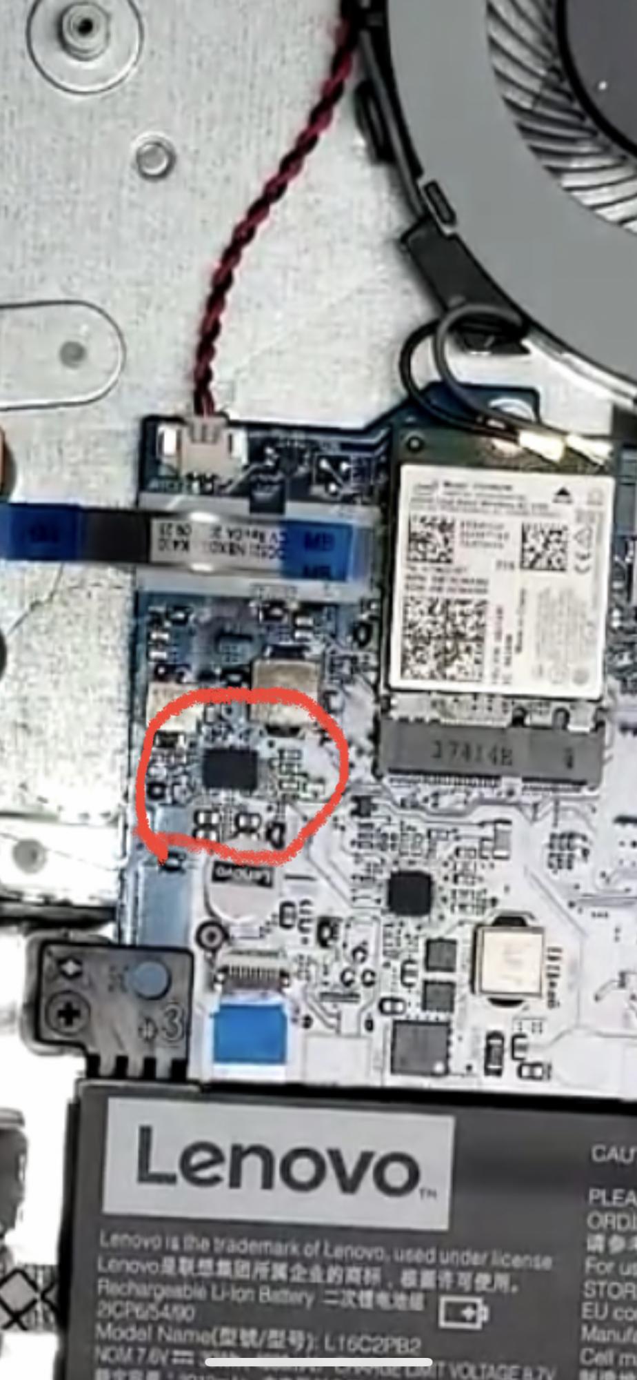

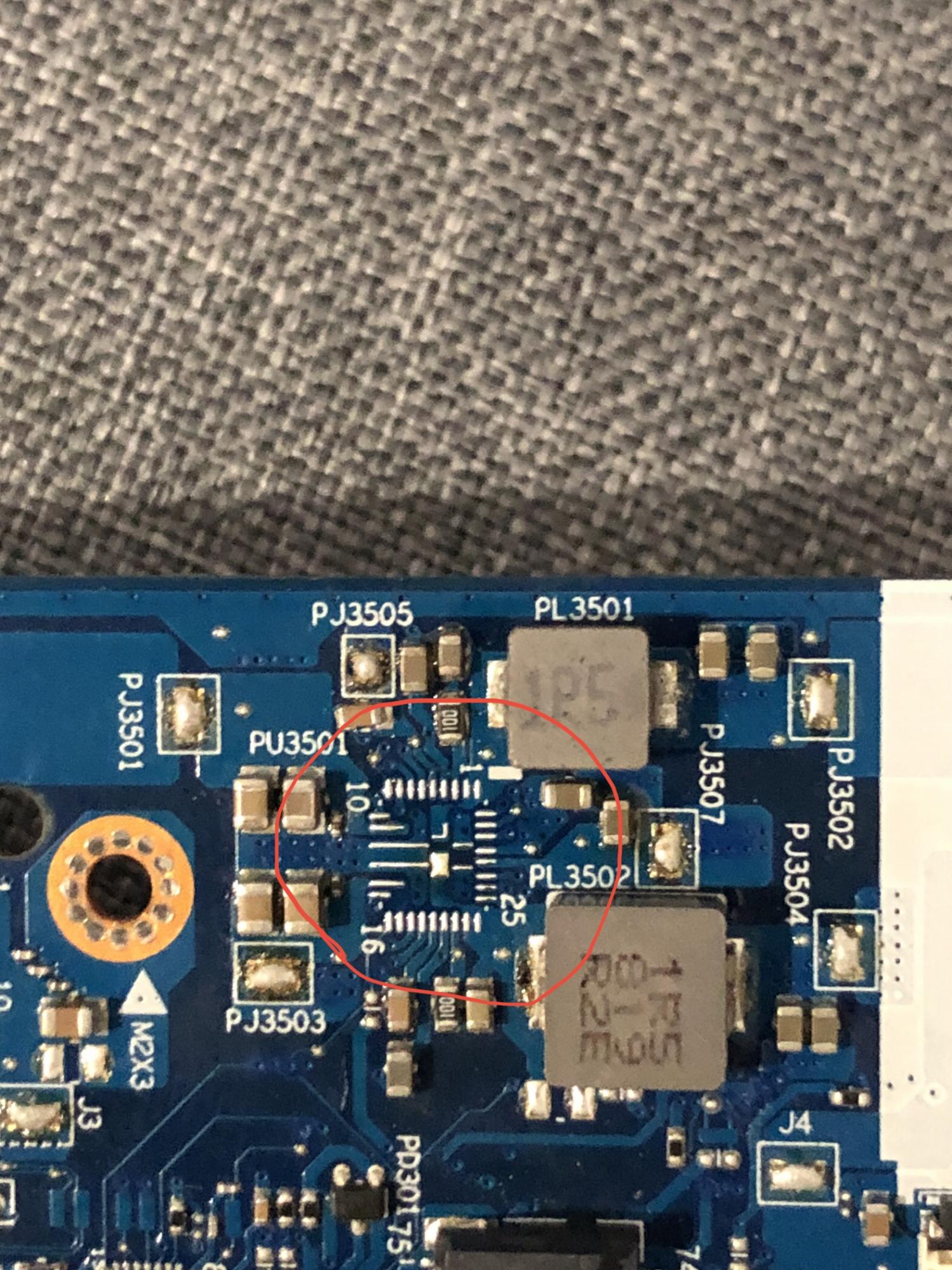

Lenovo ideapad 330-15ikb 3.3v, 5v regulator
  • Smeek
    • Sep 2021
    • 60
    • România
    Lenovo ideapad 330-15ikb 3.3v, 5v regulator
    Please help me
    I have a Lenovo ideapad 330-15ikb, i5 8th generation
    Motherboard: EG521 NM-B45
    3.3v and 5v regulator is getting hot, i want to replace it but i don t find the real name of regulator to buy it
    Is a integrated regulator and mosfet 3.3 and 5 v
    Chip name is 0M=5F
    Please help me with the real name of the ic.
  • mon2
    • Dec 2019
    • 14021
    Re: Lenovo ideapad 330-15ikb 3.3v, 5v regulator
    Your picture is not in focus but believe it is the attached part from Richtek. See the datasheet to confirm.
    • Smeek
      • Sep 2021
      • 60
      • România
      Re: Lenovo ideapad 330-15ikb 3.3v, 5v regulator
      Here is how looks the slot for the IC 3.3 , 5v
      • mon2
        • Dec 2019
        • 14021
        Re: Lenovo ideapad 330-15ikb 3.3v, 5v regulator
        Post a clear picture to show the top side markings and bottom side pins of the IC.
          • 20695
          Re: Lenovo ideapad 330-15ikb 3.3v, 5v regulator
          Originally posted by Smeek
          Here is how looks the slot for the IC 3.3 , 5v
          Its a richtek custom part https://www.aliexpress.com/wholesale...xt=LV5083AGQUF
          • Smeek
            • Sep 2021
            • 60
            • România
            Re: Lenovo ideapad 330-15ikb 3.3v, 5v regulator
            Originally posted by SMDFlea
            Thank you so much
              Lenovo IdeaPad IdeaPad 3 15IGL05 Notebook 3 Specification for Upgrade or Repair
              This specification for the Lenovo IdeaPad IdeaPad 3 15IGL05 Notebook can be useful for upgrading or repairing a laptop that is not working. As a community we are working through our specifications to add valuable data like the IdeaPad 3 15IGL05 boardview and IdeaPad 3 15IGL05 schematic. Our users have donated over 1 million documents which are being added to the site. This page will be updated soon with additional information. Alternatively you can request additional help from our users directly on the relevant badcaps forum. Please note that we offer no warranties that any specification, datasheet,...
              09-07-2024, 05:20 AM
              Lenovo IdeaPad IdeaPad 3 17ITL6 Notebook 3 Specification for Upgrade or Repair
              This specification for the Lenovo IdeaPad IdeaPad 3 17ITL6 Notebook can be useful for upgrading or repairing a laptop that is not working. As a community we are working through our specifications to add valuable data like the IdeaPad 3 17ITL6 boardview and IdeaPad 3 17ITL6 schematic. Our users have donated over 1 million documents which are being added to the site. This page will be updated soon with additional information. Alternatively you can request additional help from our users directly on the relevant badcaps forum. Please note that we offer no warranties that any specification, datasheet,...
              09-07-2024, 05:20 AM
              Lenovo IdeaPad IdeaPad Gaming 3 15IHU6 Ultrabook 3 Specification for Upgrade or Repair
              This specification for the Lenovo IdeaPad IdeaPad Gaming 3 15IHU6 Ultrabook can be useful for upgrading or repairing a laptop that is not working. As a community we are working through our specifications to add valuable data like the IdeaPad Gaming 3 15IHU6 boardview and IdeaPad Gaming 3 15IHU6 schematic. Our users have donated over 1 million documents which are being added to the site. This page will be updated soon with additional information. Alternatively you can request additional help from our users directly on the relevant badcaps forum. Please note that we offer no warranties that any...
              09-07-2024, 05:20 AM
              Lenovo IdeaPad IdeaPad Gaming 3 15ACH6 Notebook 3 Specification for Upgrade or Repair
              This specification for the Lenovo IdeaPad IdeaPad Gaming 3 15ACH6 Notebook can be useful for upgrading or repairing a laptop that is not working. As a community we are working through our specifications to add valuable data like the IdeaPad Gaming 3 15ACH6 boardview and IdeaPad Gaming 3 15ACH6 schematic. Our users have donated over 1 million documents which are being added to the site. This page will be updated soon with additional information. Alternatively you can request additional help from our users directly on the relevant badcaps forum. Please note that we offer no warranties that any specification,...
              09-07-2024, 05:00 AM
              Lenovo IdeaPad IdeaPad 3 14ITL6 Notebook 3 Specification for Upgrade or Repair
              This specification for the Lenovo IdeaPad IdeaPad 3 14ITL6 Notebook can be useful for upgrading or repairing a laptop that is not working. As a community we are working through our specifications to add valuable data like the IdeaPad 3 14ITL6 boardview and IdeaPad 3 14ITL6 schematic. Our users have donated over 1 million documents which are being added to the site. This page will be updated soon with additional information. Alternatively you can request additional help from our users directly on the relevant badcaps forum. Please note that we offer no warranties that any specification, datasheet,...
              09-07-2024, 05:00 AM
