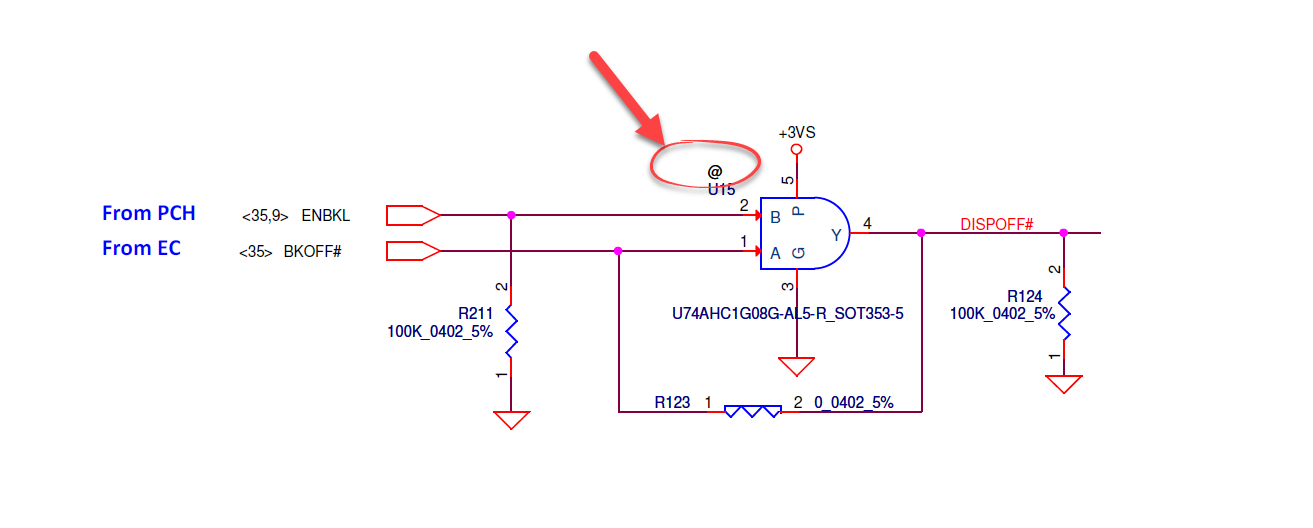

        Re: lenovo 305-151BD display problem
        No, not yet on injecting a voltage.
        This display enable signal (DIPOFF#) is linked to a zero ohm resistor - see top left of the lcd connector in the schematic.
        Check the voltage on the other side of the resistor (R123).
        Is it also 0 volts?

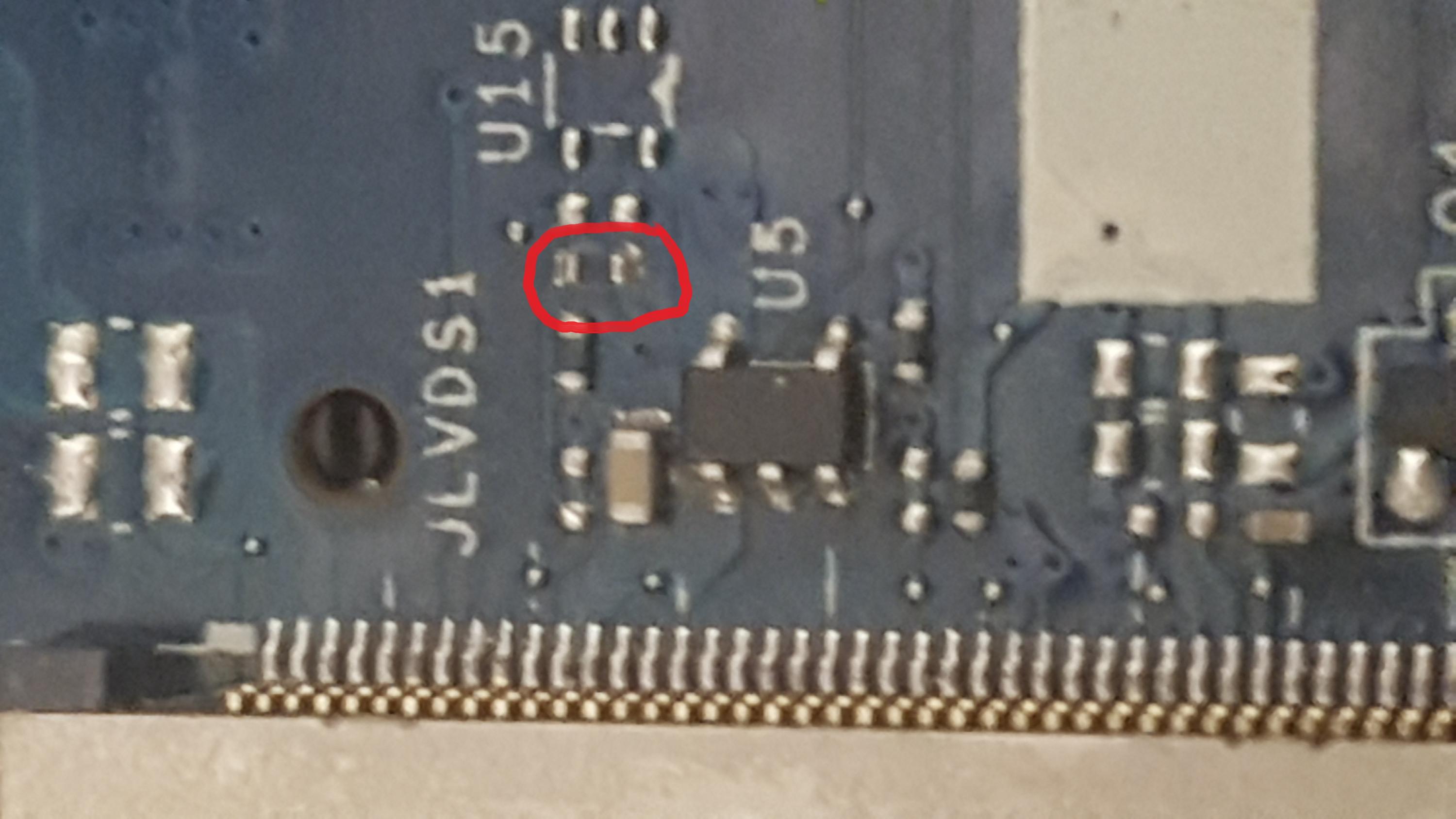

          Goes to the resistor marked in the picture.No voltage either side.
            If you wish to try, remove this resistor. Keep it handy for later.
            Then apply +3v3 to the lcd pin side of this removed resistor.
            This should turn on the display with the logic high signal.
            The resistor must be removed so that the manually applied +3v3 is not challenging the logic low from the other side of this resistor. It will be a conflict to have a logic low mated with a logic high so the resistor must be removed for this test.

              • mon2
                • Dec 2019
                • 14415
                Yes, see attached. Note the '@' prefix on the U15 label - that symbol often denotes that the part is a 'NO STUFF' during the PCB assembly process.
                That is, design engineers will often allow for multiple ways to build the same logic. For this case, the 0 ohm resistor is used to bypass the need for U15.
                After you remove the 0 ohm resistor @ R123, check with a meter in resistance mode that there is nothing loading down R123 pad, pin # 2. Red meter probe on pad # 2 = lcd pin # 8. Black meter probe on ground.
                This will also confirm that resistor @ R124 is not causing this fault. That resistor should be ~100k ohms (according to the schematic).
                This is the same trace that leads to the LCD display. In summary, we want to be 100% sure that nothing on the LCD side of this broken connection is not being loaded down by some other factor.
                After this is confirmed, it is safe to apply the external +3v3 signal onto the removed R123, pad #2 to mimic what the logic board should be doing. Of course something is causing this line to be logic low but for now, it is worth a try.
