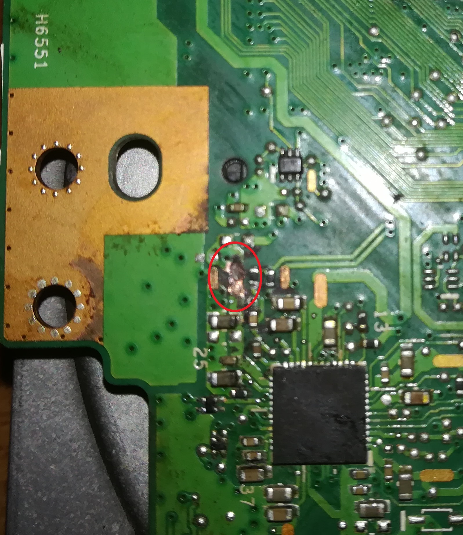

    I'm diagnosing a board from an Asus M509DA notebook. The unit came in not playing audio. System acts like it plays audio, but there is no sound through the speakers or headphones. (Headphone jack autorecognision works).
    At first my thought was it would be softwareproblem, but that is not the case, so opened up the laptop and there was some smudge / fluid damage arround the ALC3251 chip.
    I cleaned everything, and even replaced the chip with a donor chip. But still no audio.
    I measured the traces from the 4 speaker pins up to the chip, everything seems normal.
    I cannot find a datasheet of the chip.
    Any one have an idea what to test next ?

      Re: Asus M509DA no sound - Realtek ALC3251
      Thanks,
      I managed to find and resolve the problem. There was a broken/burned trace on the mainboard.
      As you can see in the picture attached.
      I made a bridge, now the sound is working perfect.
