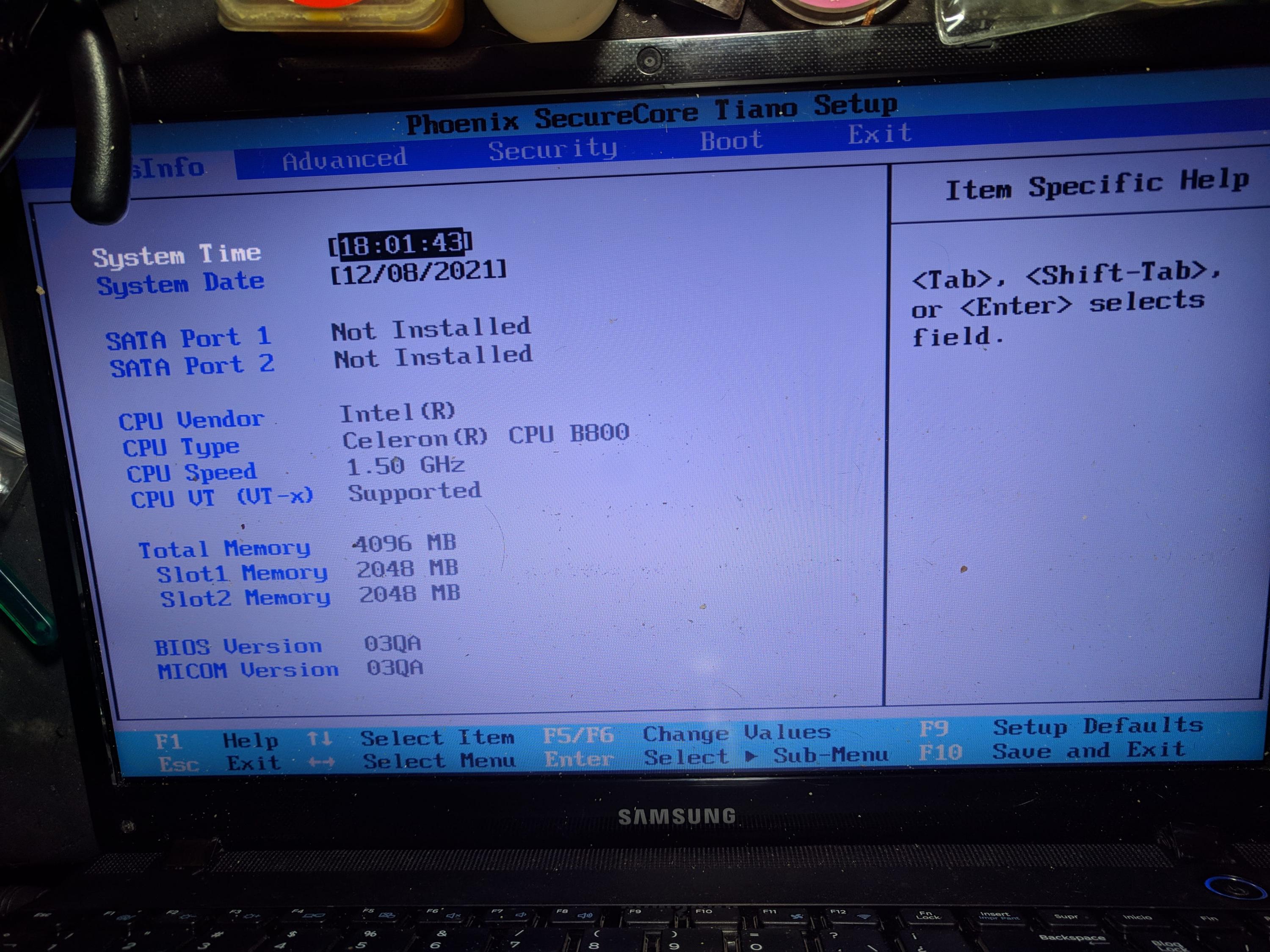

      Laptop turned on, I went to BIOS Setup to enable UEFI to boot, then booted fine to Windows. Restarted 3 or 4 times (without powering off) and no issues. Then I turned it off and without moving anything, turned it back on: black screen, fan at full speed. And now it won't power up again until I leave it there for a few hours. Tried shooting freezing spray at various places but no luck. This is a tough one!!!

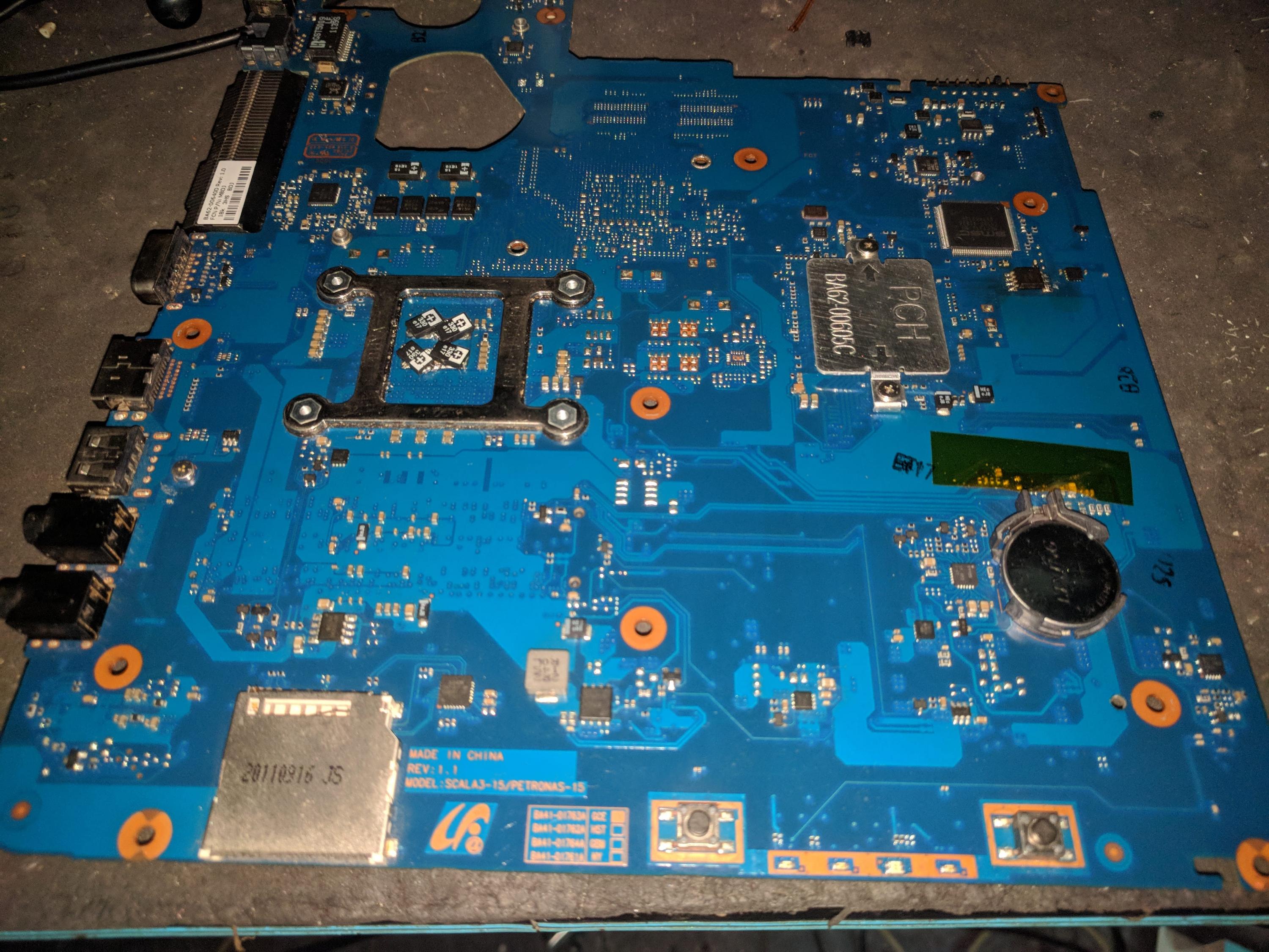

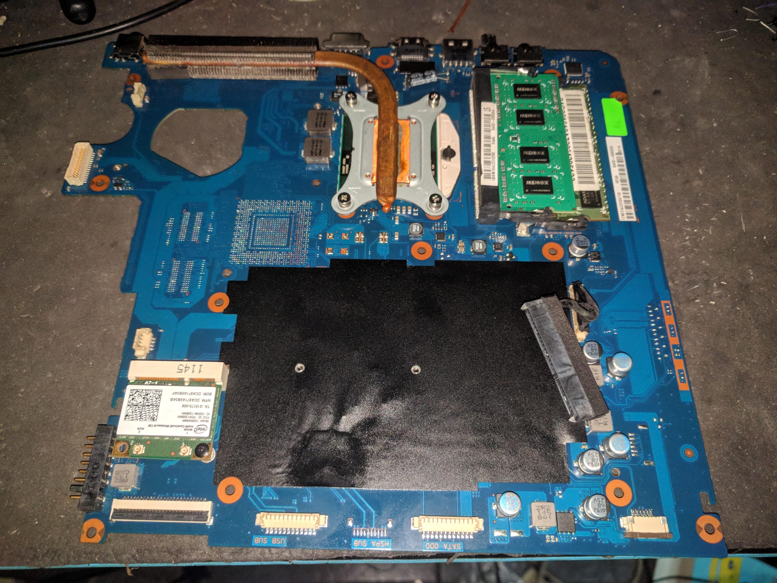

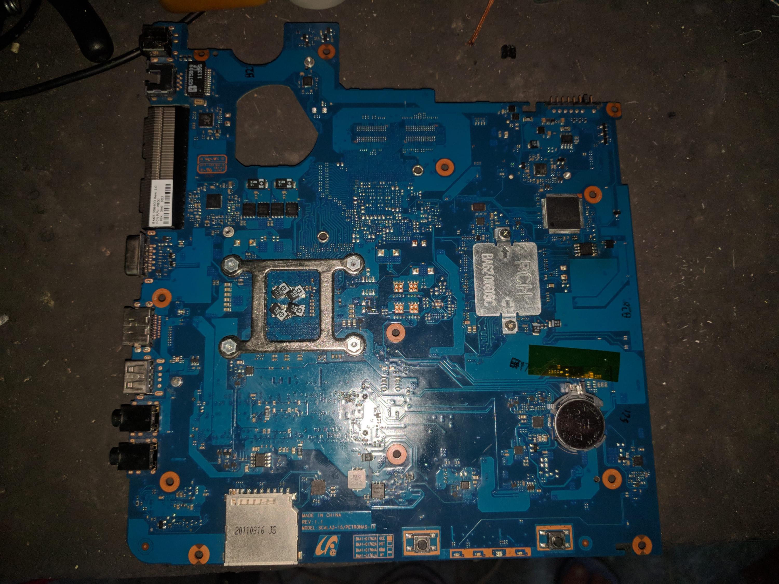

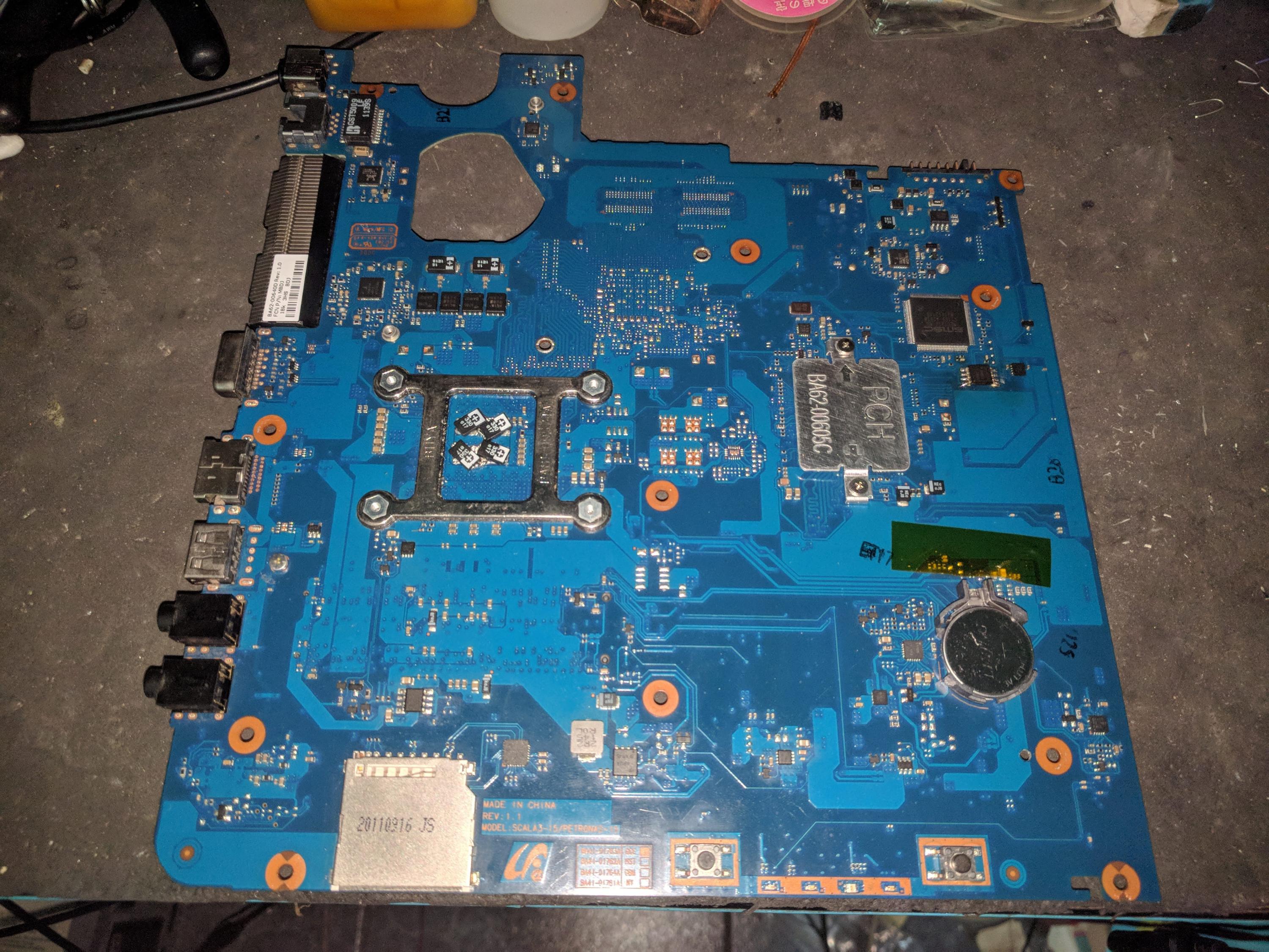

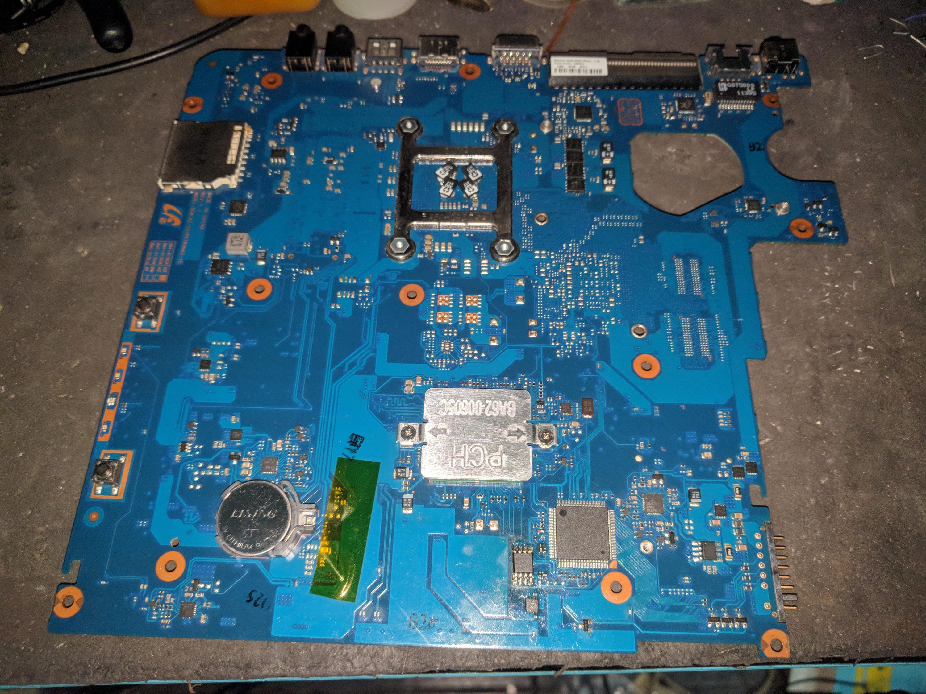

                  This mobo doesn't have a silkscreen, and I don't have the boardview for it. I do have the schematic (attached). Which one would be VCCSA?
                  Attaching pics of the mobo as well.
