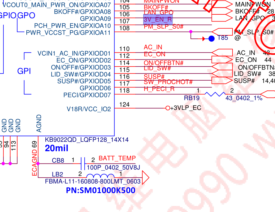

    I have Acer Aspire A517-51 laptop with no power
    Model: N17C3
    Motherboard: C5V01 LA-E892P REV: 1A
    I already make some tests:
    5VAL OK
    NO 3.3VAL
    LDO3 OK
    LDO5 OK
    5V_EN OK
    There is no 3V_EN
    ON/OFFBTN 3.3V OK
    I need your help.
    Thanks in advance.

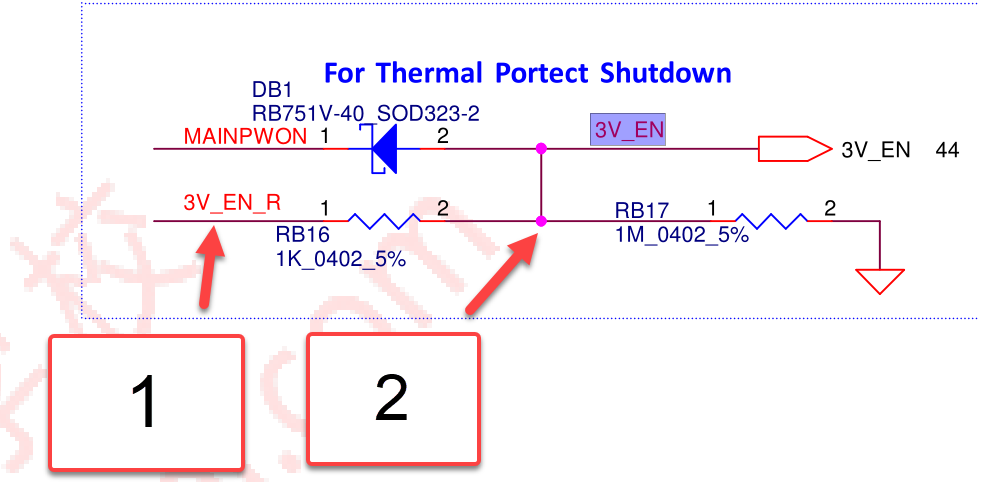

    See attached.
    1) Check and post the voltages for the requested locations.
    2) 3V_EN_R is from the KBC. This part may need to be reflashed. But first confirm that the KBC pin is mating with the 3V_EN circuit. Perform a resistance or continuity test between the KBC pin (3V_EN_R) and the resistor (1k) @ RB16, pin #1. What is the resistance ?
    3) What is the voltage level for 5V_EN ? Expecting that 3V_EN should be similar in voltage to ENABLE the missing +3VALWP rail.

      MAINPWON present on DB1??

        Good mooring .
        It works, the problem was is the keyboard while the power button is embedded in.
        When i insert the keyboard the ON/OFFBTN# signal drops from 3.3 to 2.5 v (probably liquid damage)
        the requested voltages are:
        MAINPWON : 3.3v
        3V_EN_R, 3V_EN: 0.0v
        RB16: 0.980k
        after run power this voltage all goes to 3.3v
        but no 3VALW before run power only 5VALW.
        Can you guys give me some explanation?
        Thanks.
