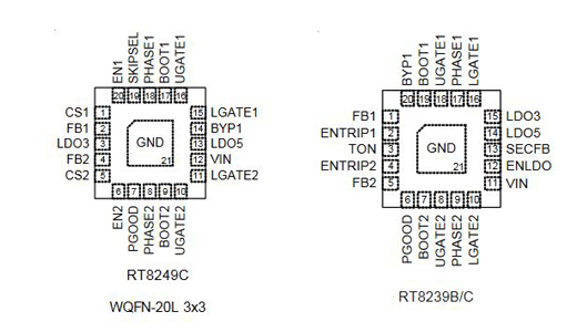

    asus x541na replace RT8249CG with RT8239CG
    can i replace RT8249CG with RT8239CG?I cannot find exact chip on hand i have RT8239CG
    Last edited by SMDFlea; 11-30-2021, 08:57 AM. Reason: replace RT8249CG with RT8239CG
    • 21936
    Re: asus x541na
    If the datasheets aren`t available search for schematics or boardviews with both these parts and compare the pinouts .
    Edit: RT8239 A/B/C Datasheet https://cdn.badcaps-static.com/pdfs/...0d69c5b6f3.pdf
    RT8249A/B/C Datasheet https://cdn.badcaps-static.com/pdfs/...d7b1efab2b.pdf

      Re: asus x541na replace RT8249CG with RT8239CG
      there are not the same?
        • 21936
        No
