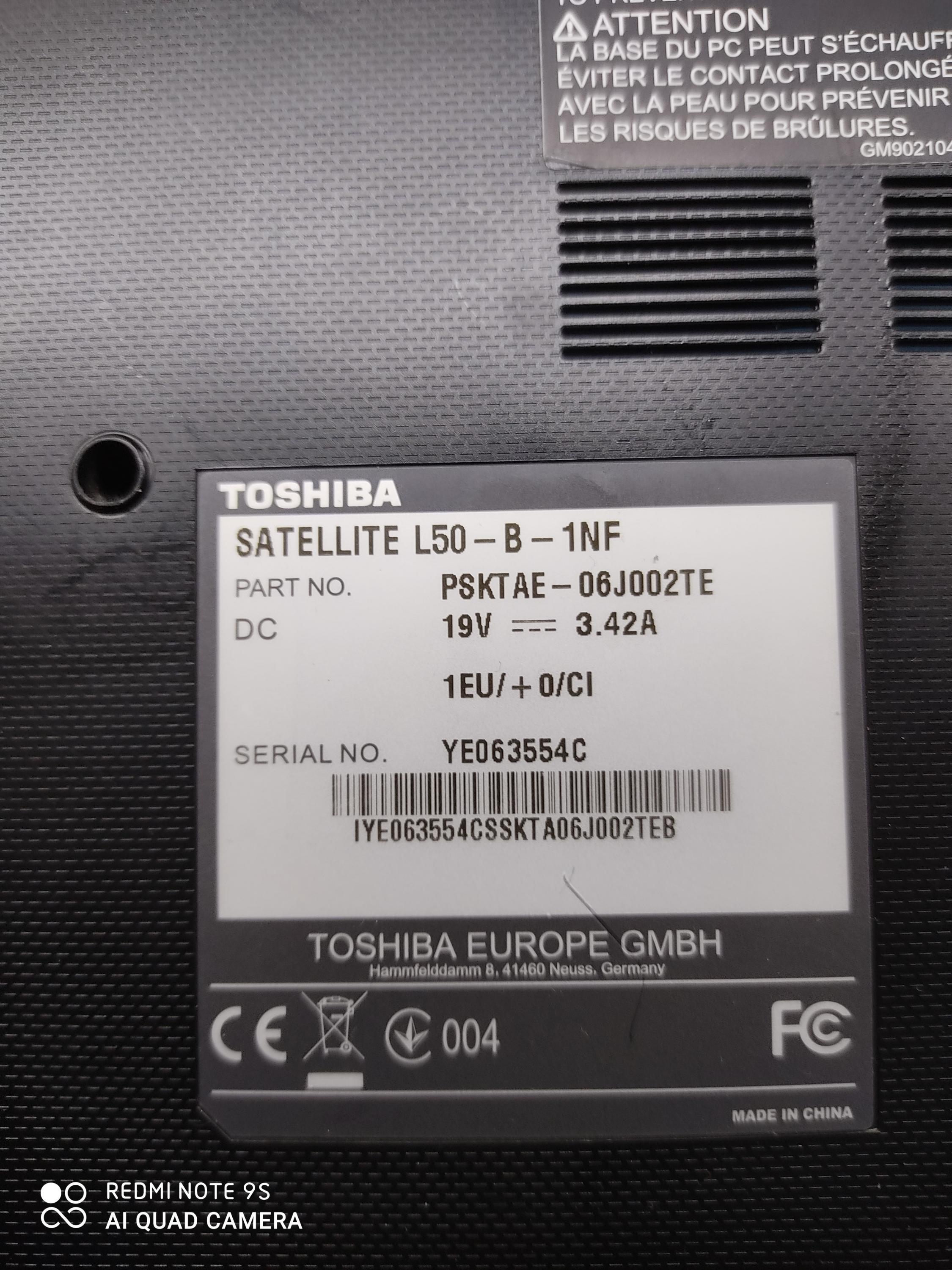

    TOSHIBA L50-B-1NF

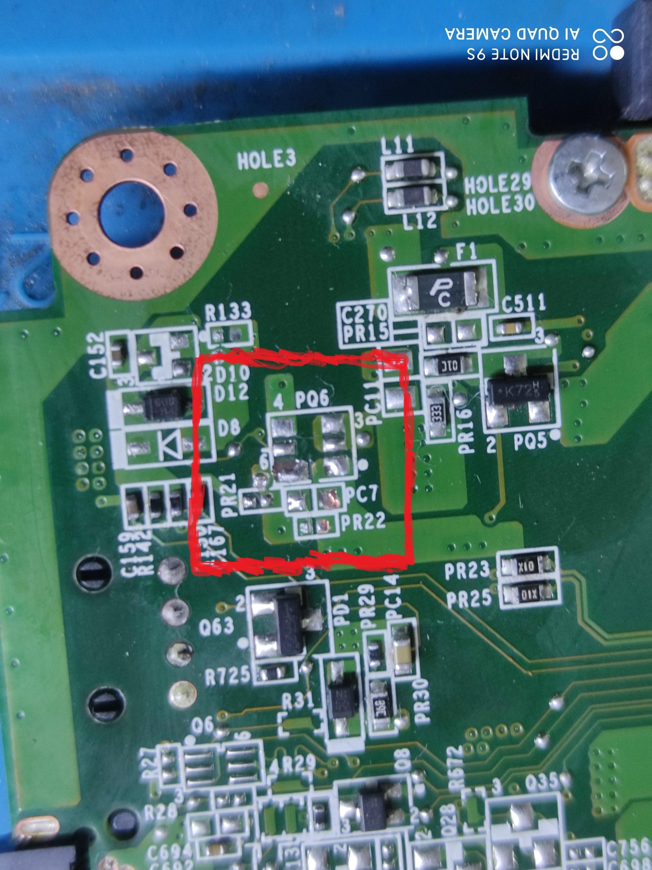

    There is liquid contact with the motherboard
    1.pq6
    2.pr21
    3.pr22
    4.pc7
    I can't find the schematic, what are the parts to replace?

    Re: toshiba satalite l50 missing parts
    are you sure it had an ic chip there ?

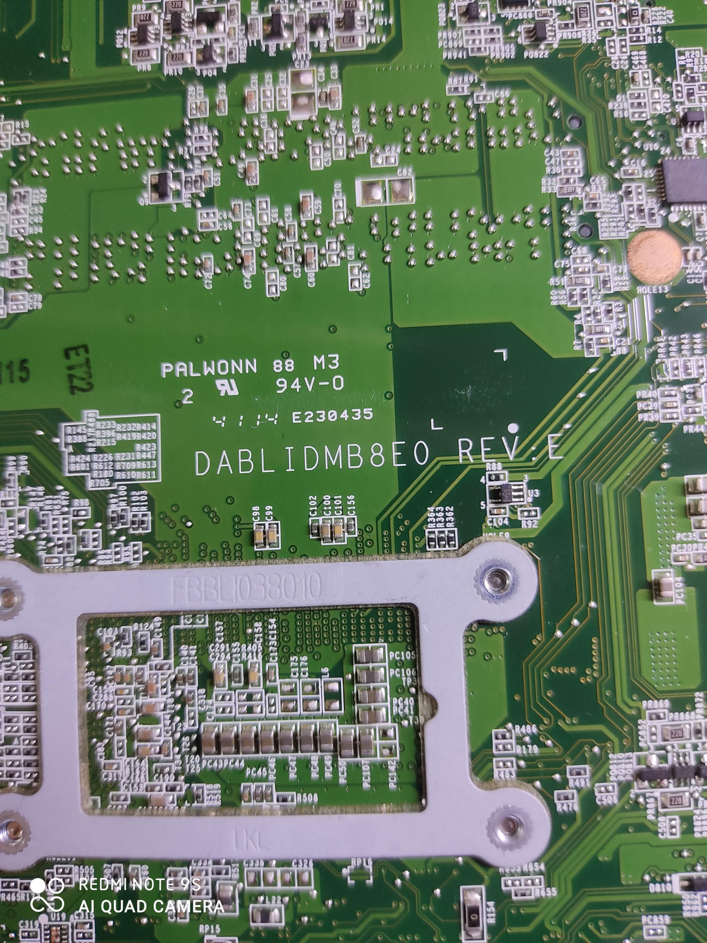

      Hi. Your PCB picture & markings helped.
      The schematic for the logic board is on this forum and is attached.

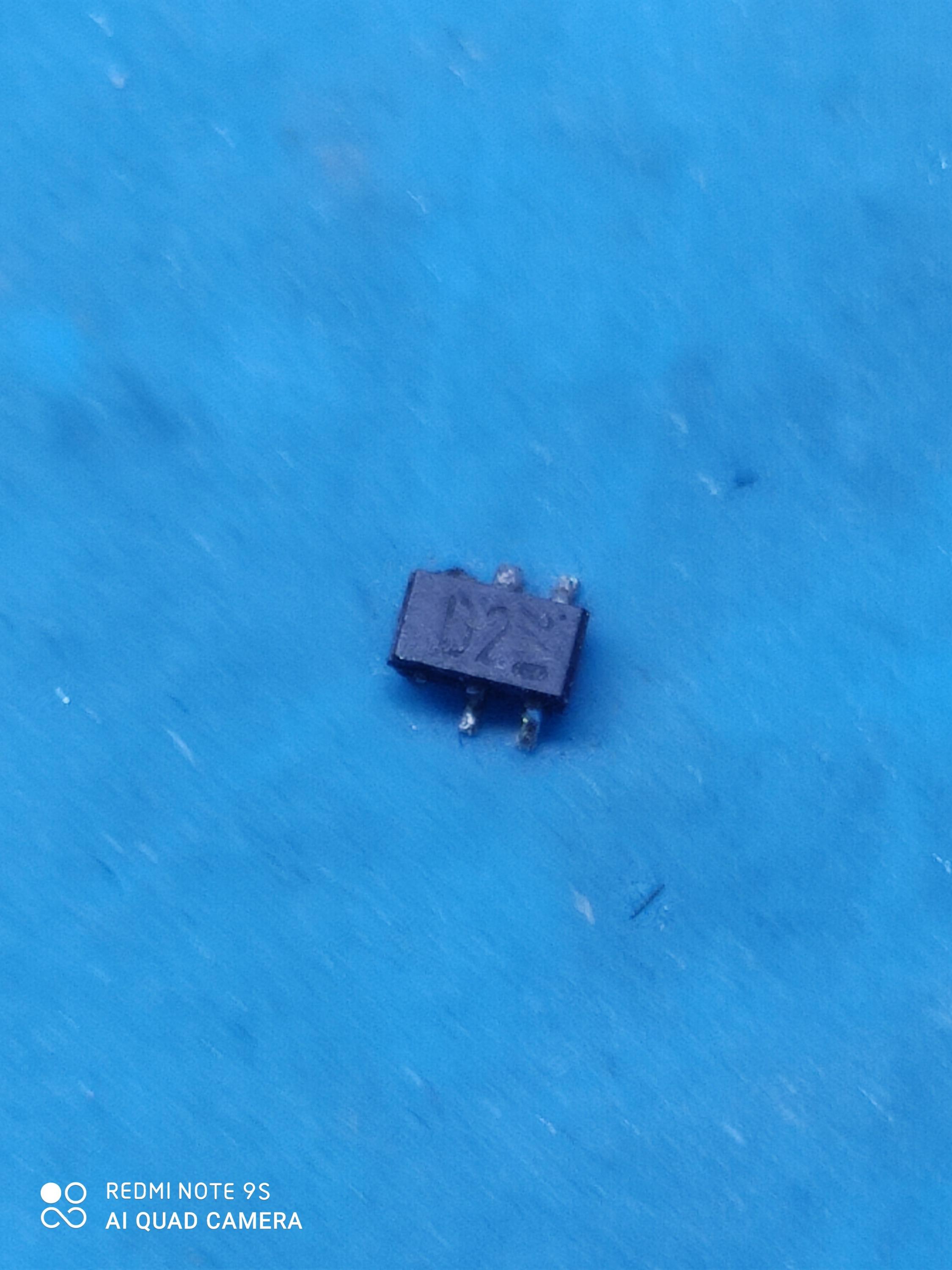

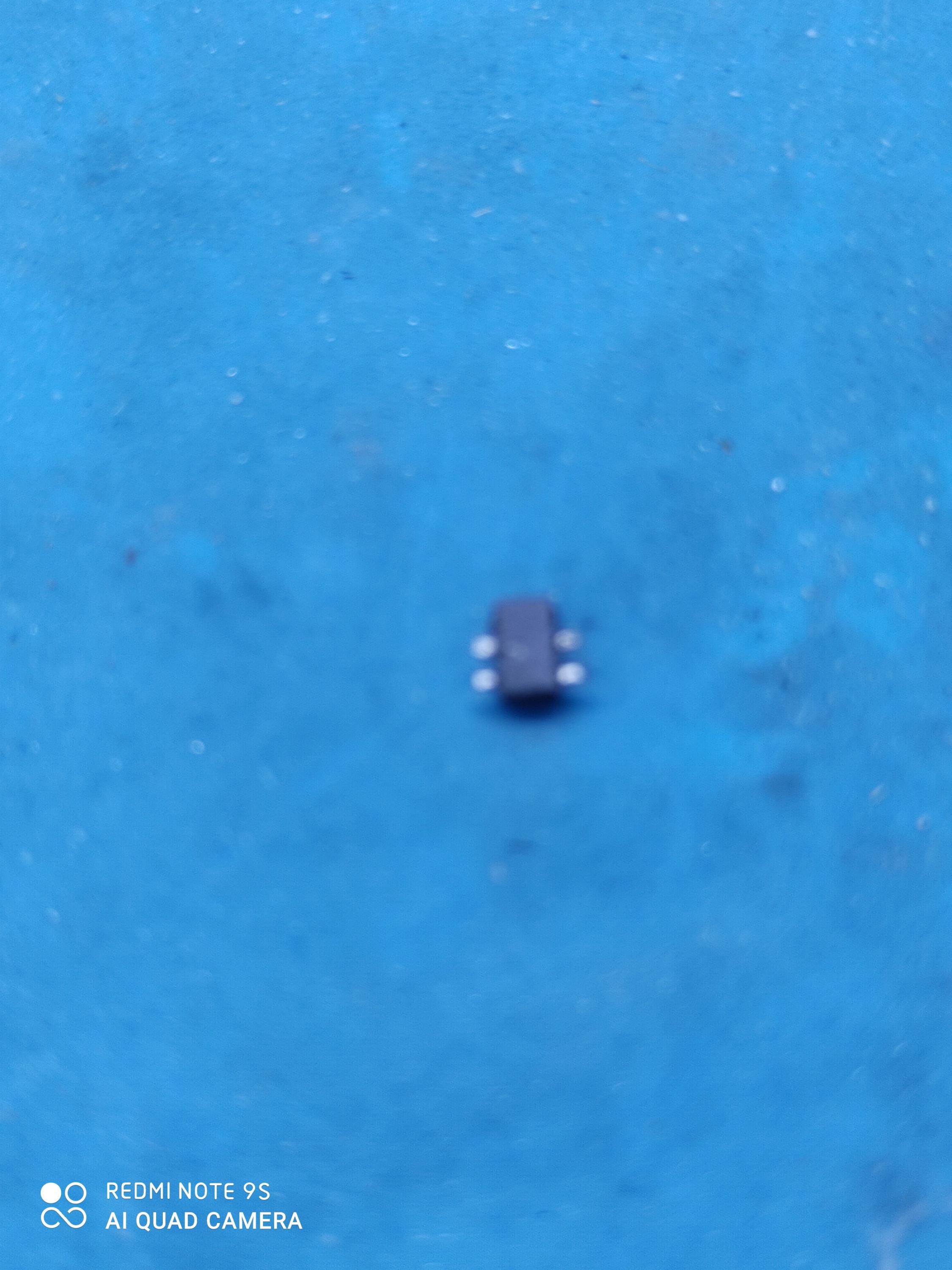

        6PİNS smd code d2
          problem solved
          1.pq6-IMD2AT108 dual channel npn and pnp dual mosfet:
          2.pr21-100k
          3.pr22-1m
            Were these parts and values not inside the posted schematic?
            • asliyucegsm
              • Jun 2011
              • 340
              • Turkiye
              no dude it was installed from an old motherboard
