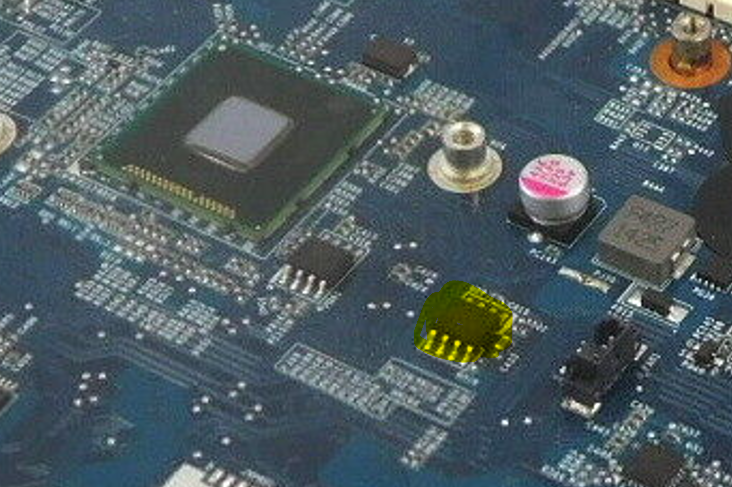

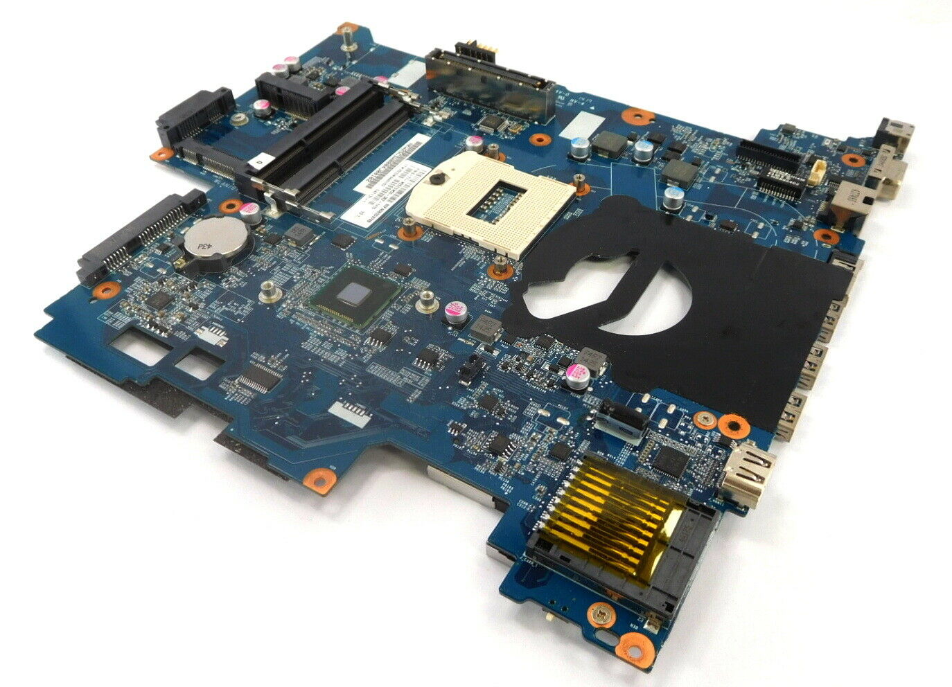

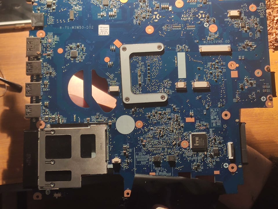

    Hi all members, I'm Antonio and I write my first post from Italy. I will explain my problem: I have a notebbok TERRA MOBILE 1541H with cpu i7 4712mq with motherboard Clevo 6-71-W2W50-D02 which, when switched on,black screen. has start LED on, working CD-DVD, hard disk that can be heard spinning, fan stopped and CPU which naturally heats up. So what's the problem? Corrupted bios or burnt motherboard?

    Open the Laptop, visual inspection, Voltage at all coils present? If yes, I'd indeed start with BIOS Firmware.

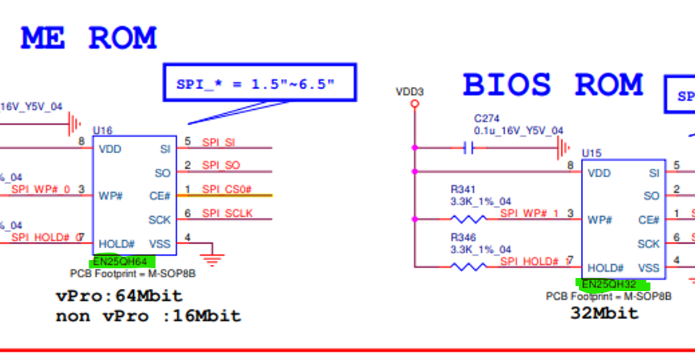

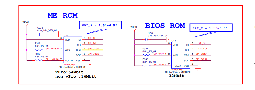

        Re: Notebook TERRA MOBILE 1541H

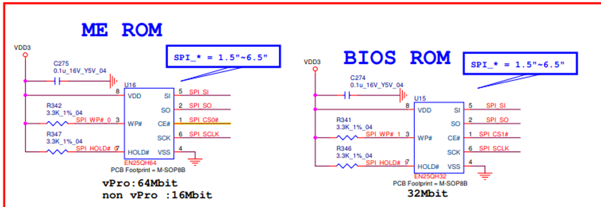

        I don't know if it may be useful, but i attach the service manual of a similar models.

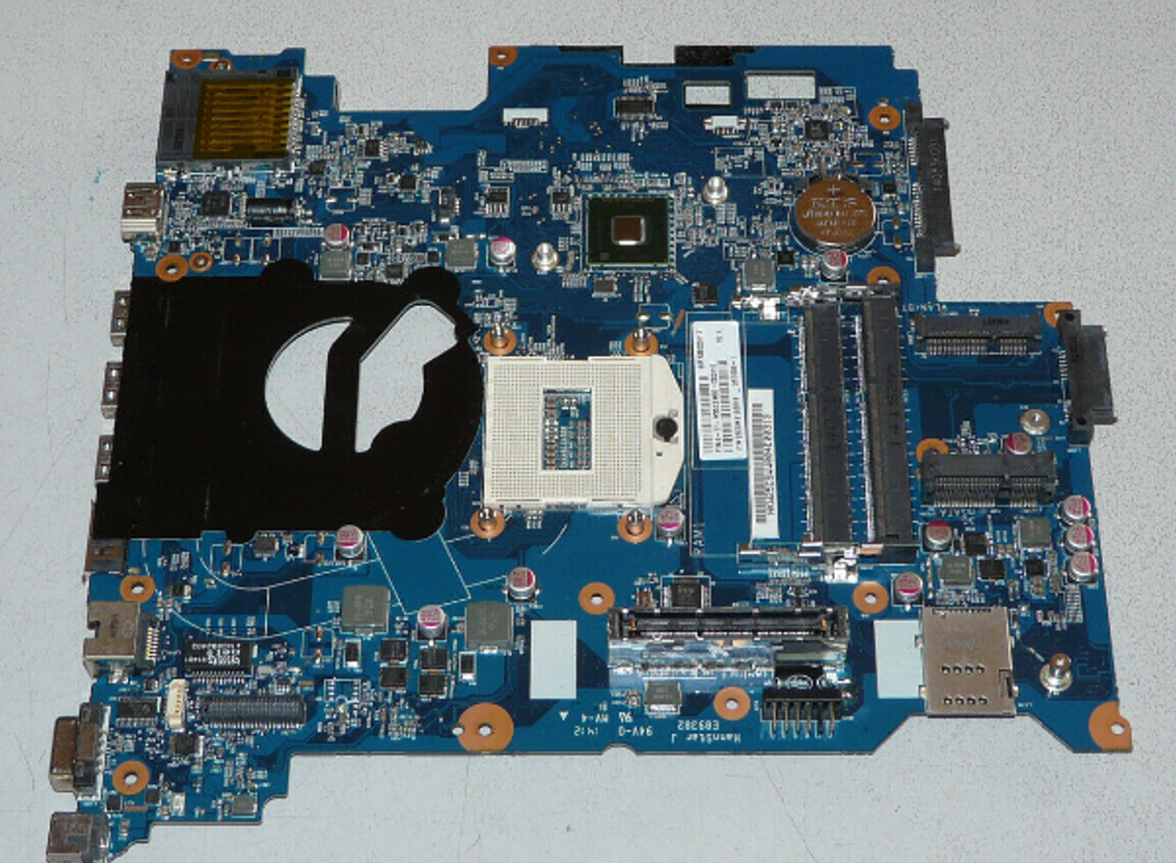

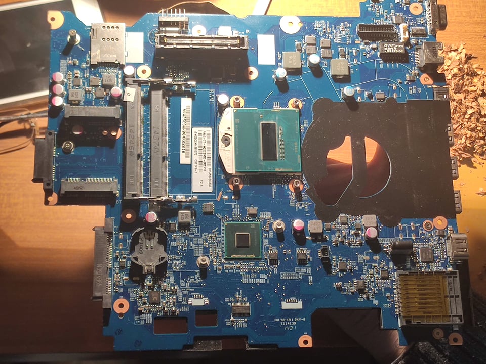

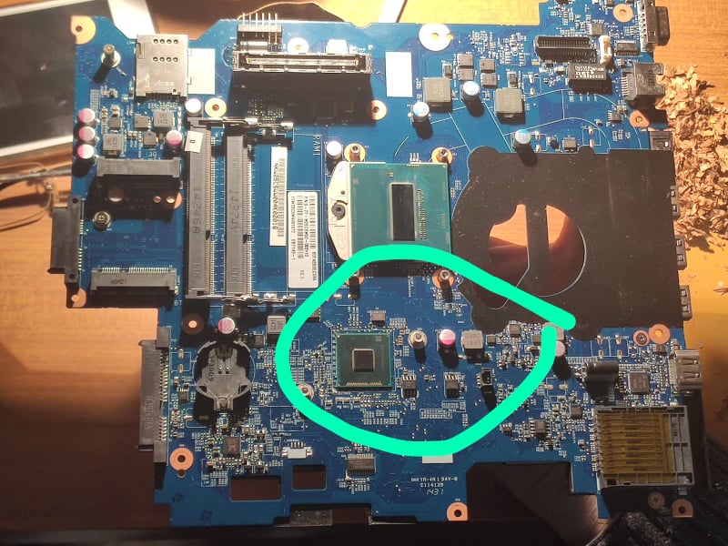

          This is photo motherboard . On the two chips near the PCH there are just a few numbers and that's it.
            check these two chips, there should be the name of them on the pcb.
            If they correspond to U15 and U16 then they are Main bios and EC.
            Even if the name doesn't mach the schematics, try to check with a microscope or a magnifier the code over the top so you can identify what is it.

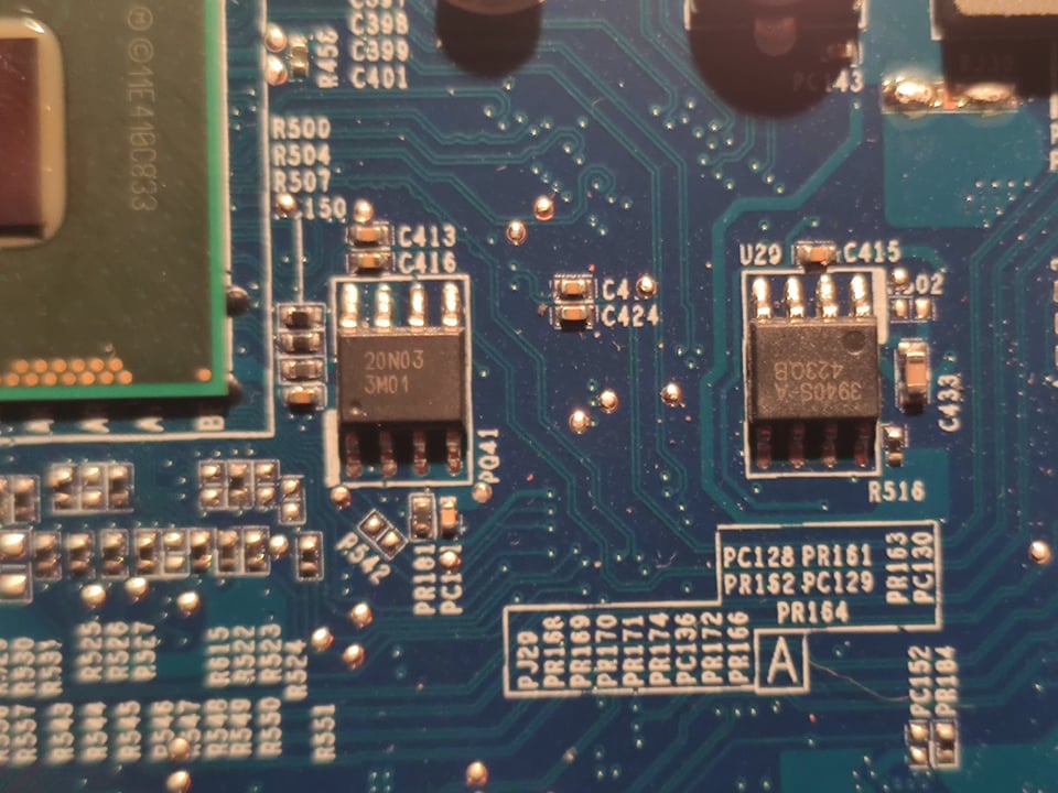

              The abbreviation on the one highlighted is 2940S - A
              423QB
              the other has the initials 20N03
              3M01
                https://www.alldatasheet.com/datashe.../EN25QH64.html
                https://www.alldatasheet.com/datashe.../EN25QH32.html
                  • 20643
                  423QB
                  3M01
                  Those aren`t U15 and U16 ,the 20N03 is a mosfet.Look for U15 and U16 in white silkscreen
                    I found these on the EN25QH32 manual
                    EN25QH64

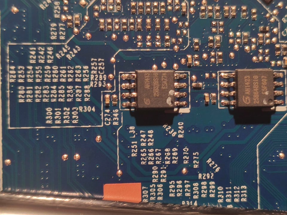

                      only these two are 8-pin

                          • 20643
                          423QB
                          3M01

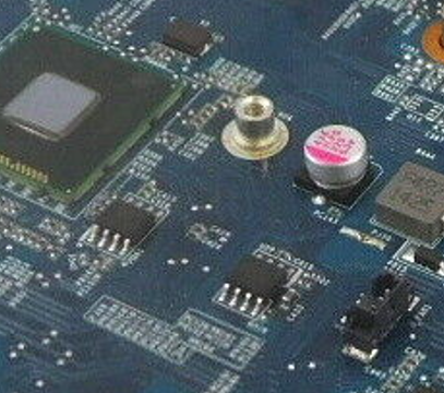

                          Post good clear readable pictures of both chips ,and the silkscrren around them

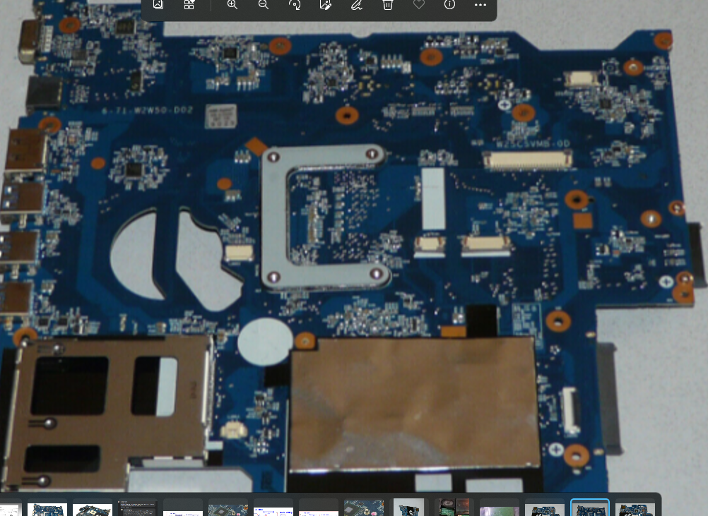

                            Here are the pictures you asked for
                              • 20643
                              pictures of the chips on the motherboard

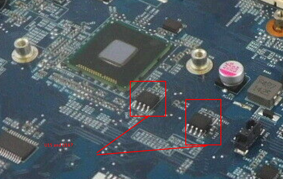

                                This is pictures of the chips on the motherboard
                                  With the phone they do not come well, this is the same as the card that is in my possession
                                    I think these are better
                                      These in the photo are the only 8-pin chips that could contain the bios
                                        • 20643
                                        The third picture,those are the bios chips.Gigadevice 25B32 and 25B64
