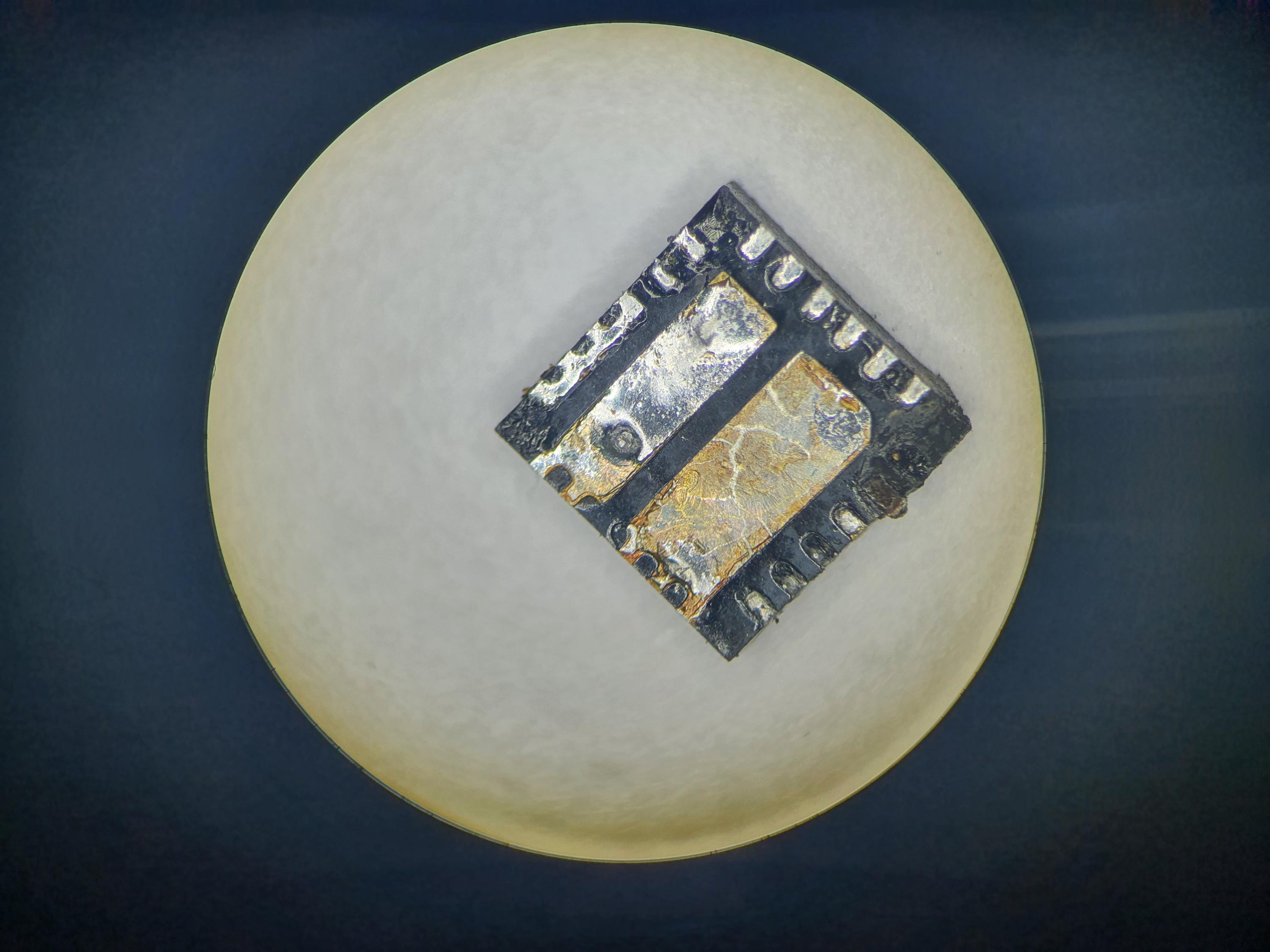

    Hi guys
    Need help with some ic chip on HP Pavilion 16 Quanta G3JB
    Maybe anyone know where i can find datasheet for this IC?
    Socket QFN23 3x3

    Could this be a 5x5mm ?
    Post the backside view of this part.

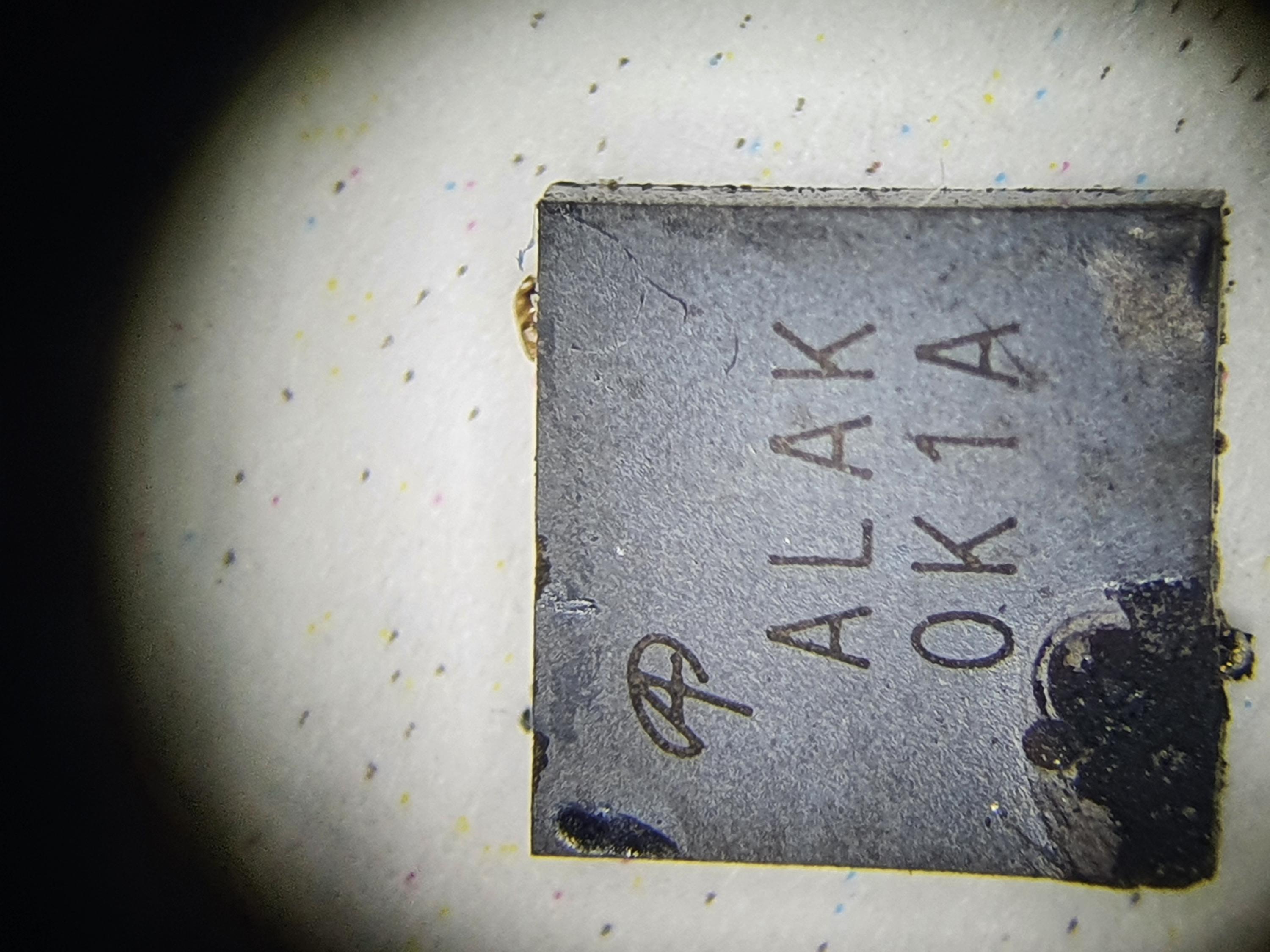

      Re: HP Pavilion 16 Quanta G3JB,Need help with IC name
      Its 3x3

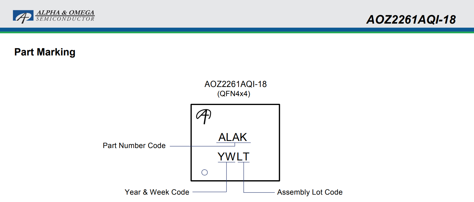

        • 21874
        Originally posted by psyjamm
        Its 3x3
        AOZ2261AQI-18
        https://cdn.badcaps-static.com/pdfs/...c49dd58c56.pdf
            @psyjamm, have you reviewed the datasheet posted by @SMDFlea??
            That is your burnt part. He wins the washer & dryer prize for finding this needle in the haystack.
            Ignore the bottom line of the part marking = manufacturer's datecode.
              Thanks @SMDFlea for the alert and webpage link correction.
              In searching out this series, found this interesting press release:
              https://www.globenewswire.com/news-r...onverters.html
              So as far as I can tell, the suffix -18 is linked to the recovery mode of the device in the case of a short circuit event.
              Noting this press release, there are larger current version of the same footprint available in the market. Better yet, the larger current devices have the -18 suffix.
              So with a very safe bet, you should be fine to consider to replace the ALAK device with the ANAK device which is in stock @ Digikey here:
              https://www.digikey.ca/en/products/d...QI-18/10258086
              This puppy can support upto 10A (ANAK) current vs. 8A current (ALAK).
