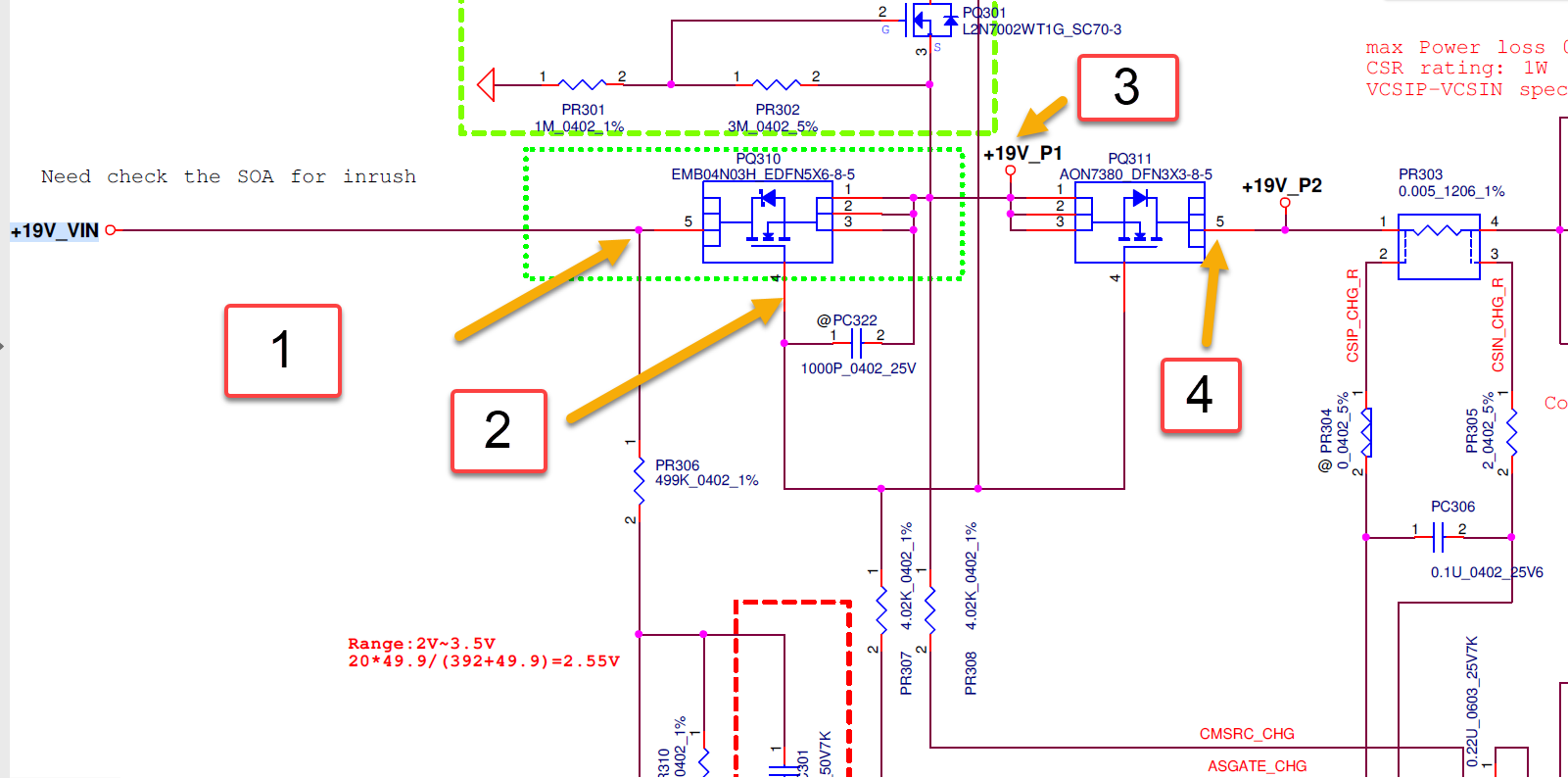

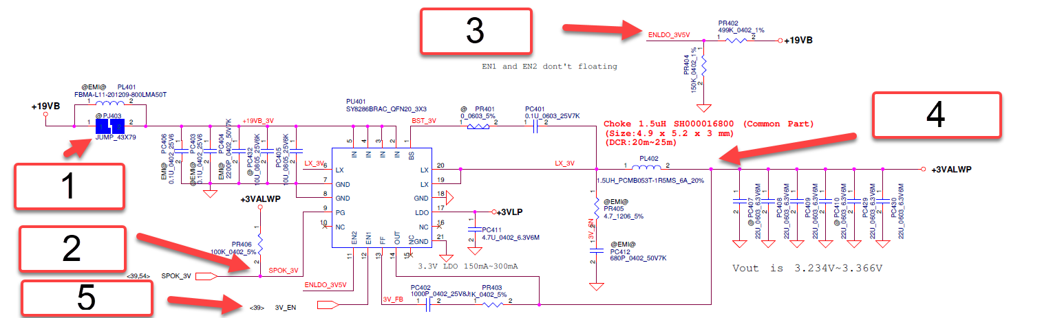

    Do not just inject voltages onto the logic board. Not at first till more is known on the operation of the power rails.
    See attached.
    Meter in DC voltage mode (any setting 20V or higher is ok).
    Red meter lead on each point of the attached schematic. Black lead to ground.
    Check and post the voltage reading for each requested mosfet location.

        With no battery, pin 4 (gate) of each mosfet is at 20v when adapter is attached?
        • ca3cooh
          • Sep 2018
          • 17
          • Indonesia
          Re: Acer nitro 515 no power, missing 3ALW
          yes, both gates were 20v

            Ok. Remove all power. meter in resistance mode (200 ohms is ok).
            Check and post the resistance readings for the following mosfets.
            1) resistance between Drain (pin 5-6-7-8) & Source (pin 1-2-3) of PQ310 ?
            2) resistance between Drain (pin 5-6-7-8) & Gate (pin 4) of PQ310 ?
            3) resistance between Gate (pin 4) and Source (pin 1-2-3) of PQ310 ?
            Then repeat the same testing for PQ311:
            4) resistance between Drain (pin 5-6-7-8) & Source (pin 1-2-3) of PQ311 ?
            5) resistance between Drain (pin 5-6-7-8) & Gate (pin 4) of PQ311 ?
            6) resistance between Gate (pin 4) and Source (pin 1-2-3) of PQ311 ?

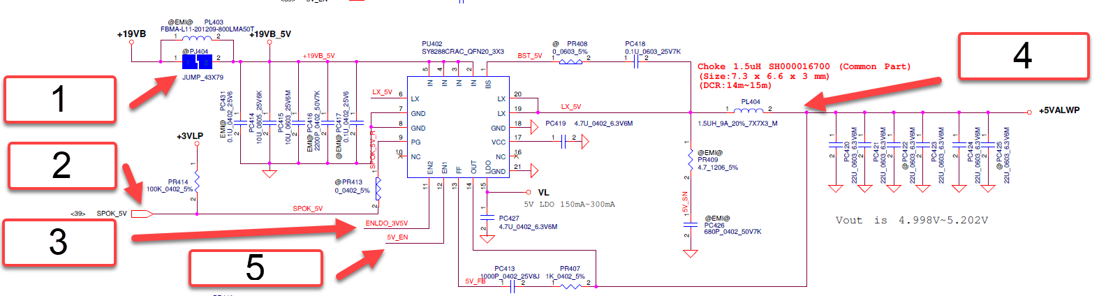

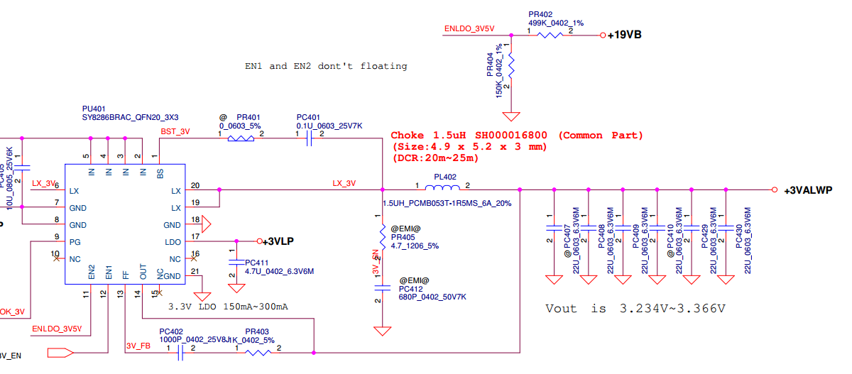

                Next, check if the ALWP rails are being enabled by the logic board.
                1) Confirm the voltage readings as per attached diagram for the +3VALWP rail.
                2) Then check the same for the +5VALWP rail.
                3) Remove all power. Meter in resistance mode. 200 ohm setting is ok.
                a) check and post the resistance to ground of inductor (coil) PL402, pin #2. Checking if there is an excessive load = very low resistance on the rail that will cause the switching regulator to shut off.
                b) check and post the resistance to ground of inductor (coil) PL404, pin #2.

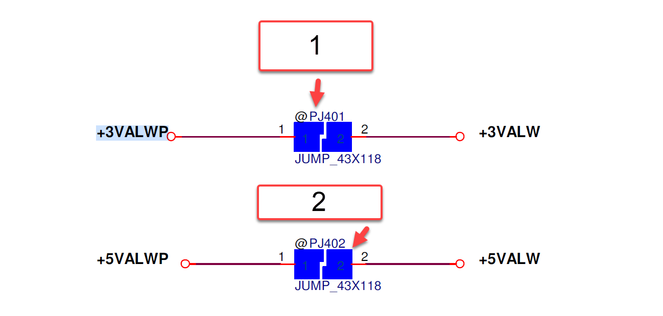

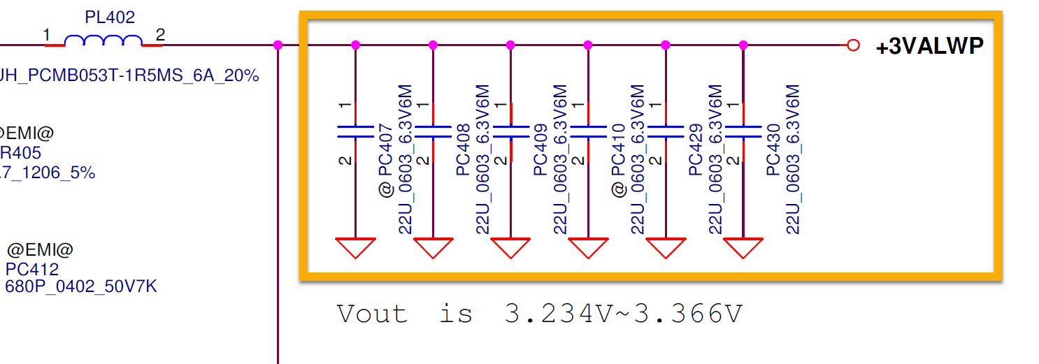

                  1) Remove PL402 as you are doing already. The short could very well be in the noted area as per attached diagram.
                  Review the attached. Then proceed to hot air remove each cap (22uf). This is only a random guess but can start here if there was no liquid spill, etc.
                  If you remove the caps - just leave them off the board for now and keep track of them. They are not polarized so can go back in any direction.
                  2) For starters, remove these caps and then check the resistance to ground of PL402, pin #2 again.
                  update - the logic board offers solder blobs as shorts Good thing and we can use it to isolate the shorting part.
                  See attached.
                  3) Remove the solder block @ '1' location and then check the resistance to ground again. Is the short still there ?
                  For now - do not remove the solder block @ '2' of the attached schematic.

                      ok - place those caps back onto the board.
                      Each '+3VALW' label appears to be followed with more solder blobs.
                      Consider to locate each solder blob and remove it. Then after each solder blob removal, check the resistance again. If the short is still present, solder the blob back onto the board.
                      Do not power up till we locate the reason for the short.
                      Can you confirm your meter setting? Are you in the lowest resistance setting of your meter (200 ohms is ok) ?
                      With 0.00 ohms, that is a direct short to ground.
                      Be sure that your meter (red probe) is on the voltage rail being tested & black to a good ground. No power to the logic board with the resistance checks.
                      Q: When you removed the solder blob PJ401 - the +3VALWP rail was no longer shorted ? So PL402, pin #2 was showing a high resistance to ground ? Please confirm this detail.
                      Consider to remove the solder blob PJ7108 and check the resistance again.
