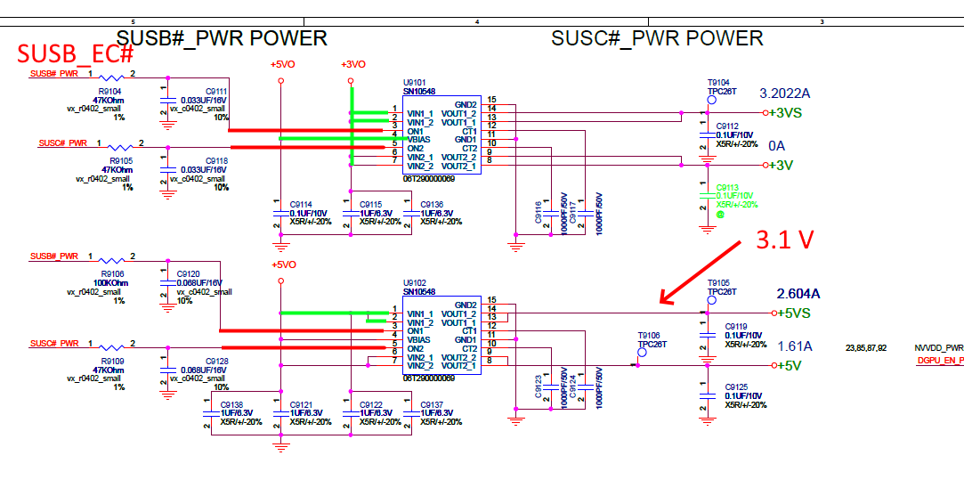

    Asus GL705GE motherboard FX505GD
    Asus GL705BE same GL505BE
    Battery led always on
    No 3VS 3V 5VS 5V
    3VS and 3V POWER S. missing (both) ON signal <- PM_SUSB# = 0V Vin OK
    On 5VS and 5V POWER S. missing both on signal Vin OK (5V) but (5VS)Vout is 3.2V ???

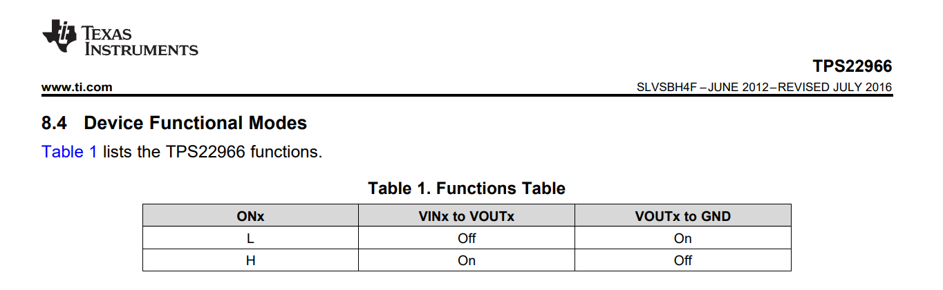

    Believe the attached datasheet is common to the referenced SN10548 device.
    Respectively, if ON1 / ON2 pins are logic low then the Vin should not be passing through to Vout.

        Re: Asus GL705GE motherboard FX505GD
        No short
        I'm focused on the 3.3 V on the +5VS out, I'have removed both power switch and this voltage is still present
        If I remove the led board this voltage drops around 0.03 V ??
        But if I connect 3VS power switch both 3V and 5V alw (EN1 and EN2 are 3.2v) disappears , strange behaviour

          U9101 and U9102 are the same part,swap them around to check if theres a problem with U9101
