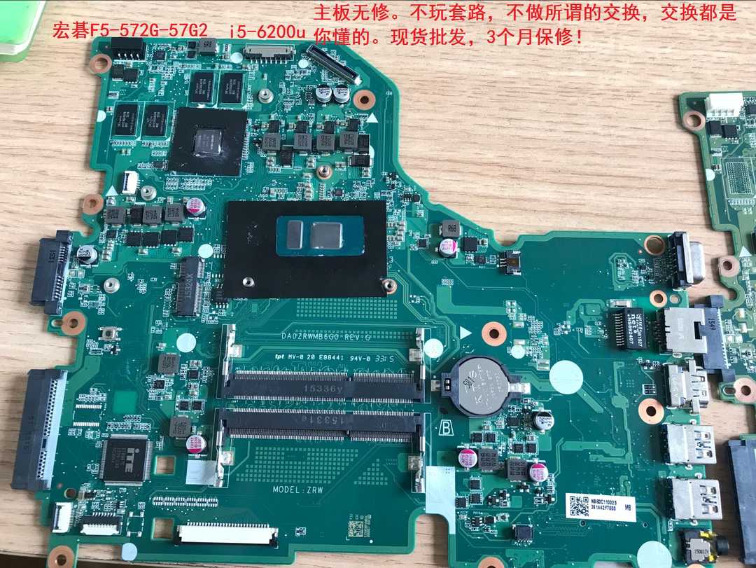

    hi to all I have this main acer with problem,
    at the beginning it turned on the blue led, fan turned but gave black screen, written the bios did not solve, it always gave black screen, I performed reballing now the pc goes to charge with orange led, but it does not turn on the fan does not turn, if but I press fn + esc the blue led flashes but nothing happens, I have performed some measurements
    5 / 3v ok
    when I press the power button I find
    + 1V_S5
    RSMRST # 3.3v
    ACPRESENT 3.3v
    S5_ON 3.3v
    cpu res 10 Ohm
    any help is appreciated thanks

    Re: Acer e5-574 no power on DA0ZRWMB6G0
    Follow the power sequence on page 44 and 45 ,RSMRST# -> ACPRESENT -> DNBSWON#
