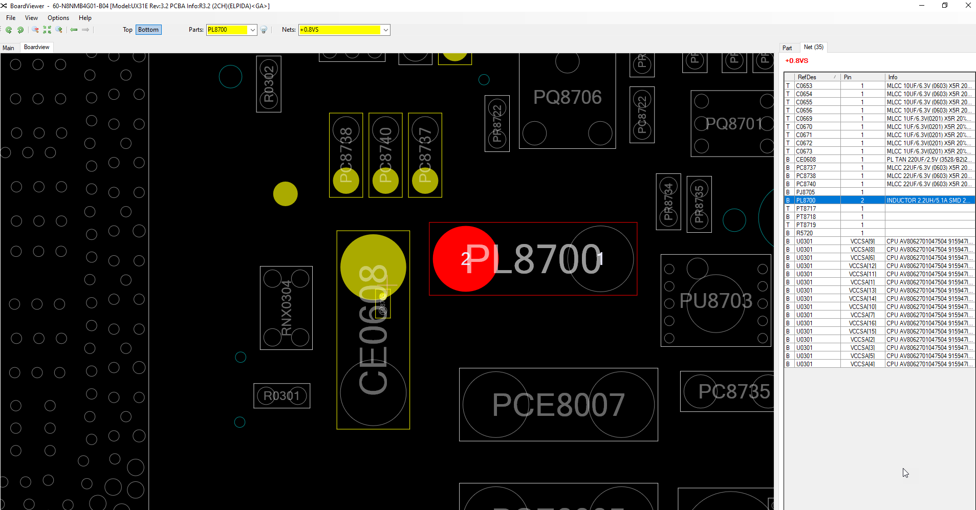

        Q1: What is the board # for your UX31E logic board ? Found the boardview files for the UX31E. Do you have these ?
        Q2: What is the voltage reading @ PL8700? Do you see the +0v8 rail ?

          A: 0.9V on PL8700
