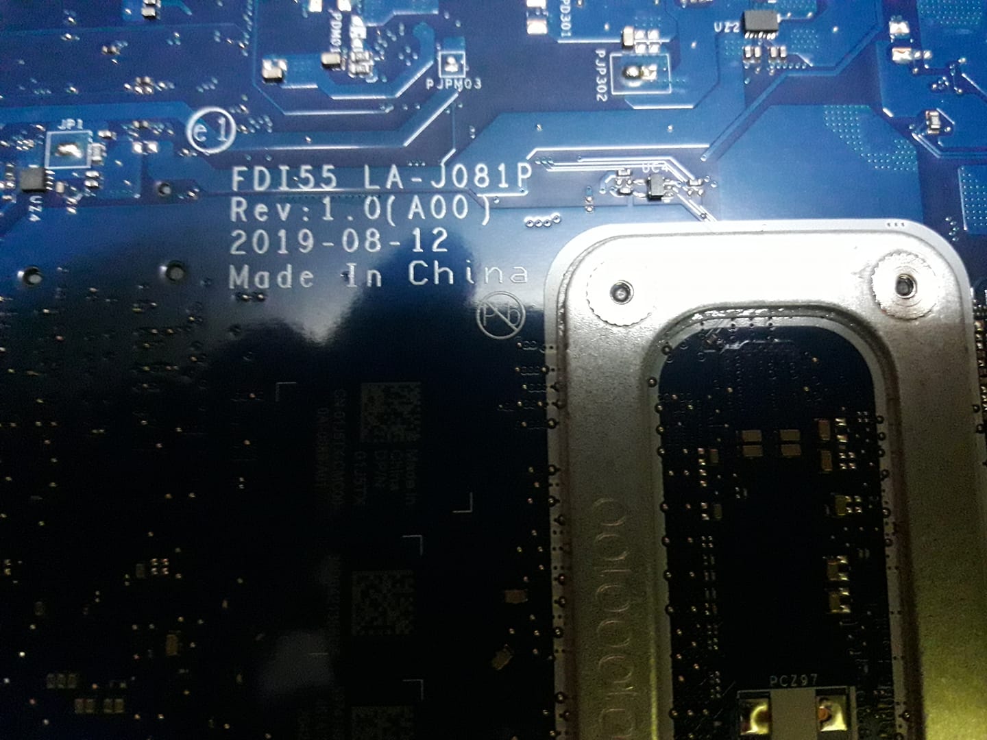

    I was reading the bios dump from this board that was working to write to another dead machine but this one didn't power any more...no charge...only blinks dim amber light once when i connect charger or press power buttton. Any solution? The board is dell inspiron 3593

    That's Bad. Most likely Something went wrong while or after backing Up the dump.
    It seems Schematics are Not (easy) available. You've Changed nothing Else? 19V present stable at the Current Sense resistor? 3V/5V Controller working properly?

      Current Sense resistor working correctly i changed nothing... no resistor with shot. I changed nothing. Thank you

        This isn't really helpful at all. I Had asked for 19V/5V/3.3V and you give me Just nothing...

          Could the peripheral elements have slipped while removing the bios chip? try refreshing the bios file.
