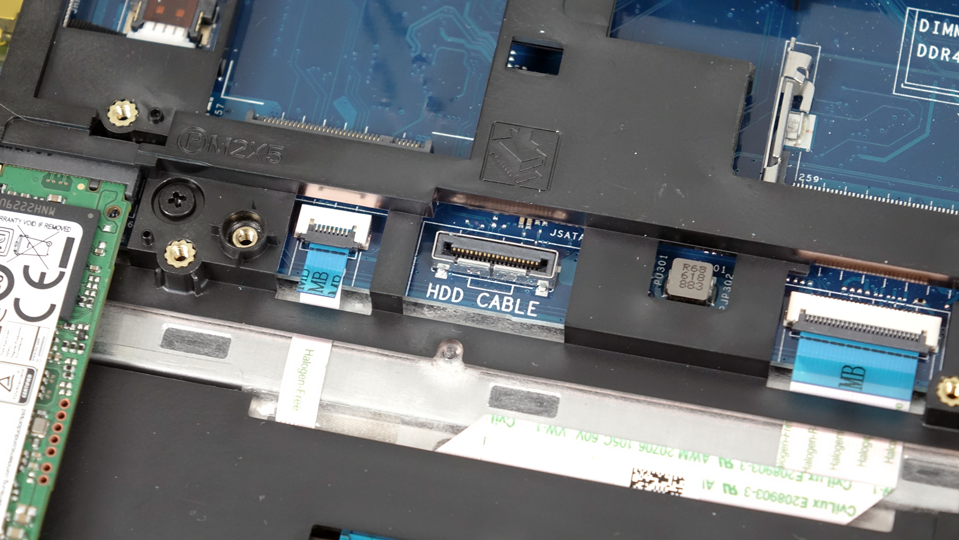

    Dell Precision 7510 Intel I7 Motherboard La-c541p.
    anybody knows the part number of this jsata connector ?
    where can i find it? what is the name of this type of connector ?
    thanks in advance

    Are you trying to replace it ?

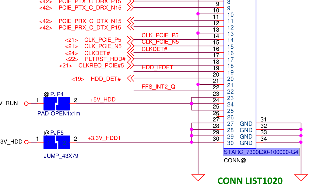

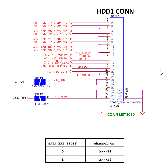

    Schematics show as STARC_7300L30-100000-G4

      Re: Dell Precision 7510 jsata connector
      yes and searching at google shows no results about p/n of the part

          I'm not looking for the cable , I'm looking for the female connector that is soldered on the pcb .

            This part is not for sale at Dell, therefore doesn't have a PN. It's a Dell specific part, so you can source it from the donor board only.
              yes i know that but dell doesn't produce connectors so i was wondering if anybody knew from where to source them .
              I've seen them in other motherboards also but i cant find them in any of the suppliers .
              that's my problem .
