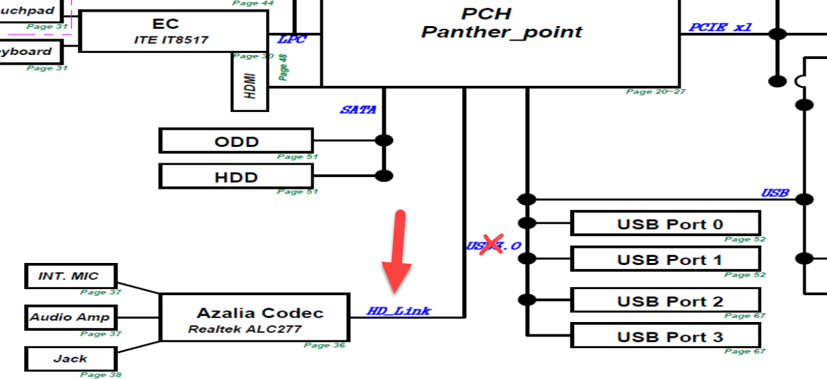

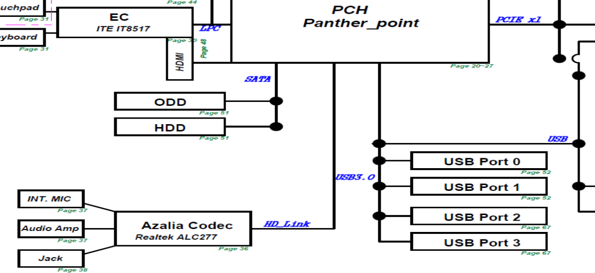

    hi. have limited information on this logic board but can see that the Realtek audio controller is based on USB 3.0 / 2.0 interface.
    1) Can you confirm that you see this Realtek ALC277 in your device manager? If you do not, there could be an issue with the USB interface leading to this controller or the ALC277 itself.
    2) Can you take some clear pix of the area where the ALC277 is located? Have a boardview file but with no details on their part numbers or references.

      Re: Asus K55a no sound
      Audio data between PCH and audio codec IC goes through Intel HD Audio bus, not USB.
        Too close text to the diagram. Thought it was USB 3.0

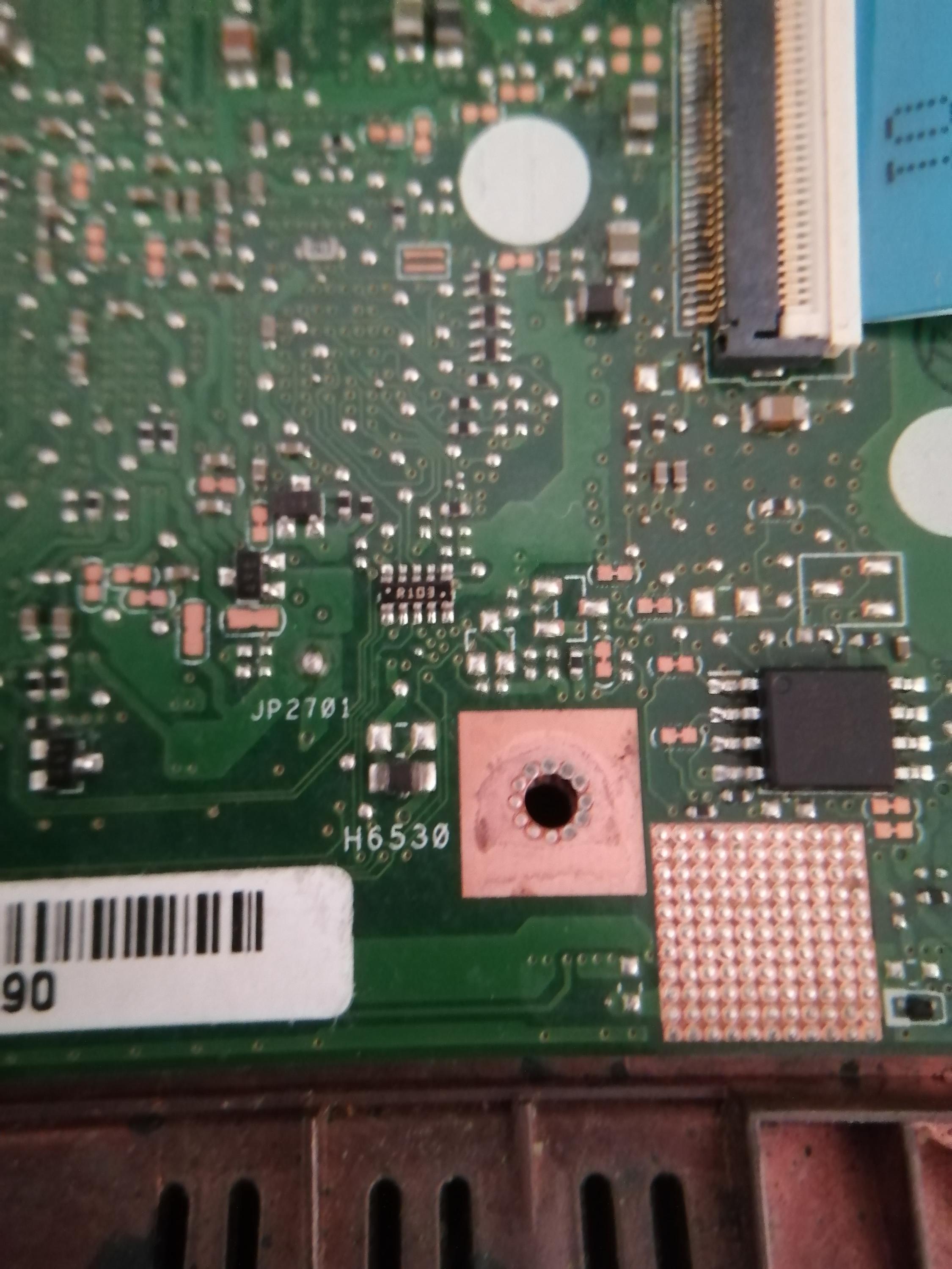

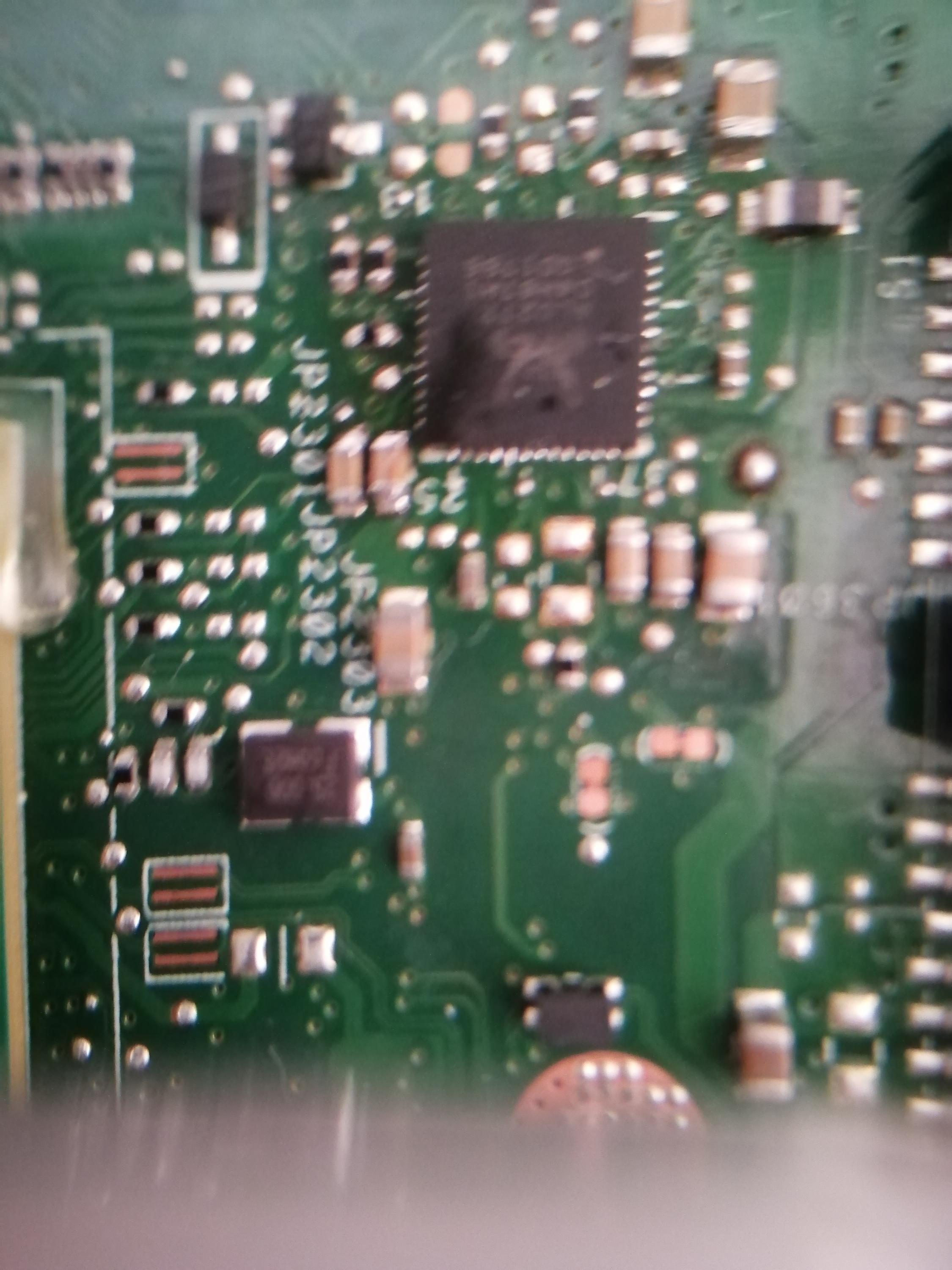

            These are the images of the sound chip and local area on both sides of the board....
            I have replaced this ALC277 and the transistor in the pics. The 2.5v zener diode was checked too ....cant see anything blown or got hot or anything that looks like an opto package
              I suppose it's got to be something in common between the Mic, output and jacks as none work. The codec chip was my first suspect but it's reported as okay, doesn't get hot and is installed correctly ...
