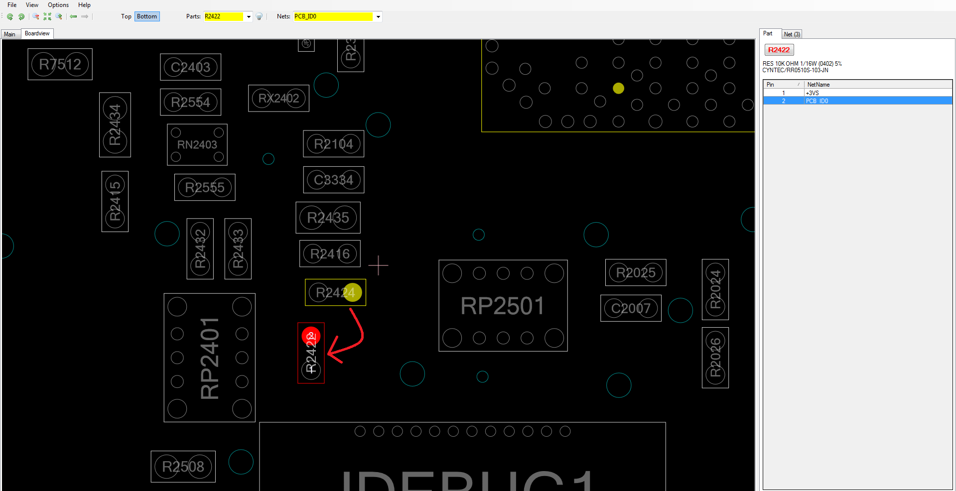

Hello, I would like to share info about onboard ram disable for asus x552c board x550cl rev 2.0.
Since I couldn't find anywhere info for the configuration of pcb id's, I had to try for it to work.
PCB_ID0 - LOW (moving resistor from R2422 to R2424 close to pch)

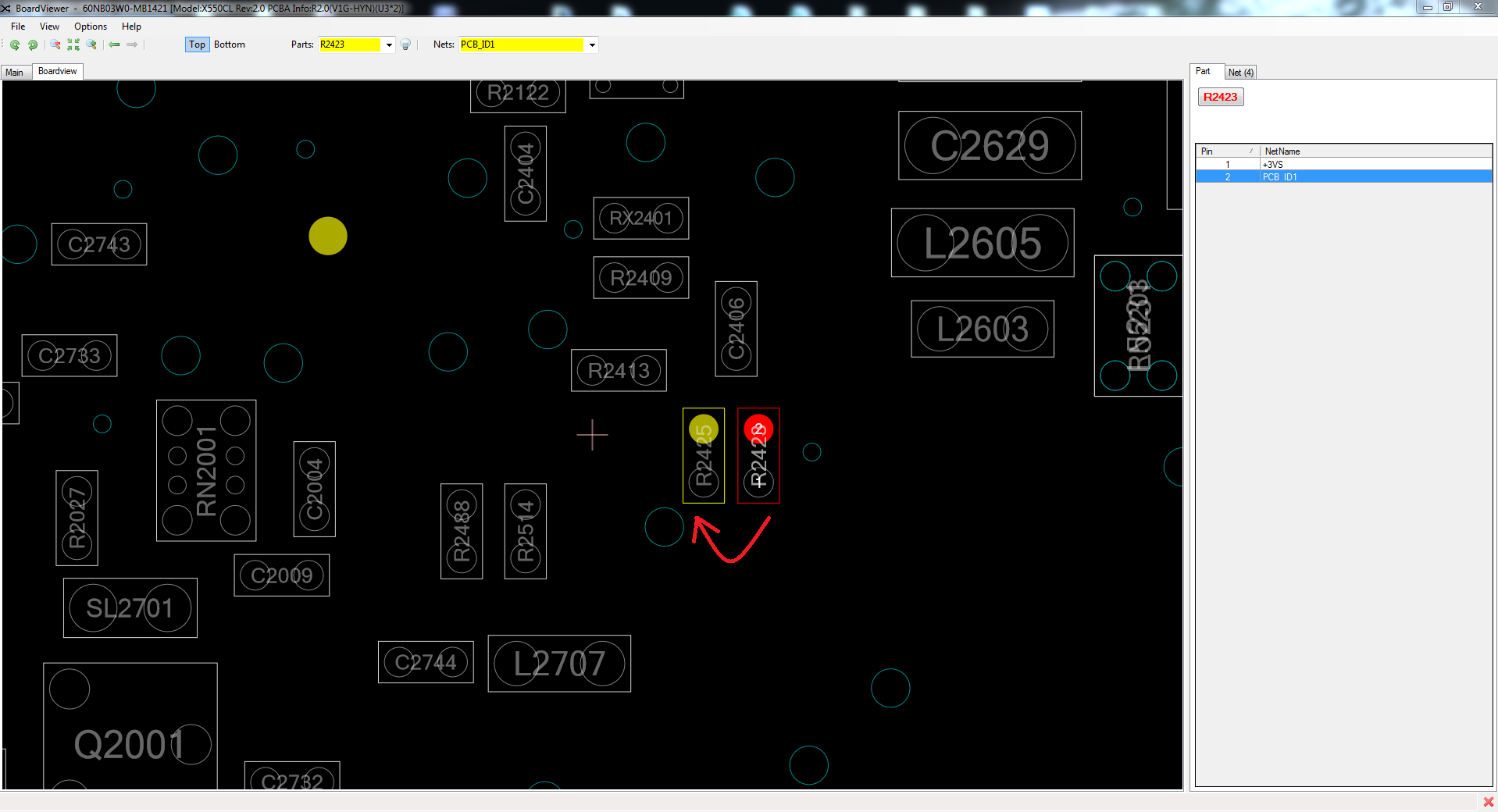

PCB_ID1 - LOW (other side of the board, move R2423 to R2425)

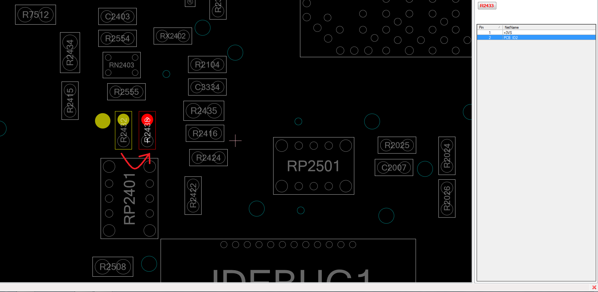

PCB_ID2 - HIGH (R2433 was the position but if there is no resistor, move it from R2432 close to pch)
All of the resistor values are 10kOhm in 0402 size.
I hope this helps!
