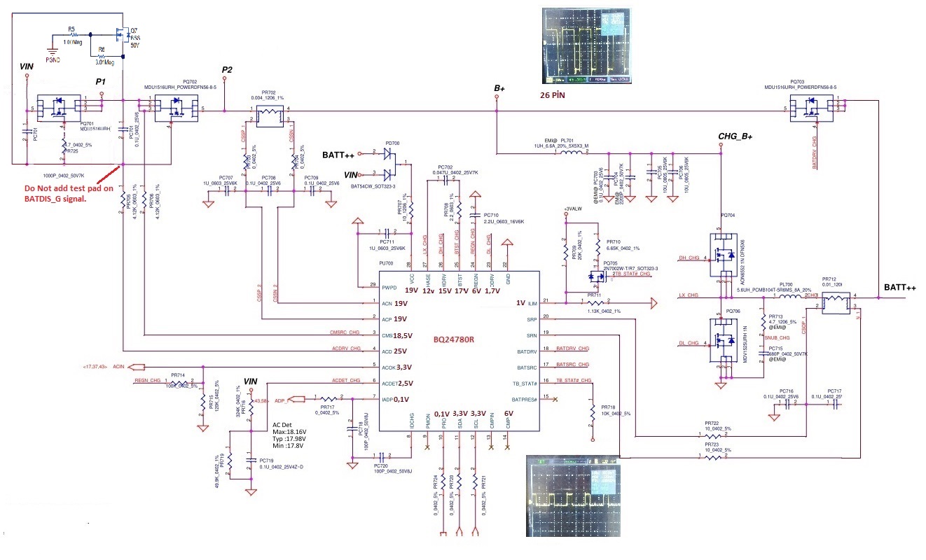

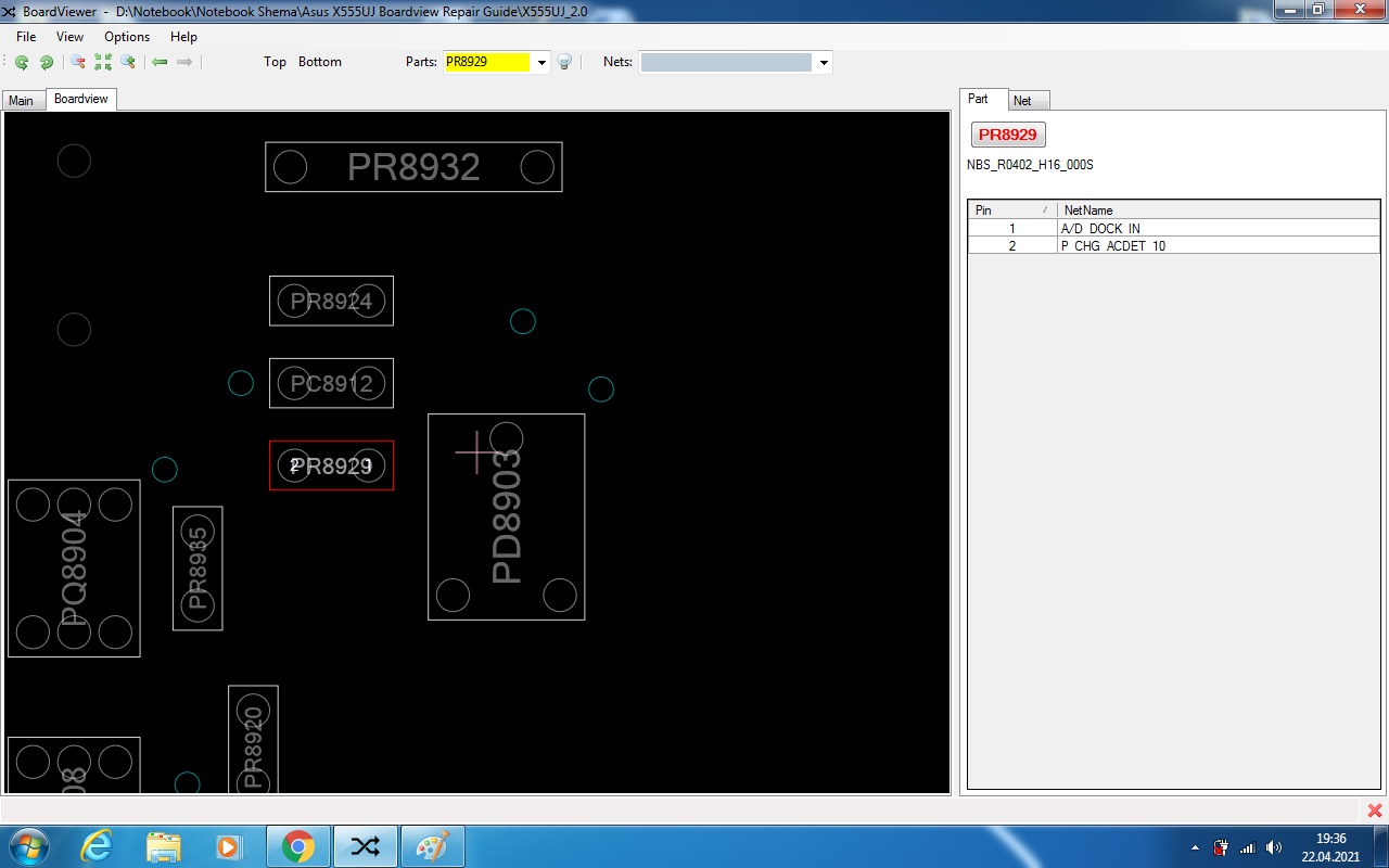

    Asus x555uj notebook 19v no input. With which program I can see the value of PR8929 resistance in the boardview file. charge control BQ24780 AC_DET input is missing. I'm looking for a program.

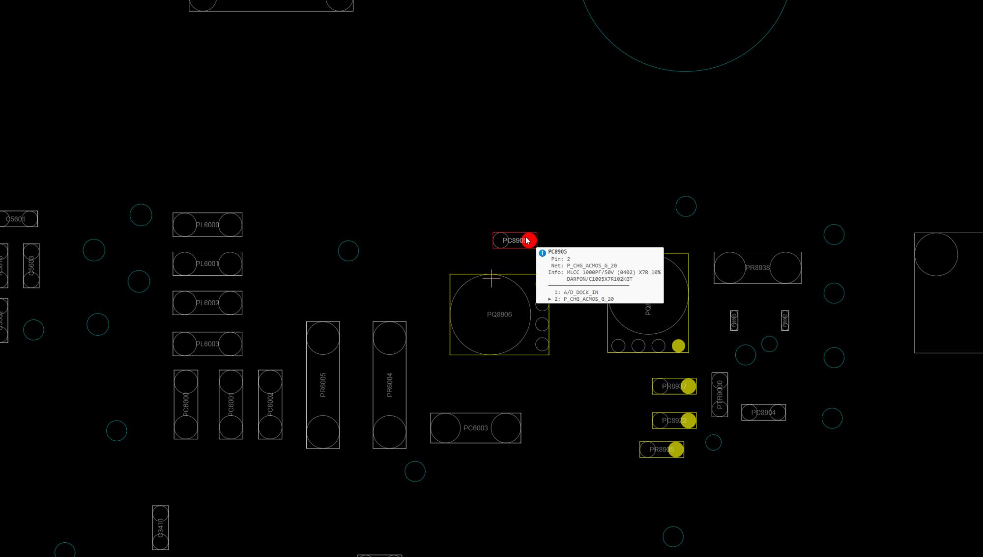

          the file here. I am using boardview version 2.1.0. but I can't see the resistance values. Which program do you need?

              thank you for the answer. I noticed that it is not in *.asc files, but in *.fz files. need to find a different boardview file.

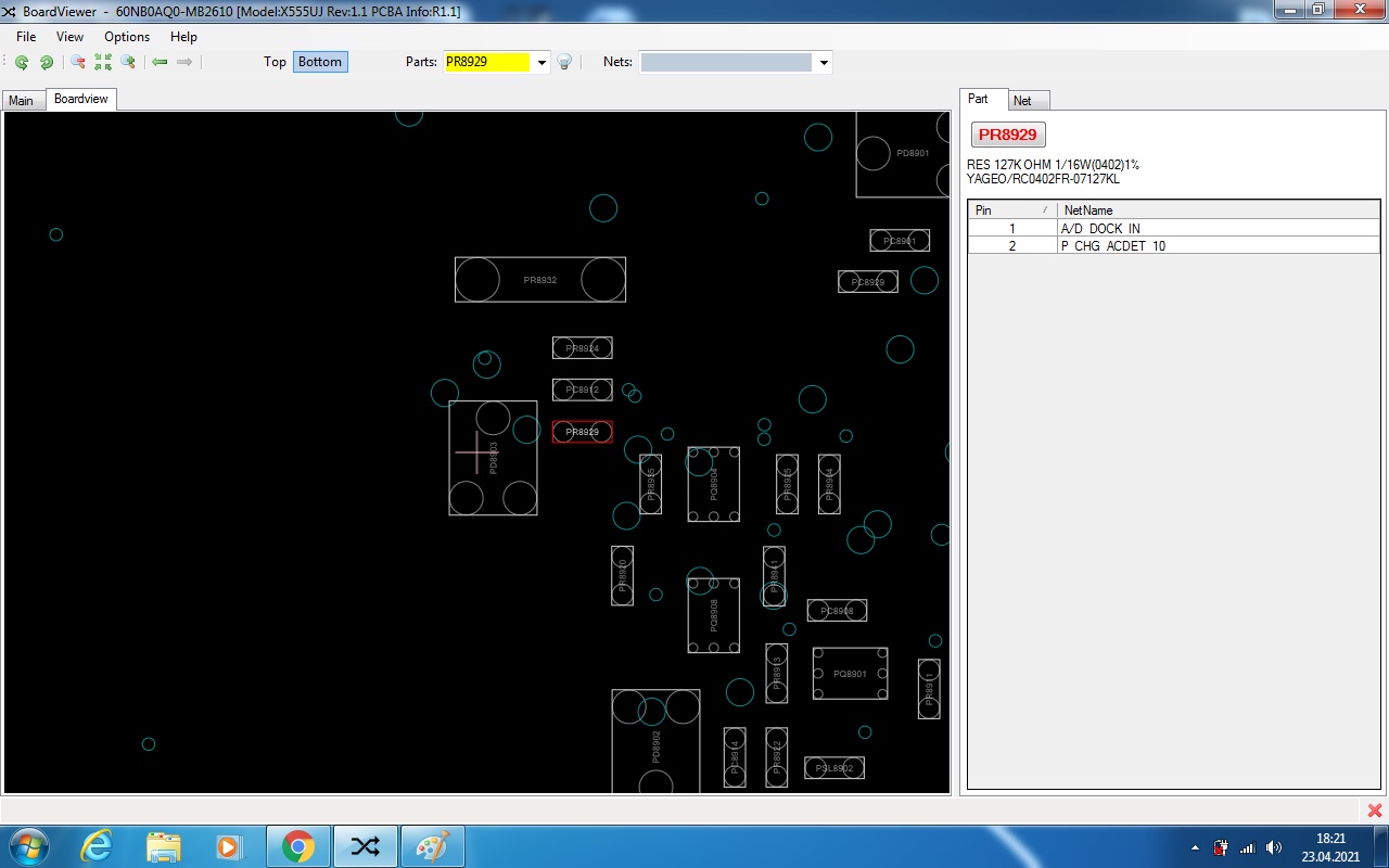

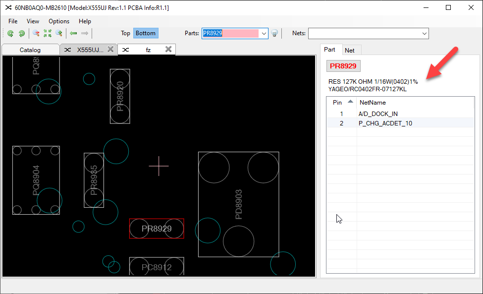

                  It was needed for a liquid contact x555uj. Thank you, I found. For PR8929 127K resistor rating.

                        Hi. Please see attached. Post back if you have trouble in reading these files with your viewer.

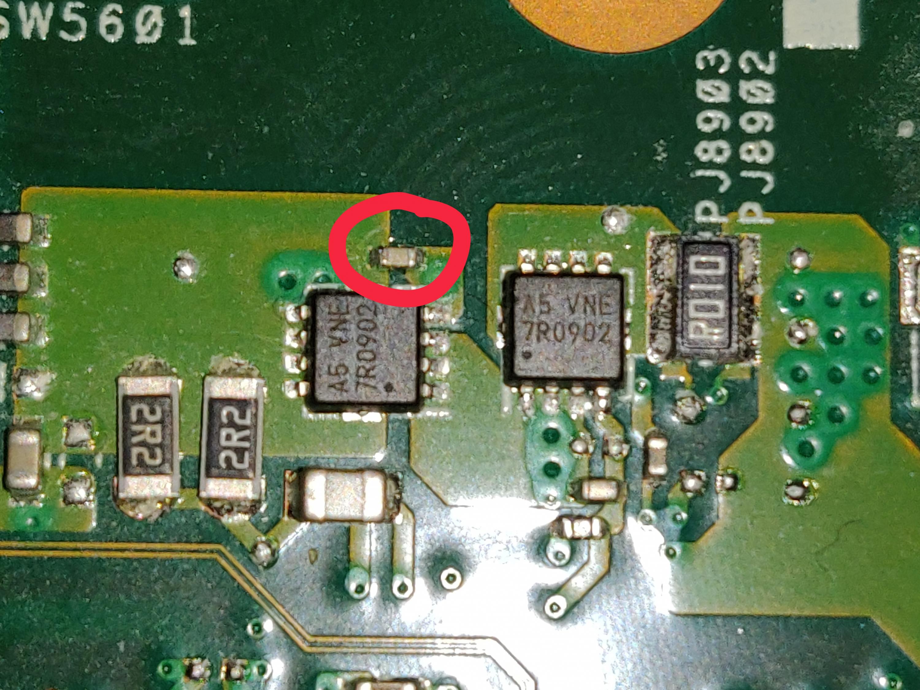

                              It's "PC8905" It's connecting the gate of the mosfet below it to the input 19v Rail. I've attached pictures for reference.

                                I'm pretty lost regarding this. I replaced the cap and it didn't work, now I thought it might be a short to ground, but I tried using current injection to find it and nothing gets hot, instead the thing turns on and works perfectly fine. the only other thing I could think of is that the mosfet right below the cap might be defective but I don't know how I would find out. I think I'll just try to find a replacement for it and if that doesn't work I might just as well try bridging that part and seeing if it works, because if the mainboard breaks I'd need to replace it anyways.
                                Do you have any other ideas?

                                  Probably because the second mosfet is short-circuited, the first mosfet does not open. or there may be a short-circuit in the +B part.
