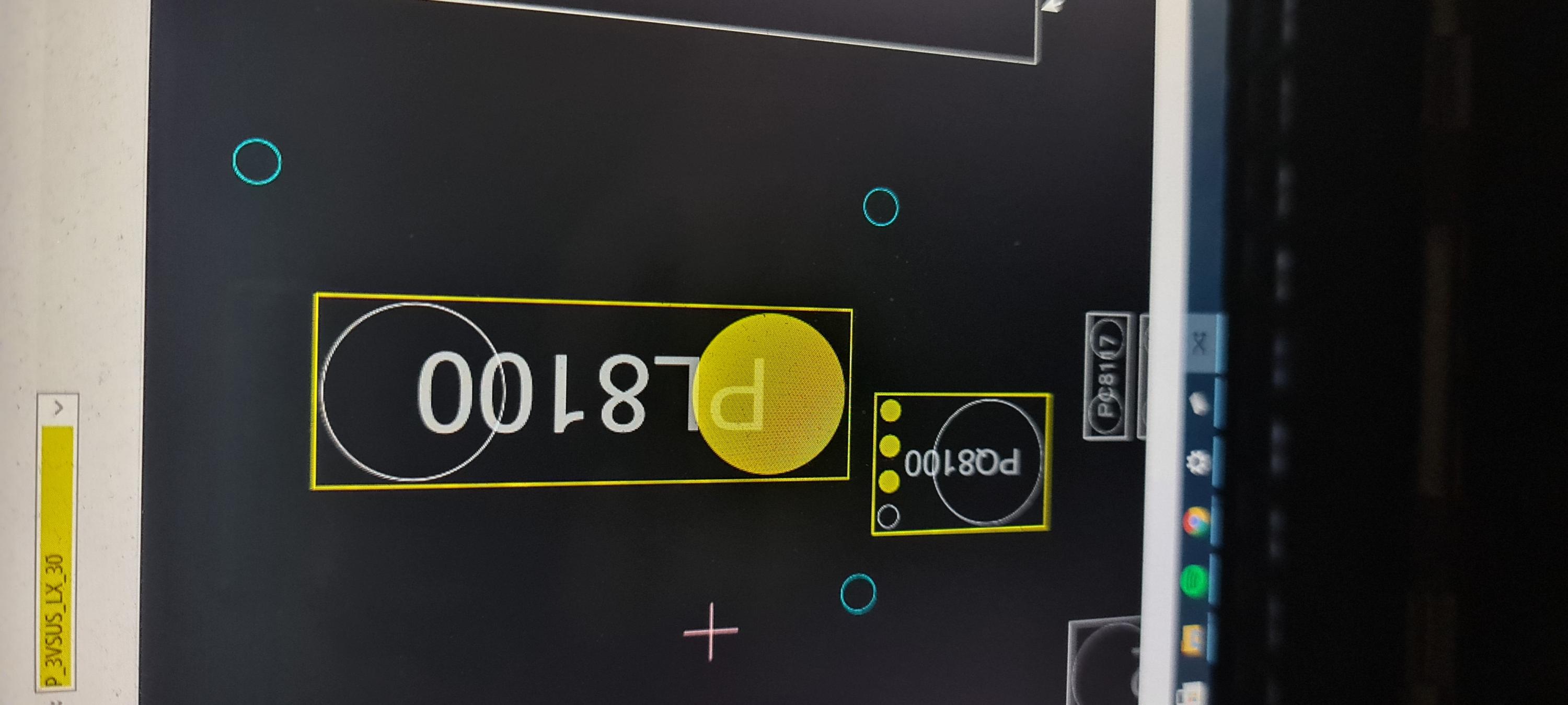

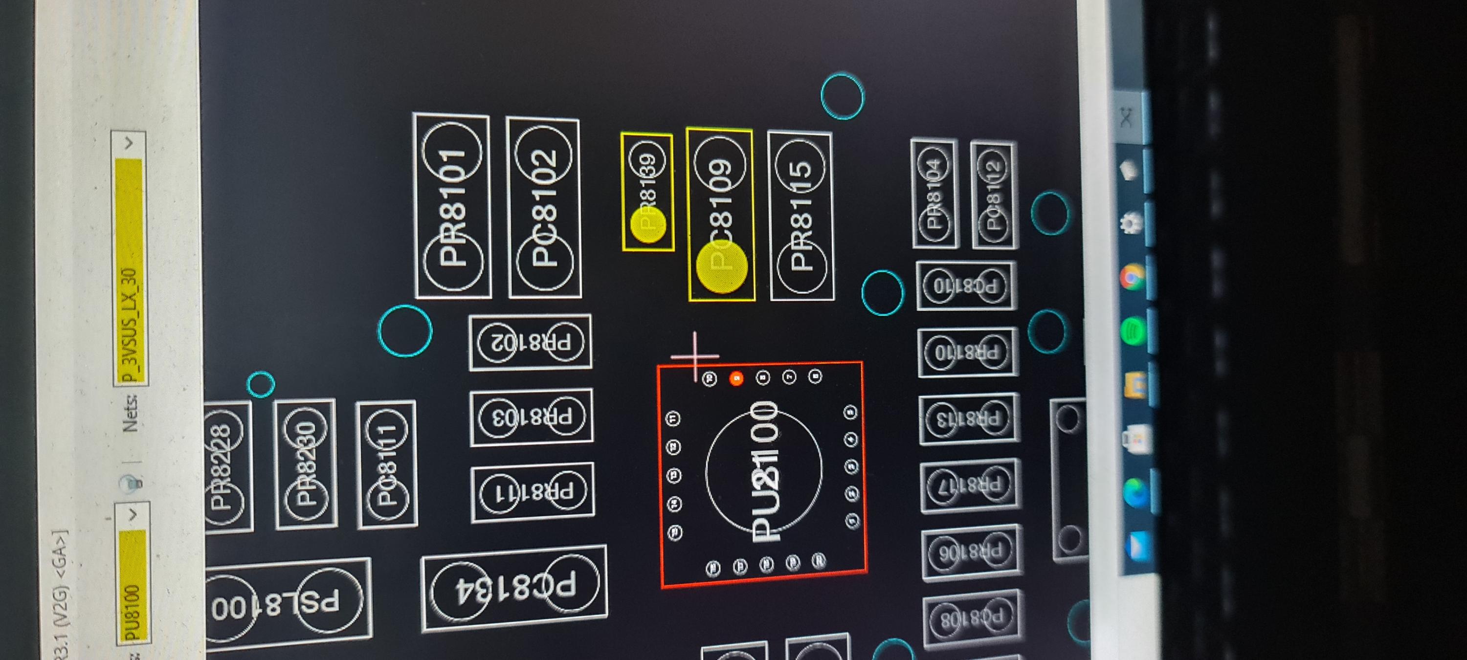

    Hi friends, i had Asus K55vd laptop, before it was powering on and working well , I disassembled it for cleaning, and realised that some pins(3 of pins next each others) were went in corrosion on super io chip U3001 (IT8517E/HX) , so I decided to clean and resolder them with flux and hot air stations, and I made it soldered properly well all pins (this is not the first time I replaced an super io chip and I inspect under microscope that all pins soldered well and there is no touching pins each other)
    After then, I want to test it and make all connections, when connected to bench psu, the amp meter shows 0.07a then instantly drops to 0.02a (which is normal stand by start up stage) but when push to the power button it doesn't start up and remains on at 0.02A stage. After I checked some voltages power button has 3.29V and when pressing switch it goes to 0V but laptop is not turning on, also when measuring PL8101 coil I get 5.02V and 5v always on is present but when measuring PL81000 coil I get 0.13V instead of 3.3v strangely those are 3.3v and 5v always on coils also when I test pin 9 of RT8239B (3.3/5V power regulator chip PU8100) I also get there 0.13V instead of P 3VSUS LX 30) according to board view file. Other voltages are seems OK expect 3.3v , I also check for on short circuit on 3.3V coil line, but there is no short circuit.
    So what you think guy's?? What might be the problem?? Is it RT8239B ?? (I don't have spare to test it , what can I use as equivalent to RT8239B similar to TPS series?? Like 51125 ?? If so ??
    Please guy's help me what might be the problem??

    Re: Asus k55vd does not power on
    I get 0.13V on yellow markings instead of 3.3V strangely 😂🤣

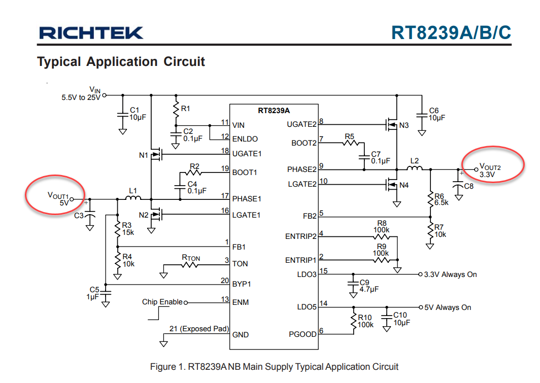

      "what can I use as equivalent to RT8239B similar to TPS series?? Like 51125 ?? If so ??"
      According to the TI cross reference tool no,not a pin compatible one anyway - https://bomcross.ti.com/en/search?searchTerm=RT8239B

        Thanks my friend for your Quick reply 😂🤣 so what's your opinion about the problem??, I might damaged the rt8239 accidentally??
          Any help, idea and suggestions please?? That why I get 0.13V on 3.3v coil instead of 3.3V ?? If rt8239A damaged why 5V coil is ok ??
            The regulator offers 2 independent regulators inside a single package. It is possible that 50% is working while the other half is not.
            Can you power down, remove the battery and check the resistance on the coil related to the 3v3 rail? Place your meter in resistance mode, black probe on ground and red on the coil for this rail.
            What is the reading? Perhaps you have a shorted cap on this rail?
            Also, which version of this motherboard do you have? Can only find boardview and a service guide for this chassis. No schematics.

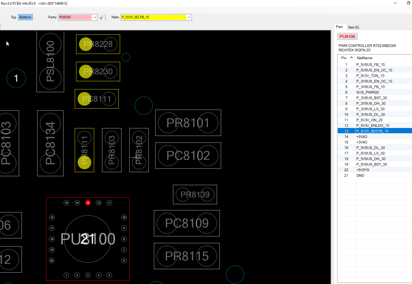

              For RT8239 to work, it must be 19v at 11 pin , 3.3 V at 12 pin, 3.3 V at 13 pin and 3.3 v at 6 pin ( powergood ). are these measurements complete? voltage outputs and after can be shortcircut. you can try by injecting voltage.

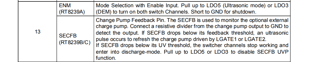

                    Monitor pin # 13 as there are differences in the A vs. B version of the component.
                    See attached. There may be other differences.
                    Grab the original component that you need for this repair. Aliexpress -> search for this exact p/n RT8239BZQW -> sort by the # of orders.
                    The coil resistance to ground seem good to me. If there was a short, you would have a much much lower resistance for these rails. Then current injection will force the shorted cap to heat up / fall apart right in front of your (protected) eyes.
                    As per above post, what is the value @ pin 11 ?
                    Are the feedback resistors to generate the feedback voltages @ pin1 and pin 5 ok? It is possible that if one of these parts is missing, the regulator is quickly shutting down due to the proper and expected feedback voltage. Power down, remove battery and confirm that each FB resistor in the voltage dividers is the proper value and that they are making the contacts to this Richtek controller.

                      Thanks you my friend for your reply, I measured the pin numbers that you mentioned, at pin 11, 19V present, but at pin 6 there is no voltage, its 0.01 almost zero, at pin 12 it's strangely 6.53V not 3.3V 😂🤣😅 also at pin 13 it's 2.8V not 3.3V also, by the way , I checked the pin 2 and 4 which is an enable signal for 3.3 and 5v , at pin 2 it's 2.8V but at pin 4 it's 4.99V (almost 5V)

                        My apologies. I posted the "A" example schematic earlier (see above).
                        It should have been "B" version of the chip.
                        Please see attached from the Richtek datasheet.
                        So, with the "B" chip on your system, do you see the FIXED rails (always on) @ pin 15?
                        Pin 15 should be +3v3
                        Pin 14 should be +5v0
                        these are independent fixed regulator outputs.
                        Pin 11 Vin @ 19v sounds good.

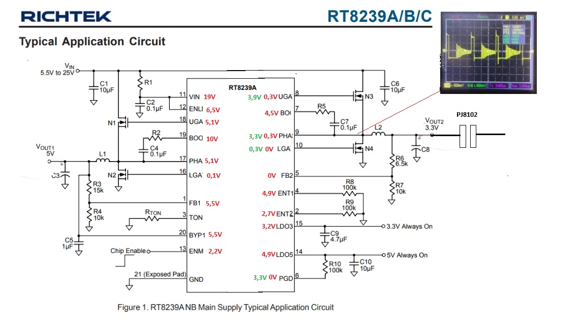

                          Thanks my friend for the all information , here is the all voltages that I measured on RT8239B
                          PIN1 0V, PIN2 2.76V, PIN3 1.94V, PIN4 4.99V, PIN5 0V
                          PIN6 0V, PIN7 4.57V, PIN8 0.13V , PIN9 0.13V (WHICH IS EXACTLY SAME VOLTAGE ON 3.3V COIL)
                          PIN10 0V , PIN11 19.54V, PIN12 6.53V , PIN13 2.20V ,PIN14 4.99V , PIN15 3.29V, PIN16 0.11V , PIN17 5.10, PIN18 5.10V
                          PIN19 10V And PIN 20 is 5.05V

                              Your measurements show that there is a problem with the 3.3v output. You can see if there is a malfunction in the chip by removing the PJ8102 jamp after the 3.3v coil. Sometimes problems may occur after 3.3v S5 MOSFET (wifi card, sound chip gb). You can give voltage starting 1v after the jumper. measurements, the reds should be your greens.

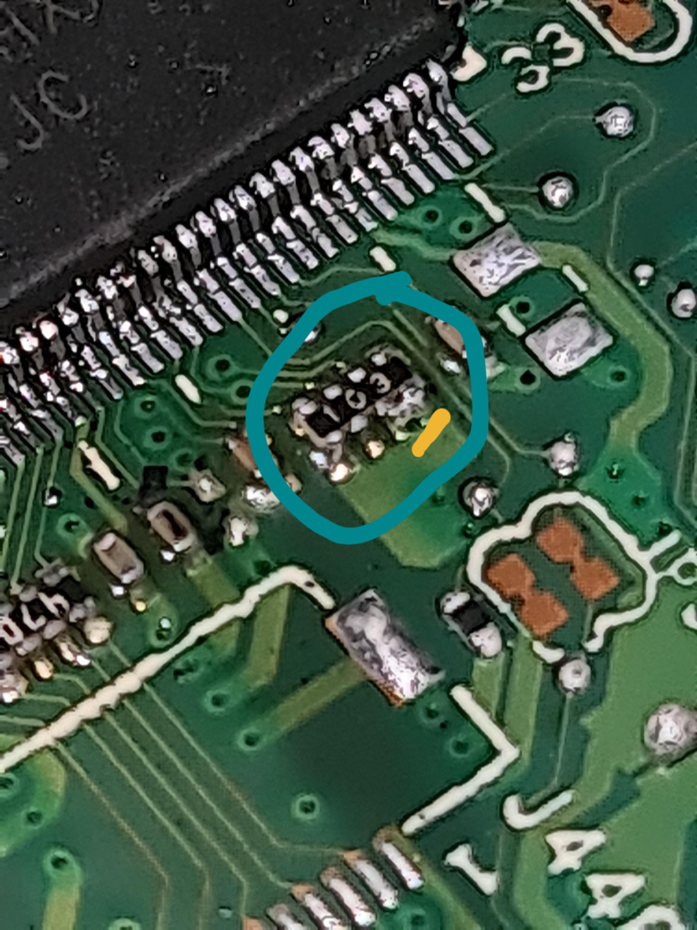

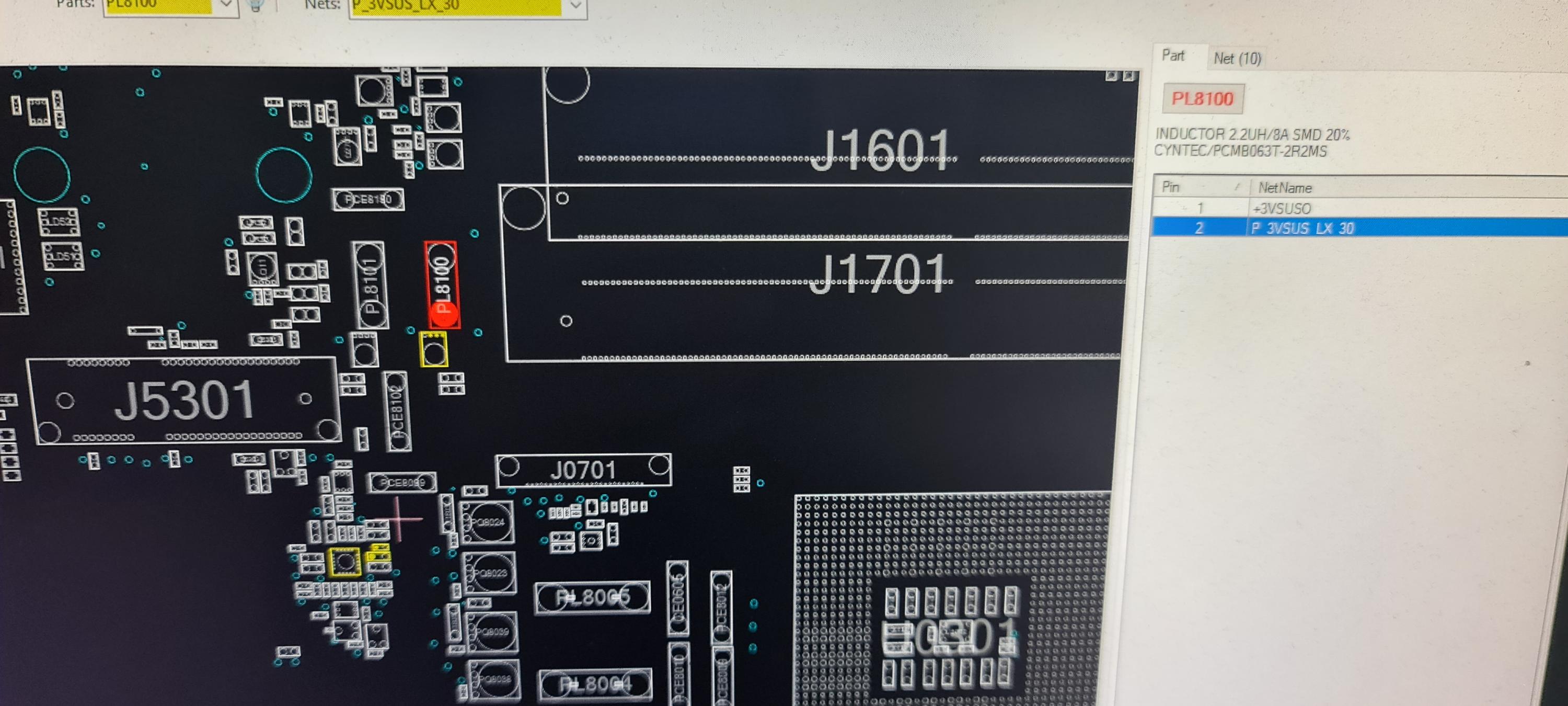

                                I solved the problem , what am I an idiot ������ the problem was I just accidentally made short circuit the legs of the serial resistors (a tiny one, I attached picture) which was near the super io chip while renewing the solders of corroded legs of super io chips so , 2 of legs becomes short circuit on side of super io chip and that's why the laptop weren't get start while pressing power switch. So I switched the side of the serial resistors and the problem solved ������ see the pictures
                                So I advise you when working, if there was an problem after. Always inspect what you done before and recheck what you done ������ thanks for everyone who helped and wasted the valuable times with me
                                On pictures see that short circuit on the legs of serial resistor marked with blue, and the legs got short accidentally marked with yellow, it was on super io chip side but after I switched side the resistor, so short circuit side remain other side but it's not a problem because other side all pins are in common, then super io chip legs now not in short circuit, and laptop is working now
