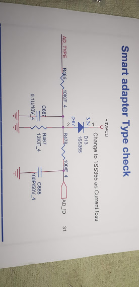

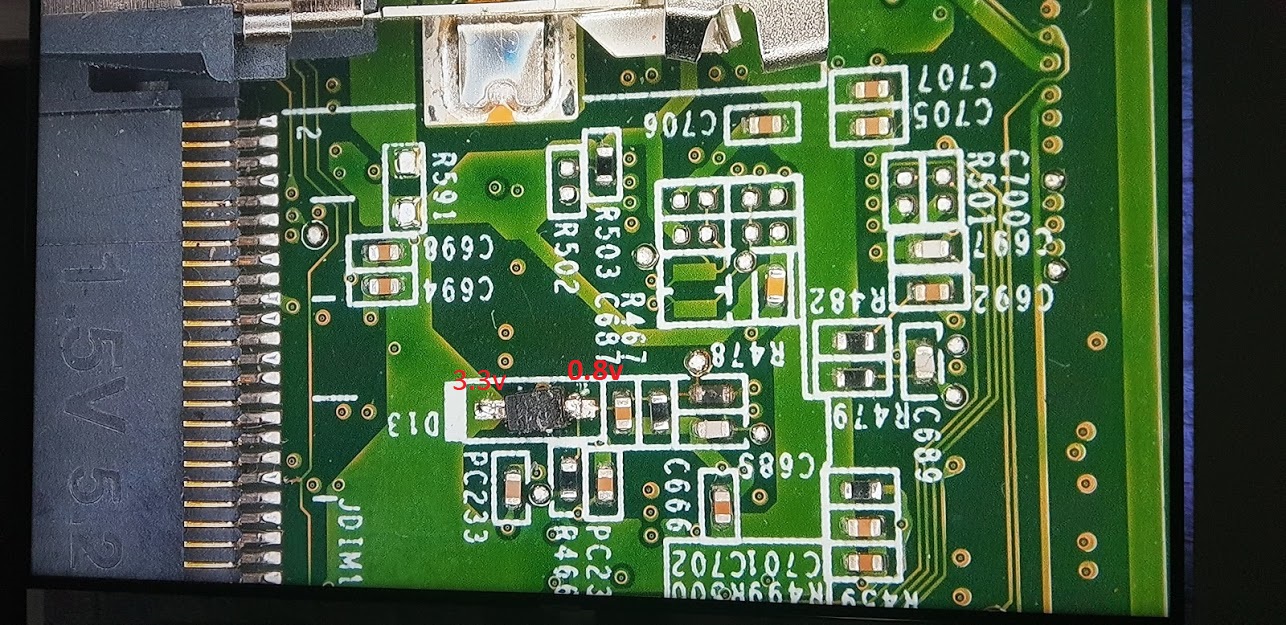

    Hi, guys got this laptop with no charging indicator I changed over the charging port as the old one was damaged but still no joy I read a post on here to check certain components as the 19v goes to the charging identification pin and damages components and upon checking the one that is not correct is d13 one side has 3.3v and other side has 0.8v I lifted one end of the diode and its still the same ..
    And advice to put me in the right direction will be much appreciated
    Garry

      D13 measurement is fine-nothing wrong there. If your issue is charging, post voltage on D-S-G of PQ40/38. Charging IC pin5 and pin6 Voltage?? If possible, post measurement of all pins of charging IC. Btw, Battery is good??
