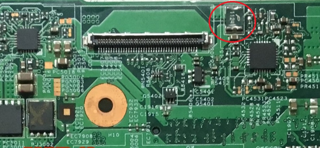

I have here acer es1-431, the problem is when i plugged in the charger orange light present but on the screen backlight is flickering pressing power button nothings happens, anyone encounter this please help
acer es1-431
Tags: None
Re: acer es1-431
You`re a senior member and should know by now that you should give as much detail as possible. Voltage measurements ? ,tried another screen ?, tried without the screen and LVDS attached ? ,tried another LVDS cable ? ,checked the panel PCB voltage at coils ? , checked DC-IN mosfets ? ,tried another charger ? , checked the power jack , checked al ports for damage , tried with and without the battery .Last edited by SMDFlea; 02-27-2021, 08:25 AM. -
Re: acer es1-431
all voltages is present, screen is good tested on another laptop, lvds cable is good tested, tried removing lvds cable and switch on no external display,fan is not spinning, check voltages on power button 3.3v is present, without battery same issueComment
Re: acer es1-431
history of this laptop is working fine until one day when plugged in the charger the backlight screen is flickering and cannot turn onComment
Re: acer es1-431
and here is the other details sometimes it can turn on and display comes but when it rest same issue appearedComment
Re: acer es1-431
same issue when plugged in the charger backlight on the screen lights but sometimes it can turn on and display comes but sometimes cannot turn onComment
Re: acer es1-431
yes its normal when turn on pin 40 39 on lvds have 19v and pin 36 35 34 LCDVCC have 3.3vComment
Re: acer es1-431
When you are not getting display, check VS voltage. To mee, it seems like run voltage issue.Comment
