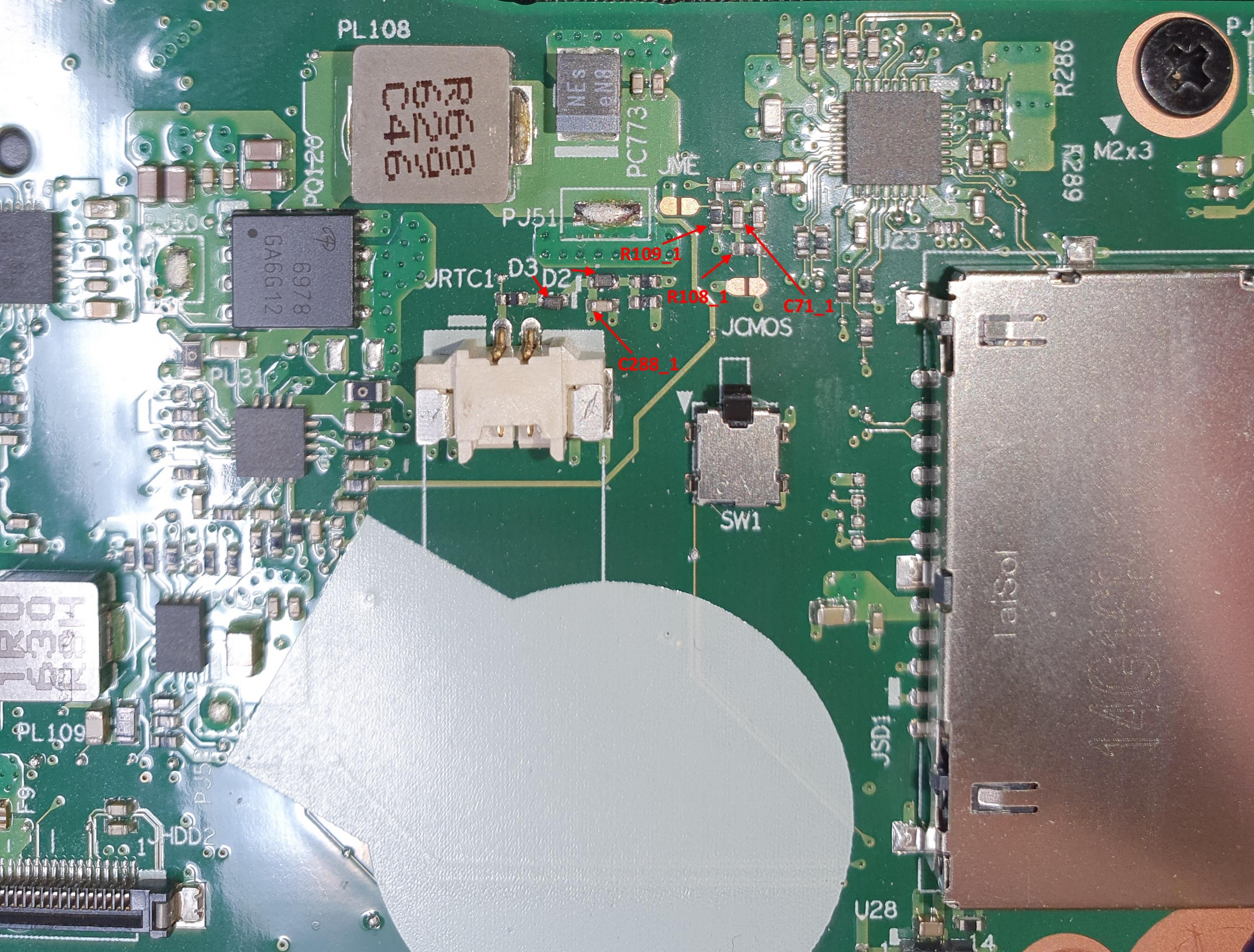

    I'm looking for pointers/ideas to find what's wrong with the motherboard of my Lenovo Thinkpad P50.
    Motherboard: BP500, NM-A451, VER 1.0
    Schematics & Boardview: https://www.badcaps.net/forum/showth...hlight=NM-A451
    Here is what I know up to now:
    The computer was never in contact with liquid, nor dropped.
    It suddenly lost power while I was working. It was attached to the docking station, with the battery inside. Not any lights or other sign of life when I try to power on. The LED of the DC-in jack does not light up.
    The charger and the battery do provide adequate voltage.
    I tried to fully reset the BIOS' by removing the CMOS battery and I tried power on with only the battery and only the charger.
    I discovered that the CMOS battery was dead (near 0 V); I bought a new one, but it does not solve the issue.
    I attached a 3V battery and measured a current draw of ~2.5 mA (off state), which seems huge to me considering that at this rate it would be empty in 3 days. Does it provide any hint?
    Visually, I do not see a problem on the board. There are some stains here and there, as illustrated in red in the attached picture, but I suppose it is just flux from manufacturing.
    I started measuring voltages and looking at continuity, thanks to the schematic and boardview. I removed all components except the fans and heat-pipes before measuring. The CMOS battery is not attached either. Should I attach it?
    VINT20 is OK everywhere I measured it. VREGIN20 is OK at R515 and R516.
    VCC3MP and VCC5MP are also OK at the output of the converters (coils).
    I got no voltage for VCC3M(P) at PR64.
    I measured ~3.3 V for VCC3SW at several locations, but I got no voltage at R526, R529, PR256, PR257, PR295. I suppose it's not normal but I'm not sure.
    From here, I'm uncertain how to proceed further in an effective way to find the source of the problem.
    I had a course of electronics at university several years ago, but I'm not an electronics engineer or technician. It's the first time I tinker with a board.
    Thank you for any advice.
    I'll gladly provide any further info. Later, I'll post a picture of the board with what I measured.

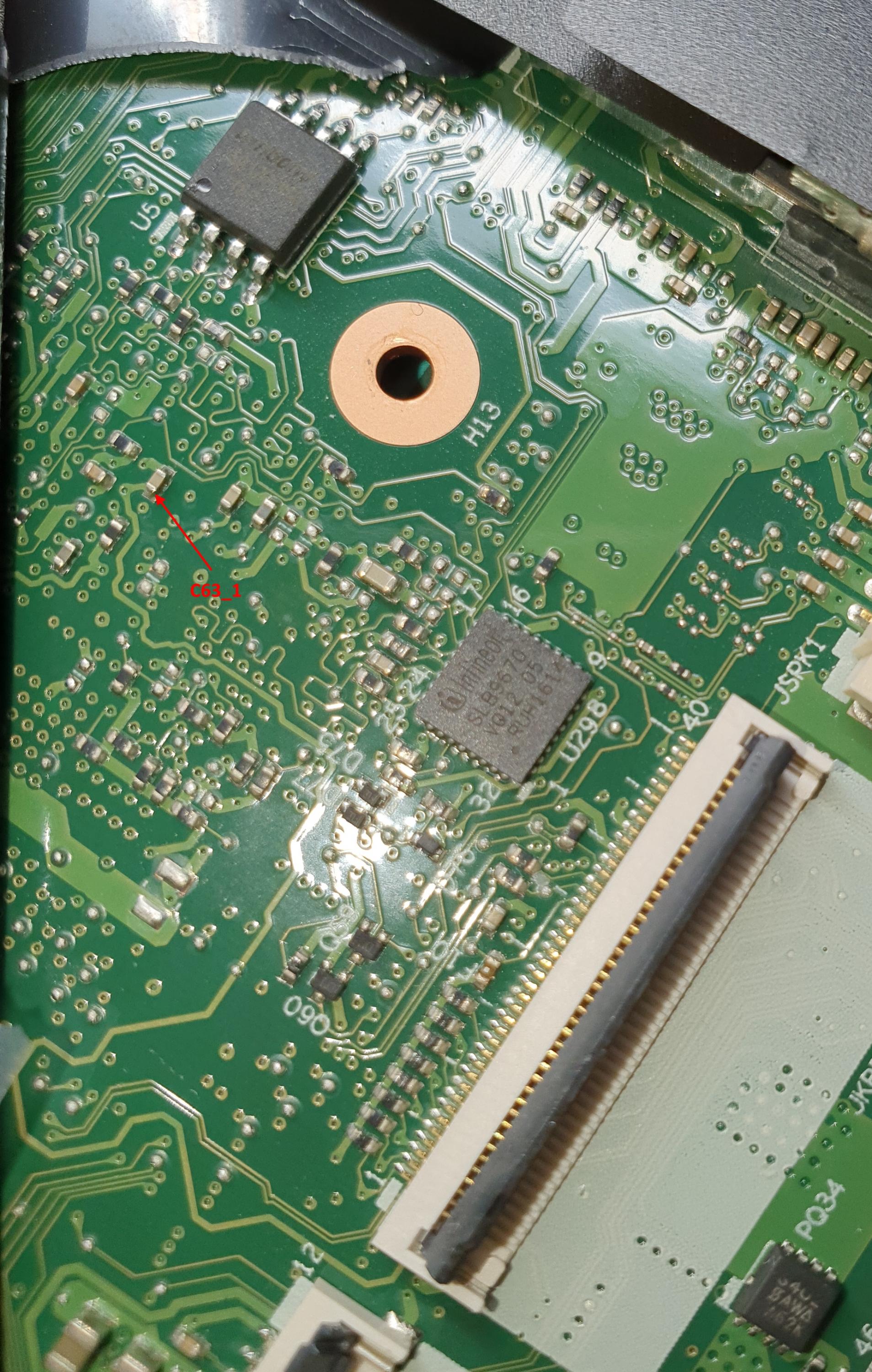

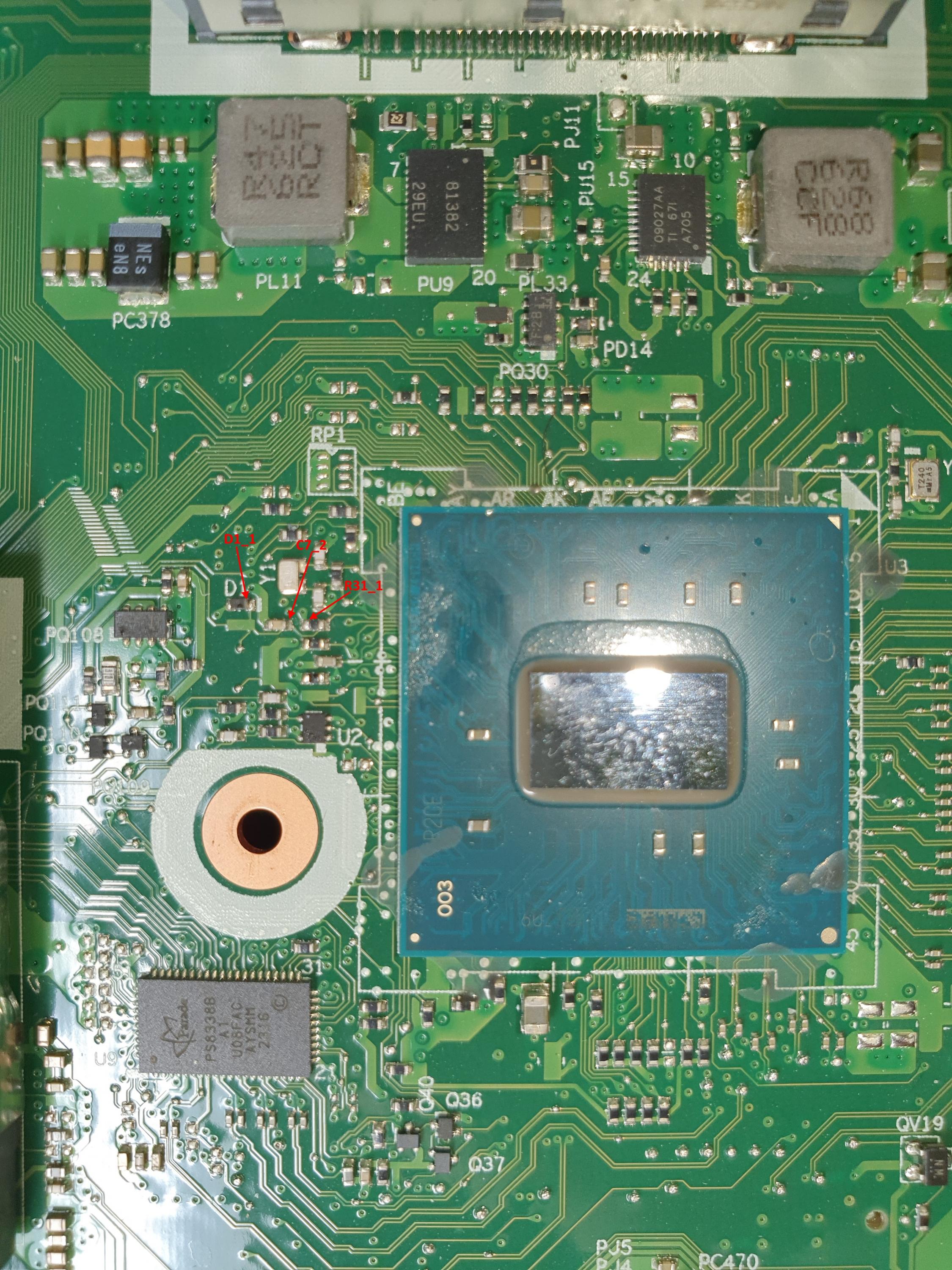

        Aah, those are small components... I attached pictures of them.
        I measure 3-5 ohm (R108_1, R109_1, C71_1 etc.). On R31_1 I get a bit more but I think it's due to a bad contact with my probes, which are rather big.
        I measure 20.4 kohm on the other side of those resistances, which correspond to their value (to ground).
        Should I therefore assume that one of the 3 tiny capacitors (C71, C63, C288) or the Skylake PCH is dead?
        By the way, at D1_1 I measured 200 ohm to ground with SW1 up and 0.915 Mohm with SW1 down. The last value is basically R31. At D1_2: 40.3 kohm with SW1 up and 120.4 kohm with SW1 down.
          Yes, you can remove the capacitors (just shift them away from one pad) and see if the resistance to ground increases. If no the PCH is most likely dead.

              My reply after quite some time...
              So, I tested what you suggested and the capacitors are all OK, so the Intel PCH chip is likely dead.
              Such a pity for a laptop which was barely more than 4 years old.
