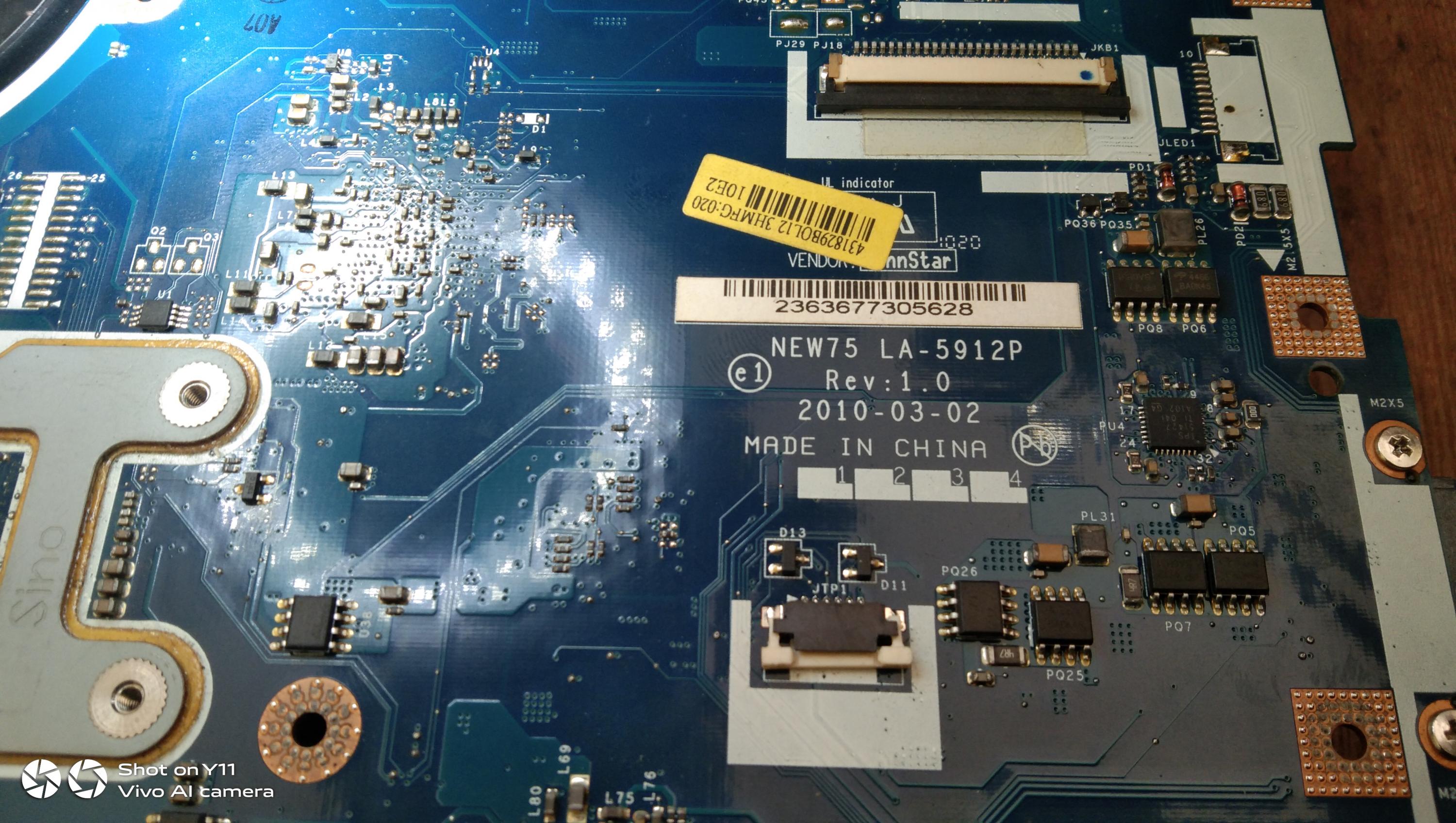

    Hello and have a good day to everyone.
    Does anybody here know if it is possible to convert this laptop from DIS to UMA? If possible can anybody help me do it. I have this laptop here with a damage GPU. I want to revive it if possible. Thank you in advance.
  • piernov
    • Jan 2016
    • 4435
    • France
    Re: Acer Aspire 5551 NEW75 DIS to UMA Conversion
    This is already a UMA board (the discrete variant is LA-5911P), with a dead AMD northbridge RS880M that is. It has to be replaced.
    • SirangKap
      • Feb 2020
      • 27
      • Philippines
      ah see..okay sir thanks. I don,t have a machine to replace its damage northbridge. so this laptop will go to recycling definitely. thanks for the info.
