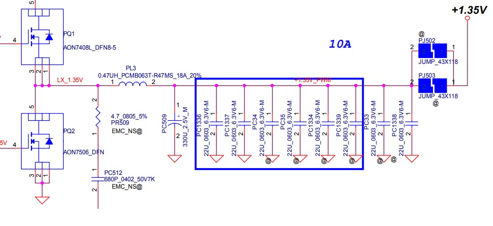

              Re: Lenovo Ideapad 110-14IBR - some power rails missing
              Well, I "unjumped" PJ502 and PJ503 (page 55) to isolate PL3 from the +1.35V path ahead, and measured resistances.
              PL3 now measures 13R to ground.
              The opposite side of the jumpers measure 0.1R. Looks like a dead short to ground.
              This means the soldered RAM is busted, right?

                The above was not a rethorical question :-) I´m a hobbyist eager to learn and would appreciate some guidance.

                    Perhaps I should invest in a more powerful bench supply? If it gets to +0.5V 3A, then heat dissipation is only 1.5W. Also, if the voltage change per current draw is linear, then with 10A the voltage should rise to more or less +1.35V, I think.
