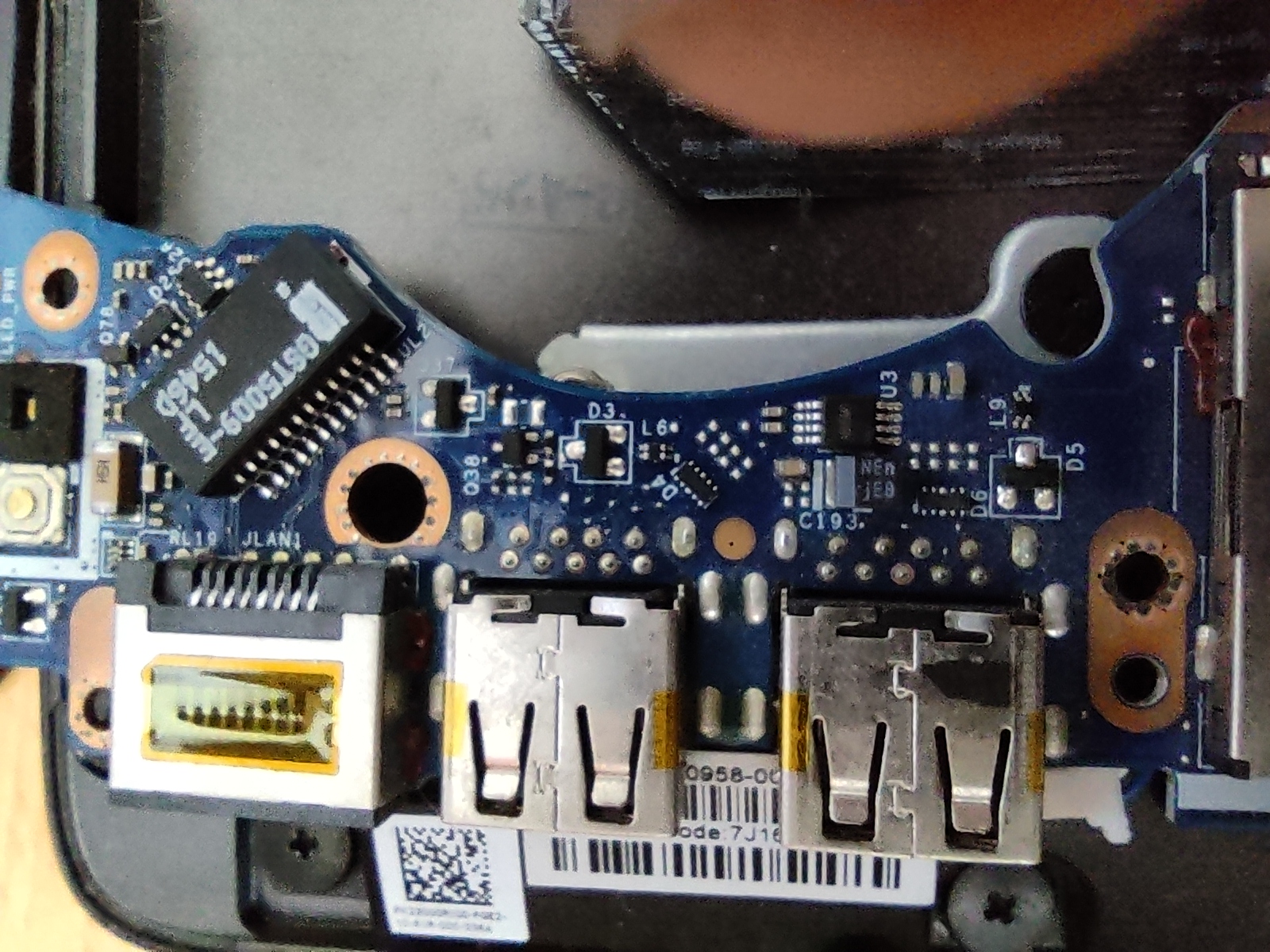

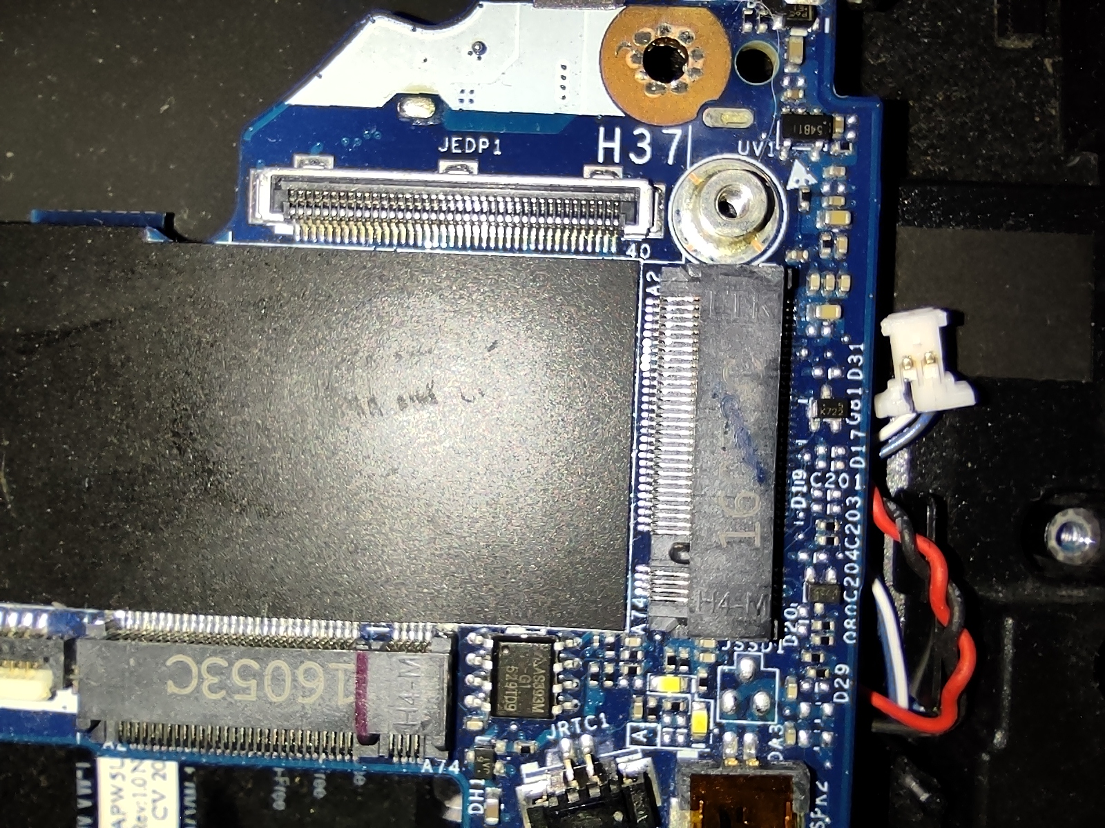

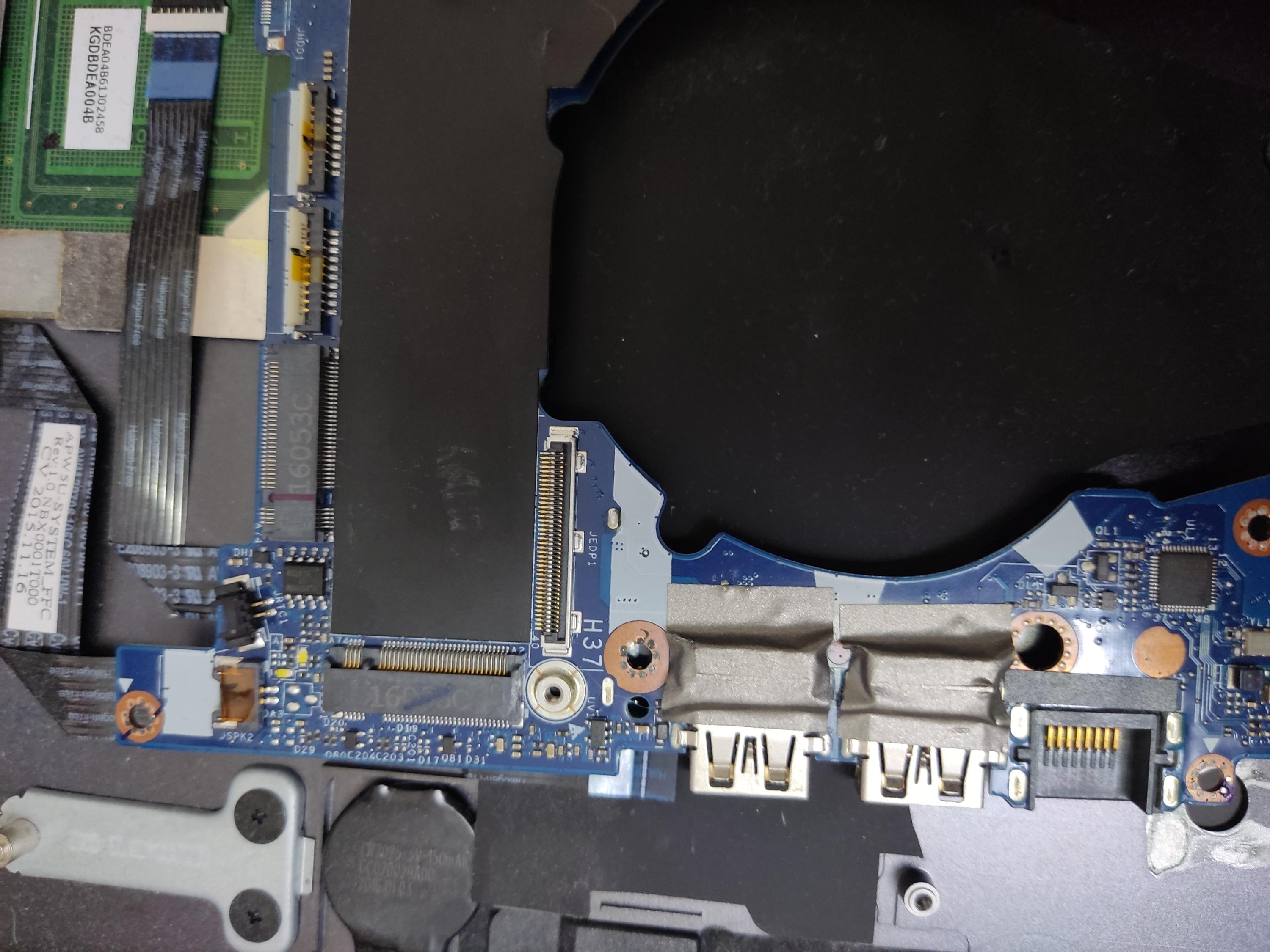

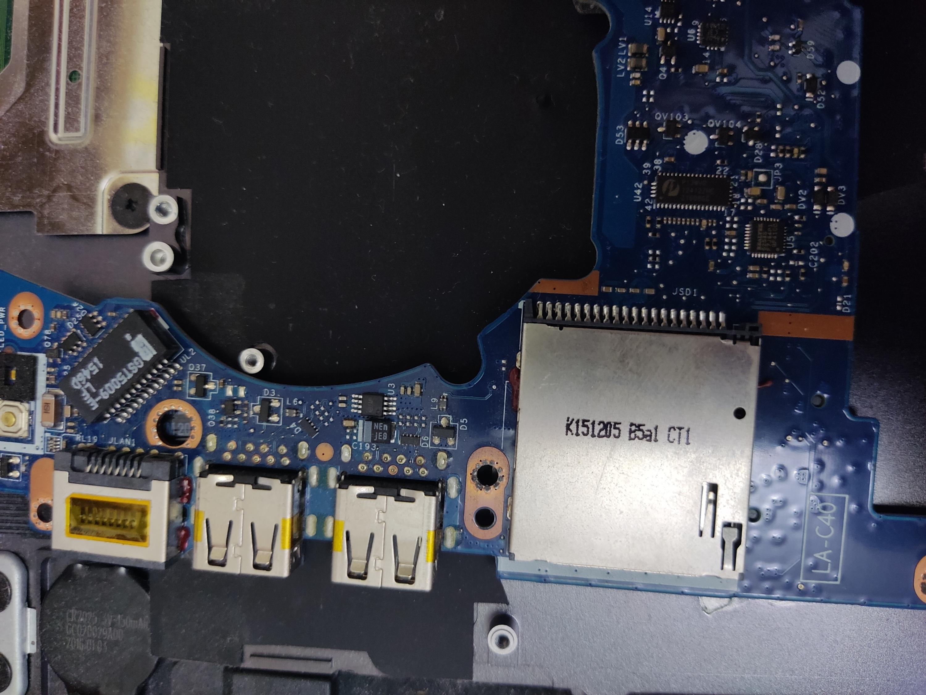

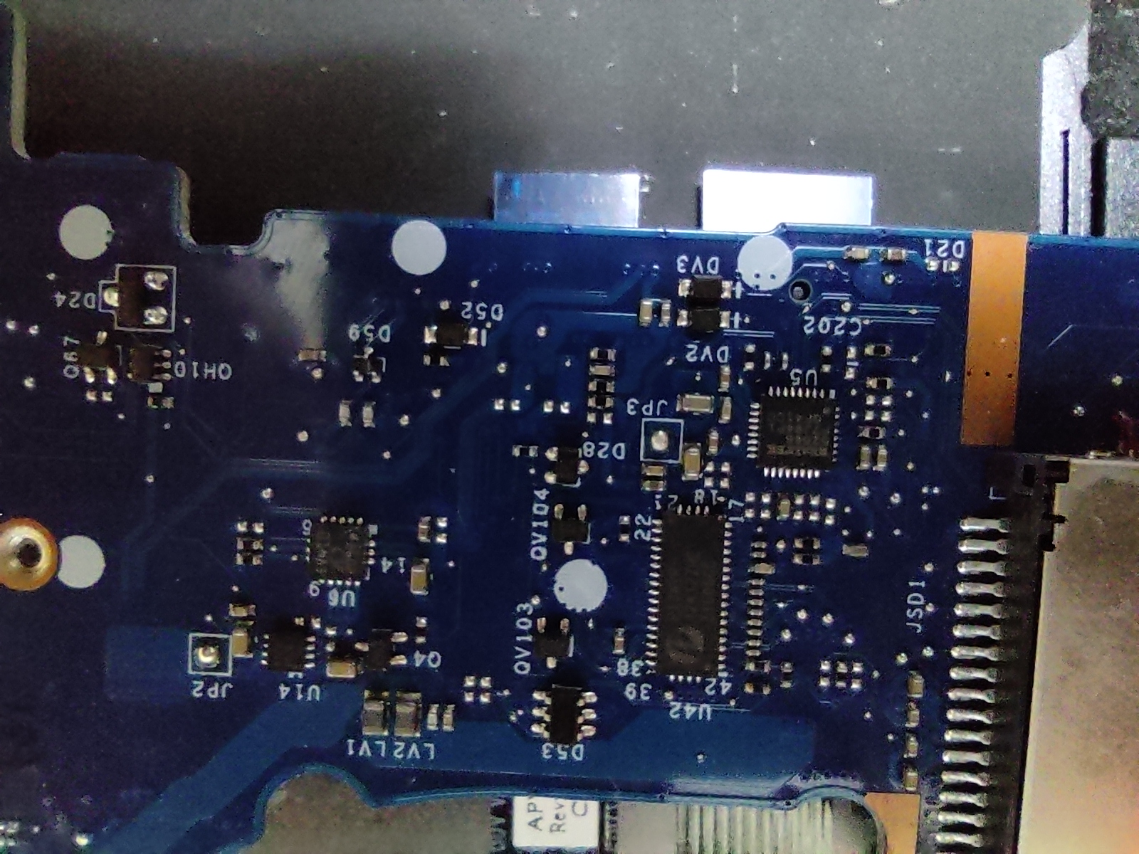

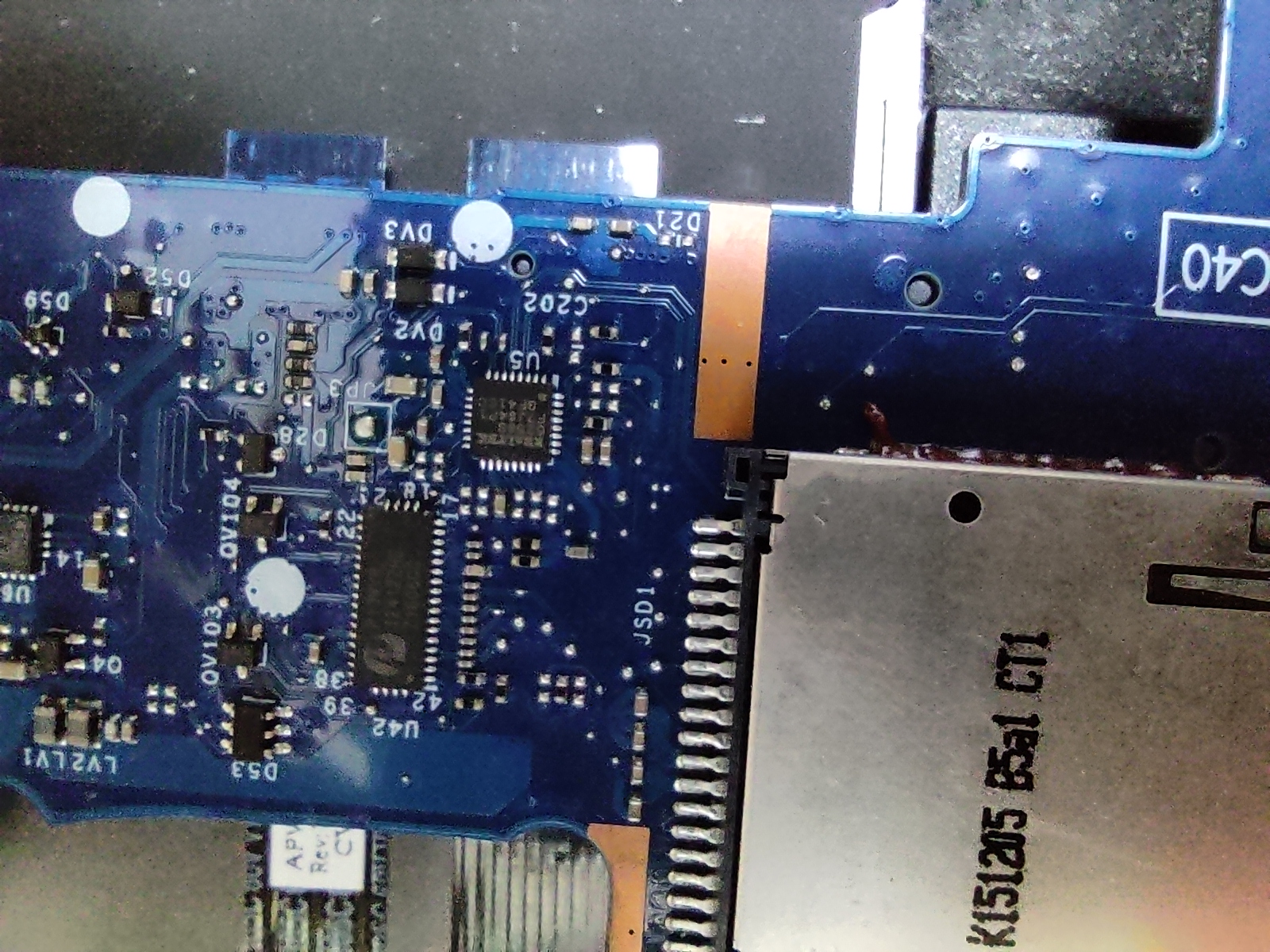

          Sorry, I can't for the life of me find it;
          This is the connector space, the sd card reader is at the back of it

            It could be the white part next to LV2 on your last picture.

              Re: HP ZBook 17 G3 backlight fuse
              no continuity on that one, so could be, will test, thx
                Thank you, that fixed the issue!
