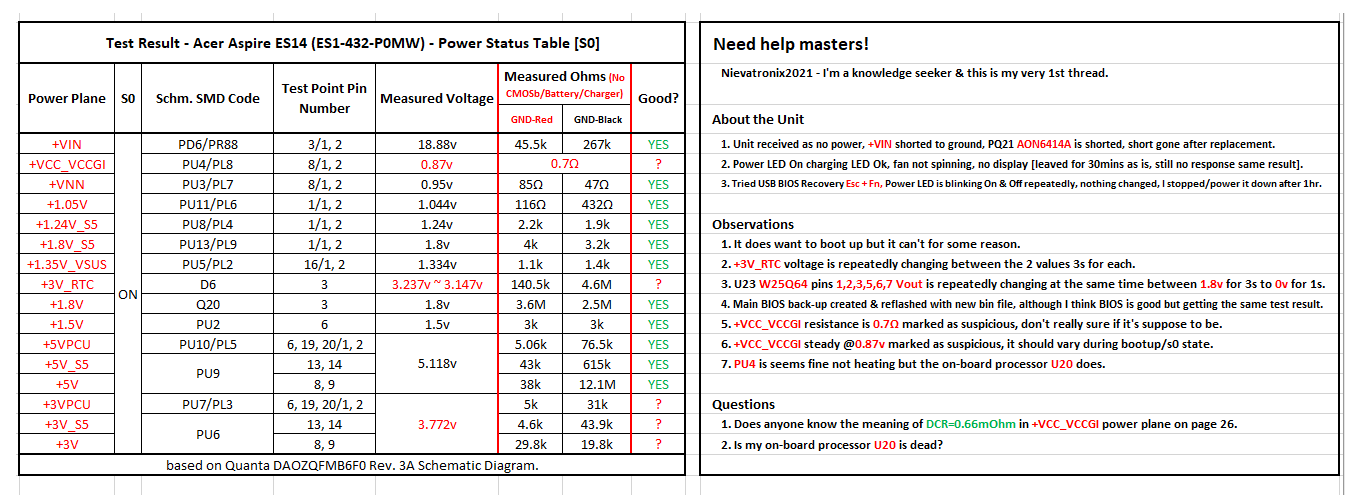

    Hi everyone I need help to diagnose this unit.
    See attachments for detailed test result.
    Fyi this is my very first post thread.
    TIA

    Re: Acer Aspire ES1-432 Power On & Charging Ok, No display, No Acer Logo, Fan not Spi
    What about Caps lock reaction ?? Or Num Lock ?? Have You tried reflash the BIOS ? ?
      Hi @matusig thanks for your response.
      Caps Lock & Num Lock no response, BIOS already reflashed with new one same s0 power status table test result.
          So after pressing the power button ... the system is On without Post, no Video, Fan not spinning ... what about the CPU is not heating uP ?
          Also I had quick look into the schematic ... You know that U got two BIOS Chip ,, have U flashed both of them ?
          Another thing ... this board is using DDR3L ,, meaning it wont take 1.5V RAM ...
          HDMI, VGA output any luck ??
            Hi @piernov sorry for that I'll do it next time but the reason I did that is to organize the data I've gathered, it's readable when it is zoomed in though. Thanks for reminding me.
              Yes to all except the CPU is getting heat.
                Is 0.7ohms value from +VCC_VCCGI resistance to Ground is normal?
                  So You left the laptop oN for 30 minutes with CPU heating up and no FAN ?
                  With resistance I will not help You ... Yet I dont understand that topic .. sorry. But I know that it should be low as CPU got low resistance ... but I dont know what is the acceptable number.
                                      Problem solved it's a dead processor. I bought 2ndhand board online & the readings shouldn't be shorted to ground.
