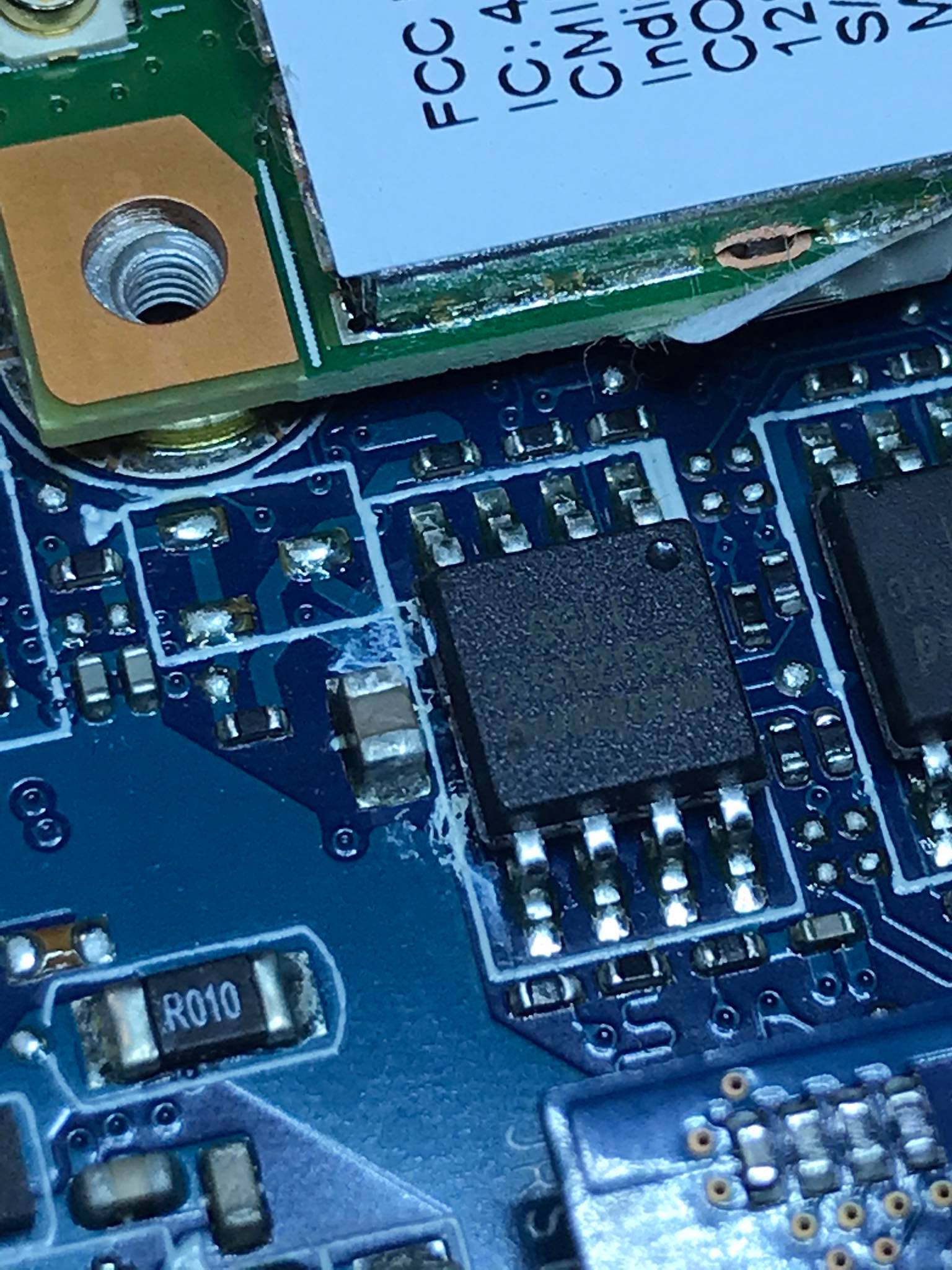

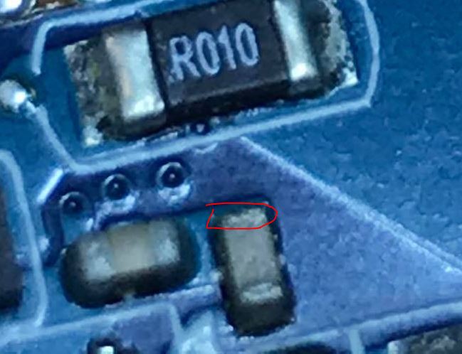

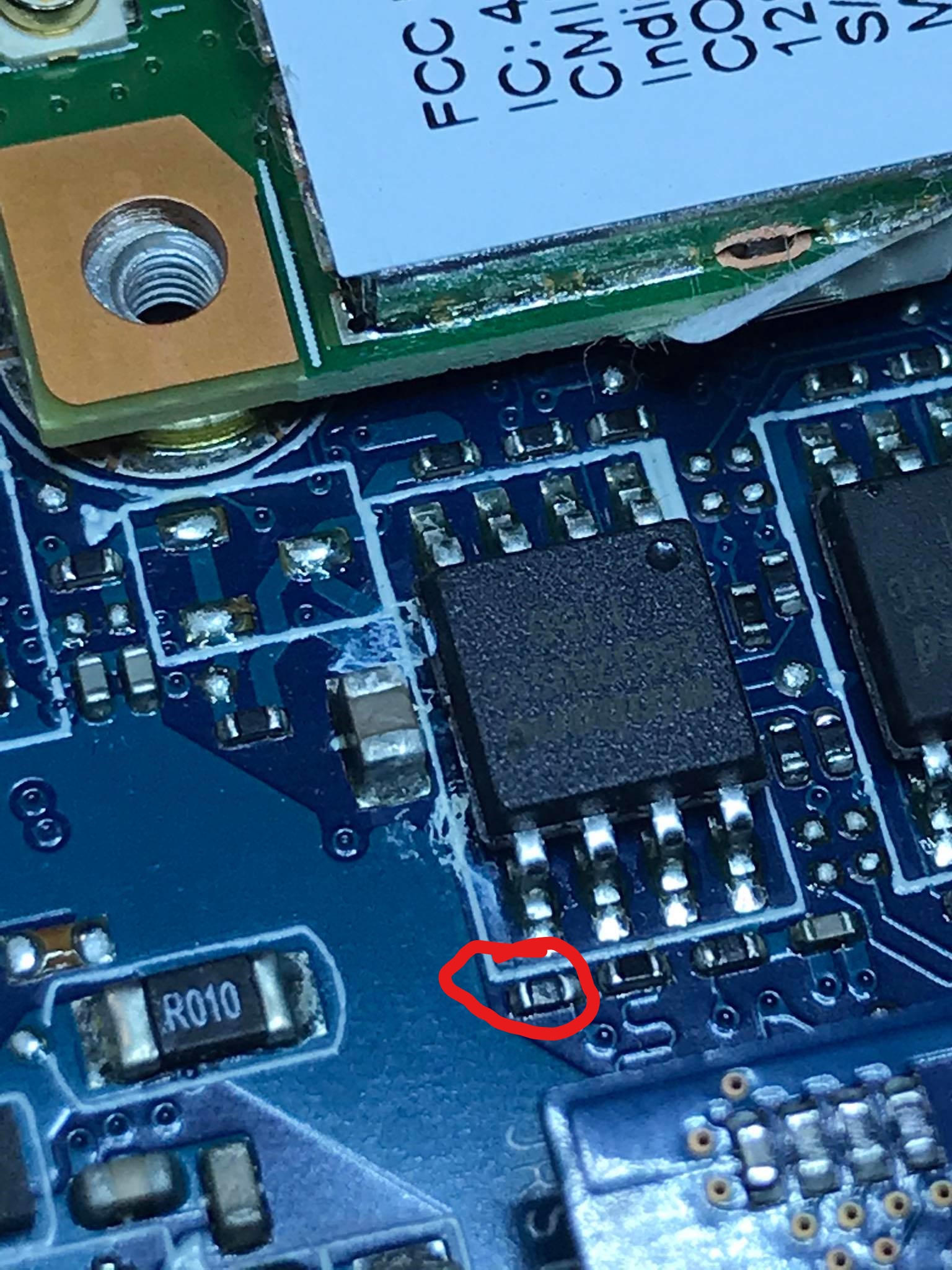

    Hi I need help for Acer JM50 Rev 2.1
    Everything was OK, I just clean with alcohol bios chips because I see some liquid and after that laptop turns on automatically when I plug charger but no video
    I try flashing bios chips
    reflow graphics chip littel bit
    reflow CPU littel bit
    Same story
    I have 3.3v and 5V in coils
    I have 1.5V in Ram
    1.1V in CPU
    0.8V in GPU
    19V in monitor display
    Any help

    Image 1 - BIOS Chip before I clean
    Image 2 - Motherboard Model

            Look over the whole board for corrosion .

              Re: Acer JM50 REV 2.1 No Video
              Thank you from everyone,
              I fix the problem
              Problem was when I clean board, first resistor was gone from motherboard and today I see that missing.
