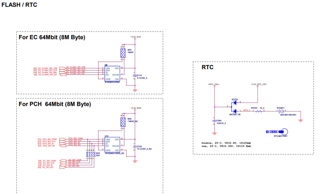

          Question.
          I downloaded the schematic.
          I saw in the board , that U10 "doesn't exist" and exists only U14.
          How can this be when the U14 is the EC rom ?

            Re: Dell Inspiron 5720 (17r) DA0R09MB6H1 - No Display ?
            I have tried 3 different BIOS (U6 Position) .
            1x Fan spins at 100 % percent , speed no image, light power on remains
            1x Doesnt' spin FAN , but power light comes on and stable stays on - no image
            1x Nothing remains dead,not even lights.
