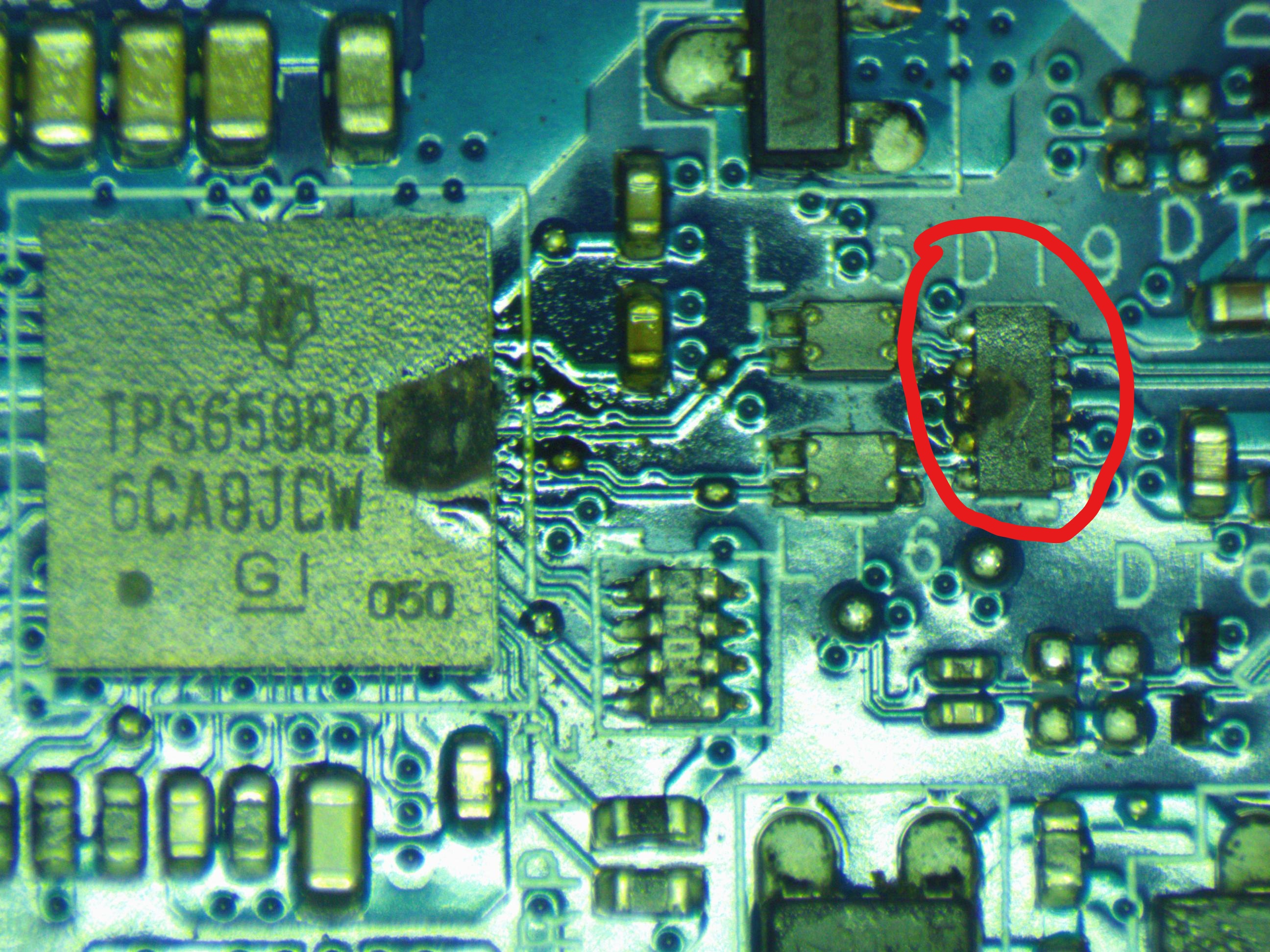

    Hello guys, I got this Lenovo yoga 720-13iKB board ID LA-E551P Rev 2.0 which is not charging, and after inspected found 2 blown chips. Could anyone here help me identifying those 2 IC one of them has only the last 2 letters missing, Please see the pic and help me with this. the one that it is circled red is the one that has nothing and the texas instruments one is the one that has only the last 2 lettersmissing.thanks.

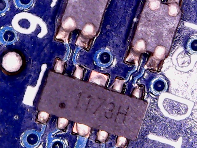

      1173H
      i got the same laptop 30 min ago.

          your EC chip seems damaged too (the TPSxxx) without it your laptop won't negociate the 20V, well I suppose the charging is via USB C in this case.
          the 1173H is more linked to USB data i think.
