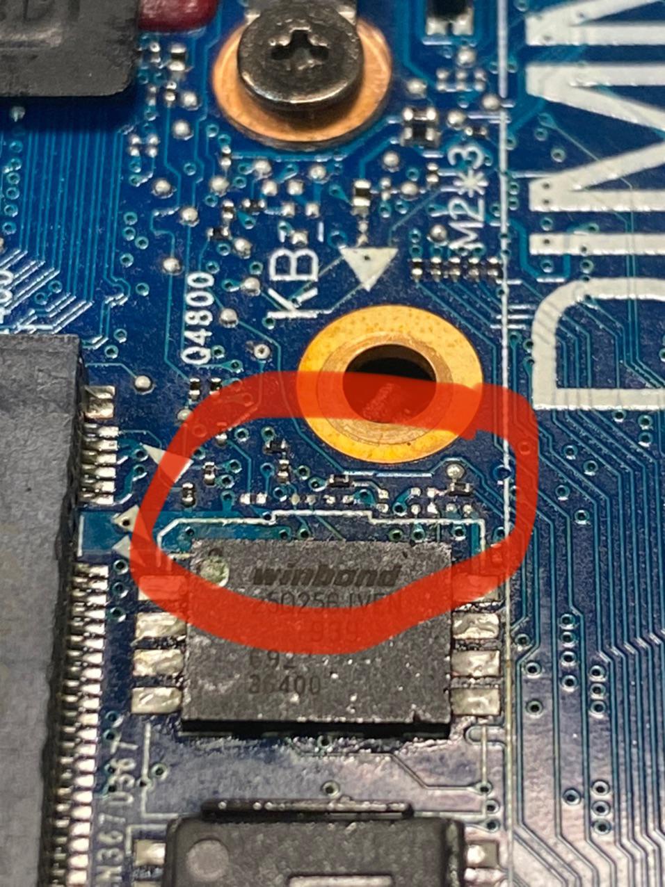

    need some help by mistake remove some resistor on board can some one share a pic to see layout

        What is missing resistor ohm

                Hi, I have the same problem one resistor missing near the BIOS chip and would need the value of the resistor. Could some one please help?

                  Try a resistor within 15-33 ohms range.Say 22 Ohms
