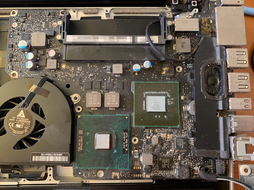

    I have one MBP 13" that started to refuse to boot.
    Two months ago the WiFi chip stopped working but that was solved by putting a Wifi USB dongle (the Aliexpress Wifi Module is on it's way since early April).
    This weekend the MBP didn't started. When pressing the power button I saw some activity (the led was on and I got the DVD head sound, but black screen and no chime).
    After some time I've replaced the current DIMM's (1 original 2GB PC3-8500 + 1 PC3 10600) that have worked without issues since 2012, with new DIMM's.
    Then the weird stuff started to happen.
    When using only PC3-8500 DIMM's (from another Mac that is working great) there is no boot.
    When using only new PC3-10600 DIMM the MBP boots, I get the white screen with the Apple logo and the progress bar goes up to 60% and then it starts to loop reboot.
    I've opened the MBP, made visual inspection and the only thing I see is there are some dry solder joints on 2 inductors (L7400 and L7401) that power the CPU, but I guess it's not related to this problem.
    My wild guess is there must be some capacitor which is malfunctioning and driving the DIMM voltage to a level that the PC3-8500 don't “like”, but I cannot find where to look for.
    Any suggestion is more than welcome.

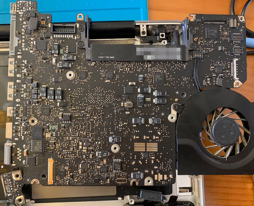

      Re: Macbook Pro 2010 13" A1278 (EMC 2351) boot loop
      I know I need PC3-8500 for it to work (I've been using one original DIMM to trick the chipset to lower the frequency for quite a few years now).
      I've tried 3 different PC3-8500 modules from a working Mac but this motherboard refuses to boot with all of them.
      I've reset the SMC (with keyboard and by removing the battery) to see if the chipset would start to collaborate, but this MBP now only "likes" PC3-10600 DIMM's.
      I'm adding some photos of the motherboard.

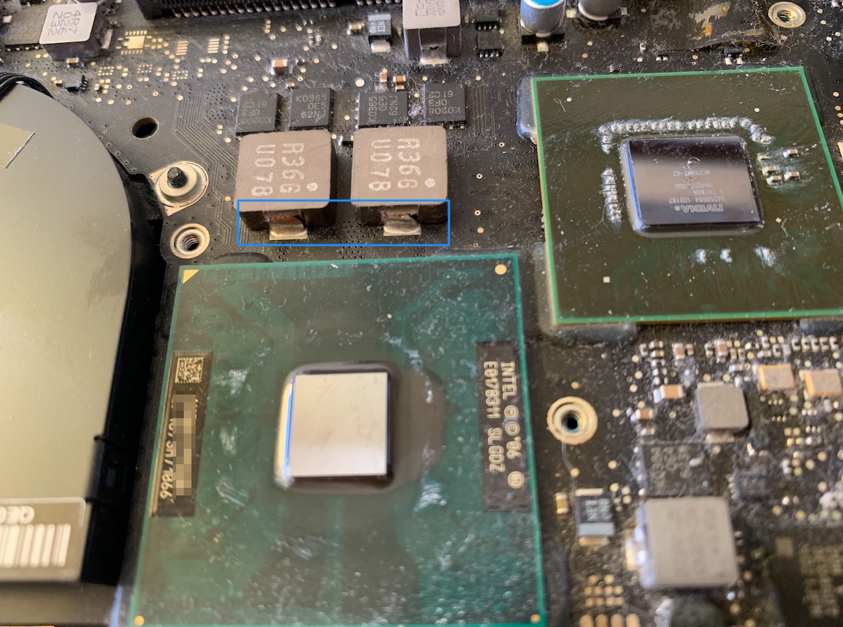

        Inductors look ok.
        Did you try PRAM reset as well?
        Motherboard is pretty dusty so always good to clean that. Note that if you are in a high humidity environment, dust can catch the humidity and disturb signal lines. Remove the speaker as well.
        Dust can also get into the RAM slot and cause weird problems.
