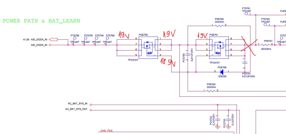

    Hellow to all
    I have a problem with Asus X51RL.
    It does not turn on.
    I have the schematic but I can't understand why the second switch won't open!
    On pq5700 pins 5,6,7,8 = 19.47V; pins 1,2,3 = 19.17V; pin 4 = 18.9V

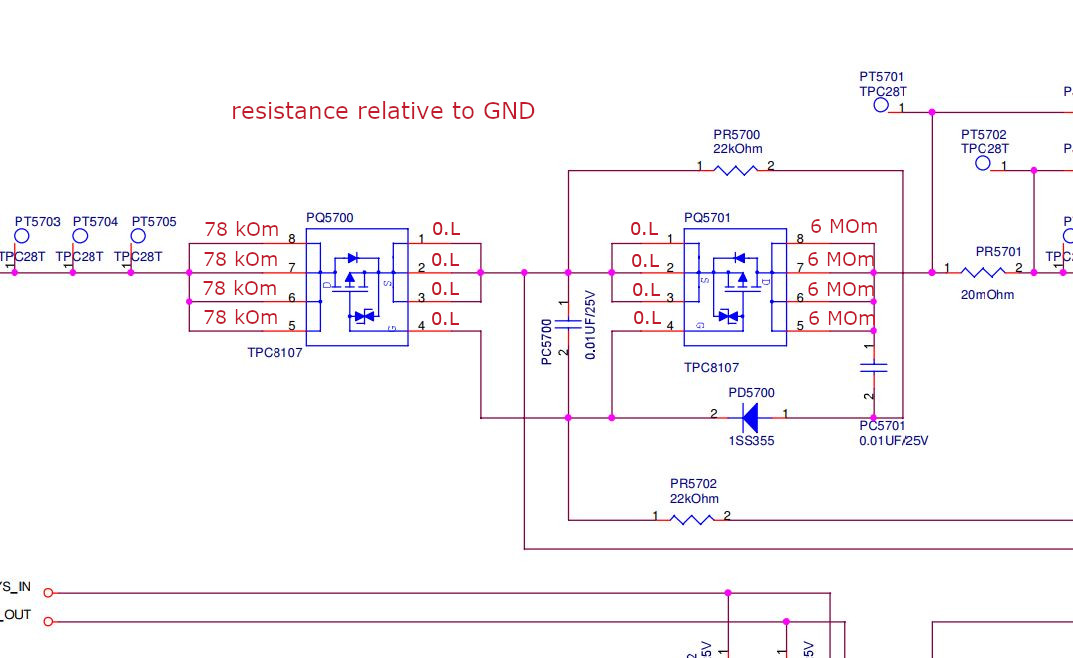

    Re: Asus X51RL REV:2.0 ; pn:08G2005XL20J - won't turn on!
    measure resistance on pins of PQ5701 relative to GND.

      You need to measure PQ5700/5701-Source to gate, Source to Drain, Gate to drain.
        pic 002
          PQ5700
          S->G = 0.L
          S->D = 45 kOm
          G->D = 1.8 MOm
          PQ5700
          S->G = 1.46 MOm
          S->D = 2.50 MOm
          G->D = 4.20 MOm
              Originally posted by smaniak
              PQ5700
              S->G = 0.L
              S->D = 45 kOm
              G->D = 1.8 MOm
              PQ5700
              S->G = 1.46 MOm
              S->D = 2.50 MOm
              G->D = 4.20 MOm
              Both fets labelled as PQ5700?? I beleive the top one is PQ5700 and bottom one is PQ5701. If it is correct, Replace PQ5700.

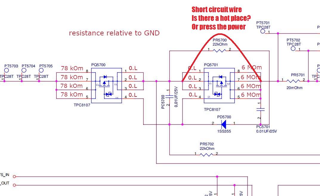

                Originally posted by z3h1r
                Try
                This way you may have power on and display but battery wont charge.
                  Yes true. Test only.
                    Try
                    If I short PQ5701 (1,2,3 with 5,6,7,8), power adapter go to safe mode and turn off.
                      There is a short circuit on the motherboard. This is mostly a capacitor.
                      Find the hot area.
                      Use a laboratory power supply. https://cdn-reichelt.de/bilder/web/x...KD3005D_01.png
