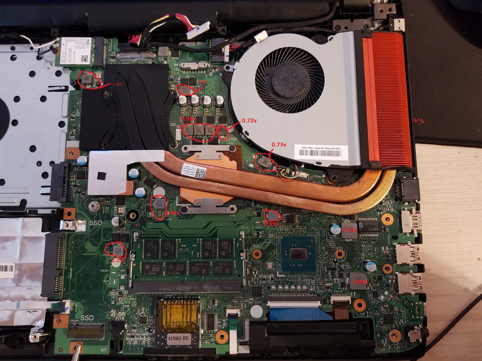

    GL553VE Problem
    mesurement s , any ideas ?bios or something bad ?
  • peste
    • Dec 2016
    • 12973
    • ROMANIA
    Re: GL553VE Problem
    test with another RAM, lightly heat the video chip, use the flux paste, and with great care, remove everything from the board for testing (battery, wifi, hdd, keyboard, etc).

      GL553VE Problem
      Ram ok, is dual video normaly should start even if the gtx is dead, tested also with everything out only mb with hdmi .
      It s eat abou 1.3 _ 1.5A on power supply.
      I will try to identify from boardview test points for plt rst, ram rst etc.
      Boardview - https://www.badcaps.net/forum/showthread.php?t=71745
