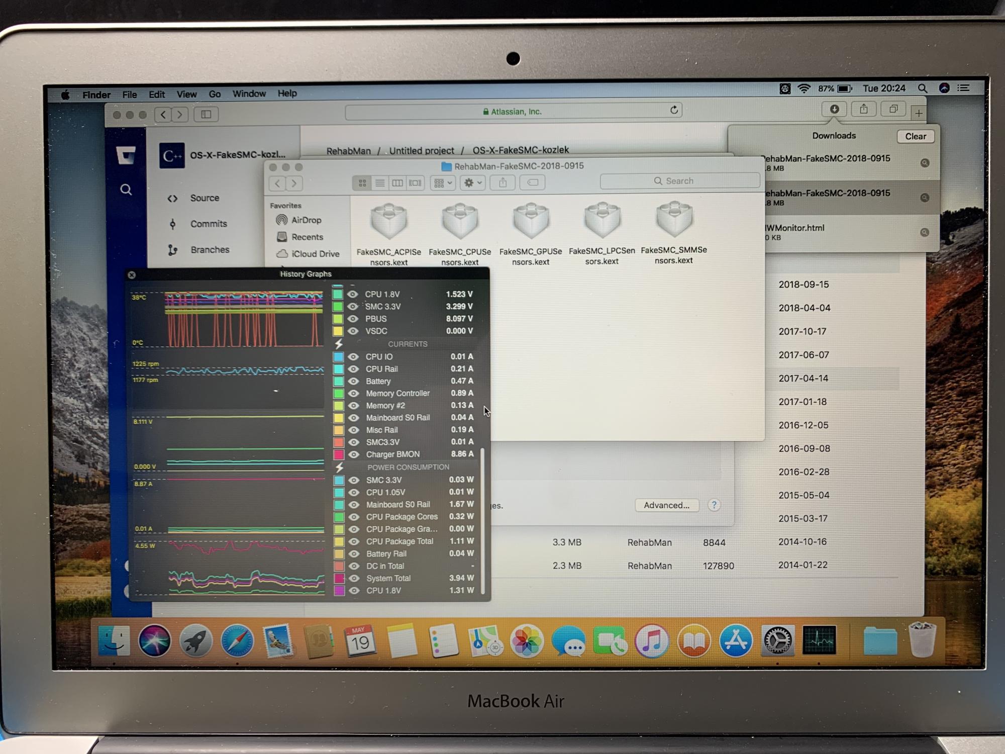

    I have a MacBook Air 2017 820-00165A with a high CPU kernel_task even works with IDLE. It has been poured the liquid inside before but I cleaned it all. Everything works fine, no short ground or missing voltage but works abnormally. CPU always works more than 70%, make the computer slow down. Tried many times to reset Pram, Vram ad nothing happened. Can you give me some ideas?

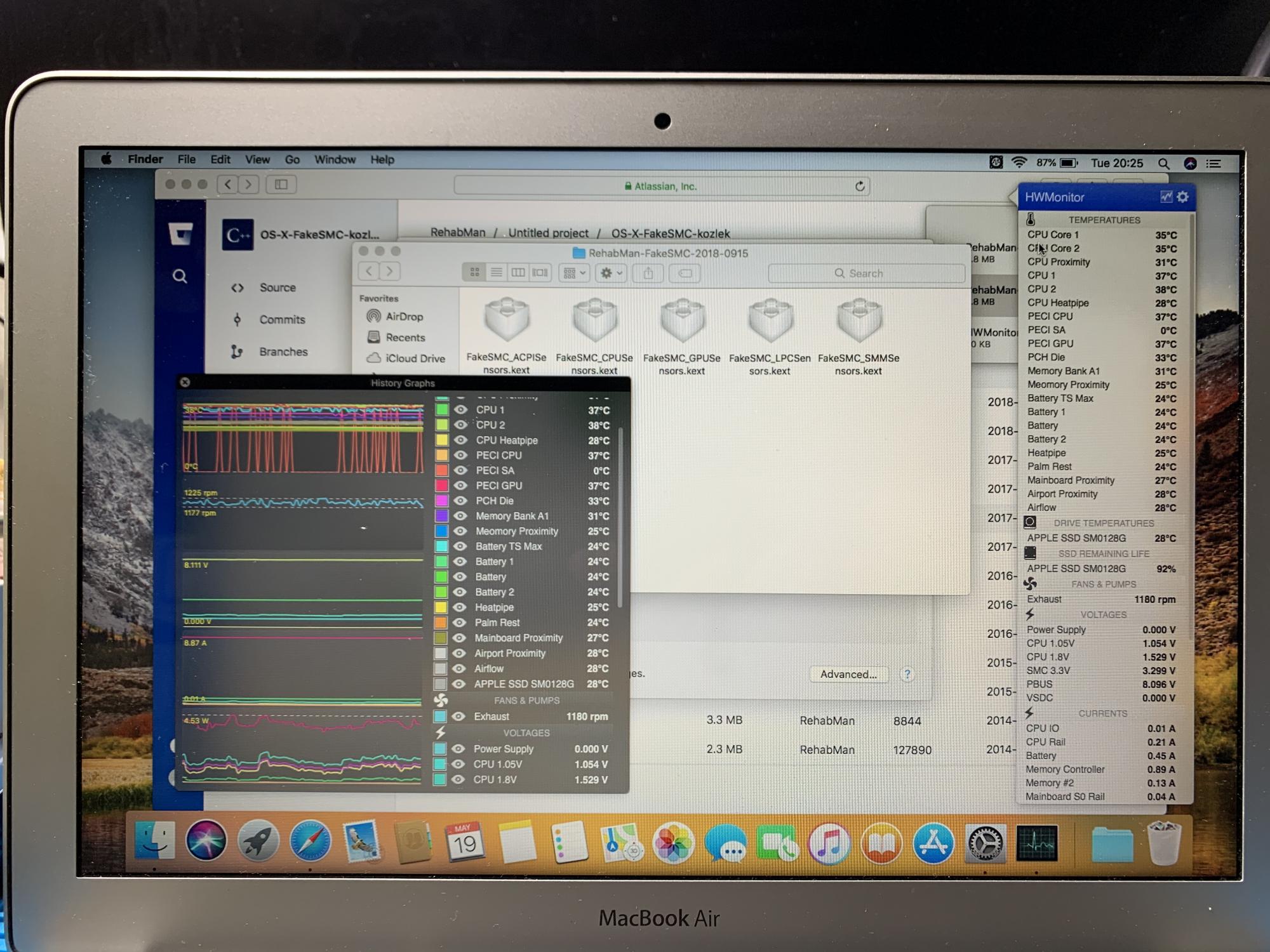

    Run latest version of HWMonitor ( https://bitbucket.org/RehabMan/os-x-...lek/downloads/ ) and post a screenshot.

      The liquid poured around the battery connector. This is the information that I've got. Thanks in advance

              Nothing happened with AHT. I will try to replace U7100 today, the charging current fixed with 3amps all the time.
                Re: Macbook air 2017 high load kernel-task on Idle
                The U7100 caused this problem. Thank you
