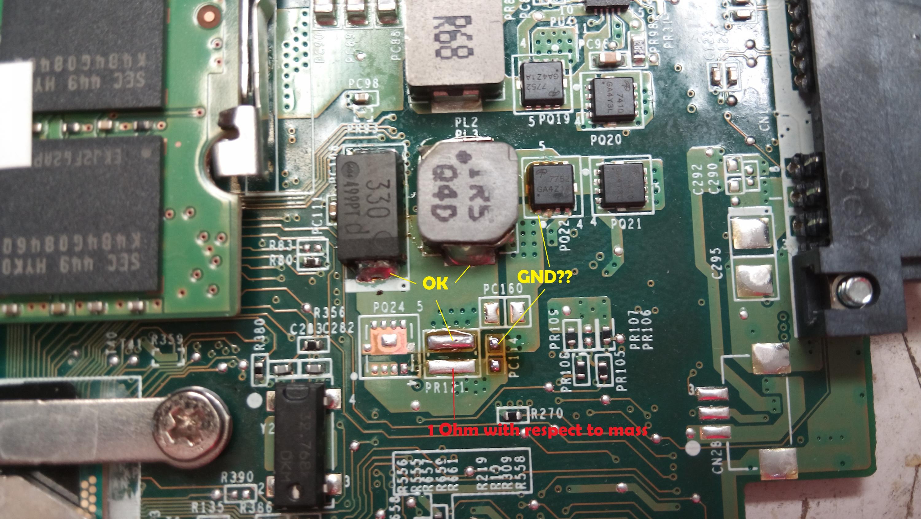

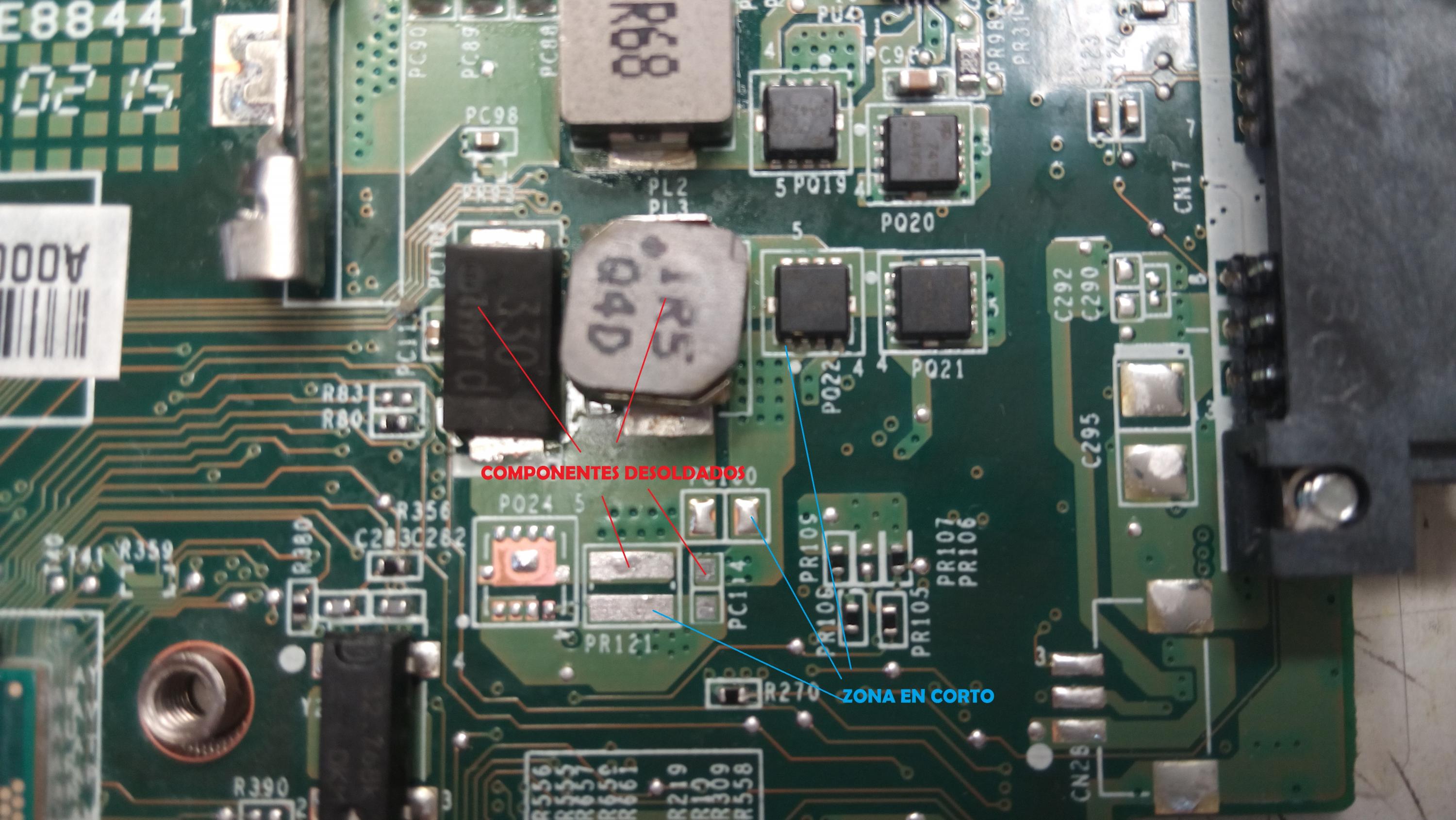

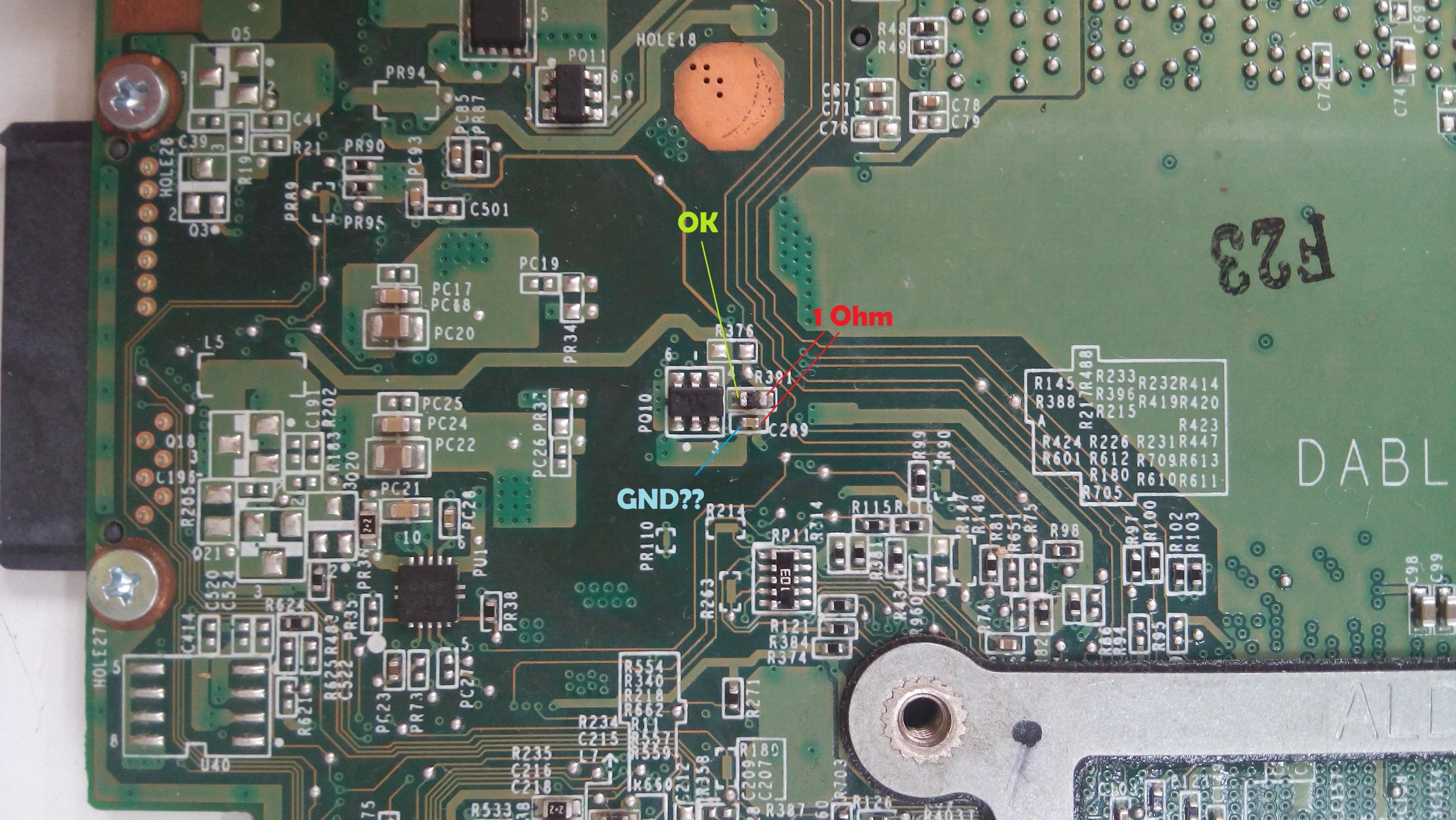

    Hello everyone!
    The laptop was working perfectly, but after disassembling it to clean fan and change thermal paste, the laptop does not respond to power. 3V and 5V are present.
    The laptop has a Quanta DABLIDMB8E0 REV board. E, of which there is no available scheme, or at least, I have not found it.
    After consulting another website, other users had a problem with burned R391 and corrupted KBC NPCE985LA0DX. In my case, in the area of R391 the protective plastic was perforated from overheating. After checking the area, on one side of the resistance there is continuity with respect to ground and on the other side it is not. In KBC, on pin 4 (VDD), I also have continuity with respect to ground. After removing the KBC, pad 4 on the motherboard continues to short circuit to ground.
    I have desoldered C222, C227 and C289 next to R391, and the short continues on pad 4. Only the short disappears when I lift R284 ...
    Trying to delimit the area in short. I have found PL3 short with respect to mass and I have raised the components of the zone PC114, PR121, PL3 and PC108, to find out which side is the short circuit, which I indicate in the second photo.
    On the opposite side of the motherboard, I have PU1 with the Q48Y 5318 screenprint. Can anyone tell me which one to look for the datasheet?
    Any help please?

    What's the resistance to ground on PL3?
    Did you try to inject 1V on PL3 and find a component that's heating up? (especially PCH die)

      Hello, thanks for the answer.
      The resistance in PL3 with respect to mass is 0 Ohm.
      I tried to inject 1V into the line but no component got hot

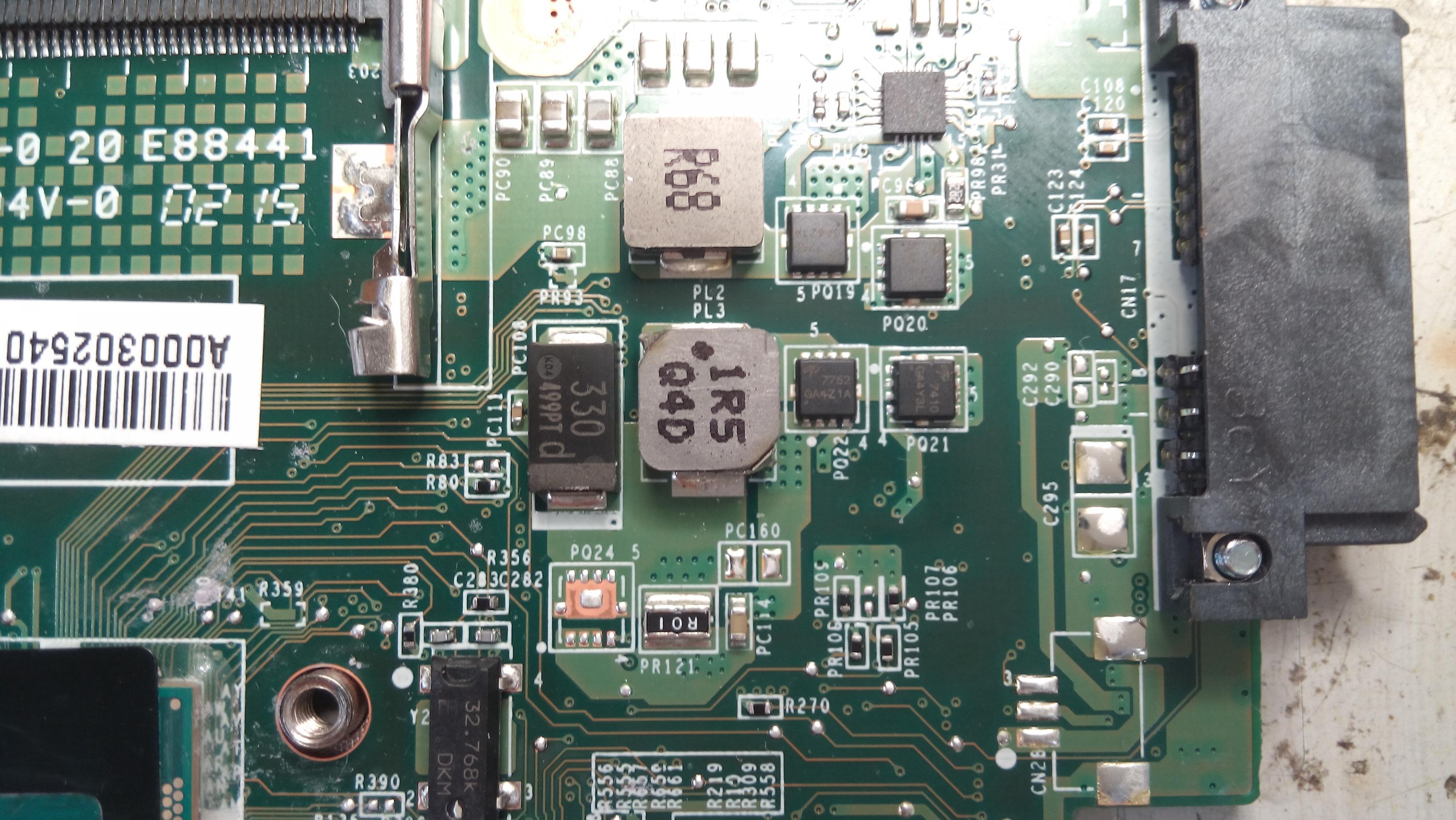

        Re: Toshiba L50-B DABLIDMB8E0 REV. E no enciende - No turn on
        With PR121 soldered on motherboard, I have short circuit in D-C of Mosfet PQ22.
        When I lift PR121 the short circuit disappears in PL3 and in D of PQ22.
        With PR121 removed, S continues shorted to PQ22
        On PC114, on the side next to PQ22 I have 0 ohm, and on the other side next to PR121 I have 1 ohm
          Hello zemog:
          If the SMD capacitor PC144 has 0 ohm to GND on one end, and 1 ohm to GND in the other end, then this capacitor could be shorted. Please unsolder it and test both ends of the capacitor and measure the ohmios. Also test the both pads on board of the PC144.
          If the SMD capacitor off board meaure 1 ohm on both ends, then it is shorted. Else, measured both pads, on board, of PC144 and measured which pads have the short.

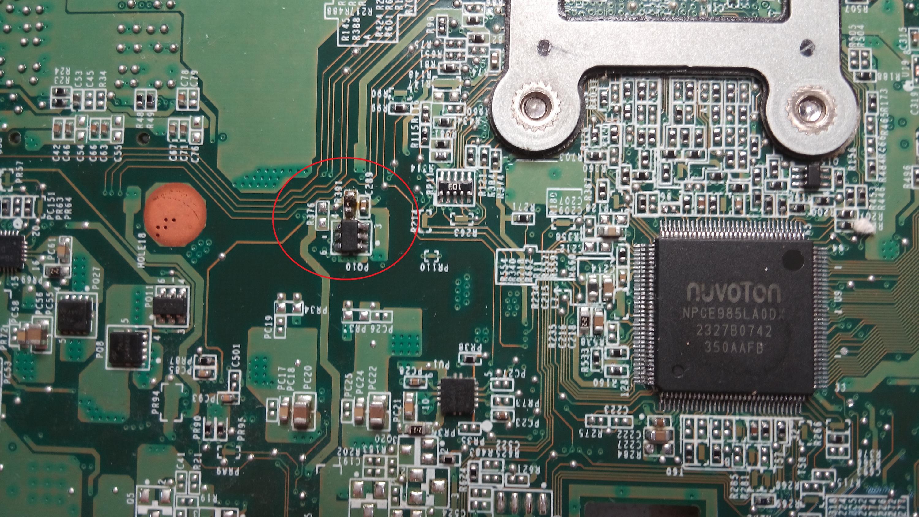

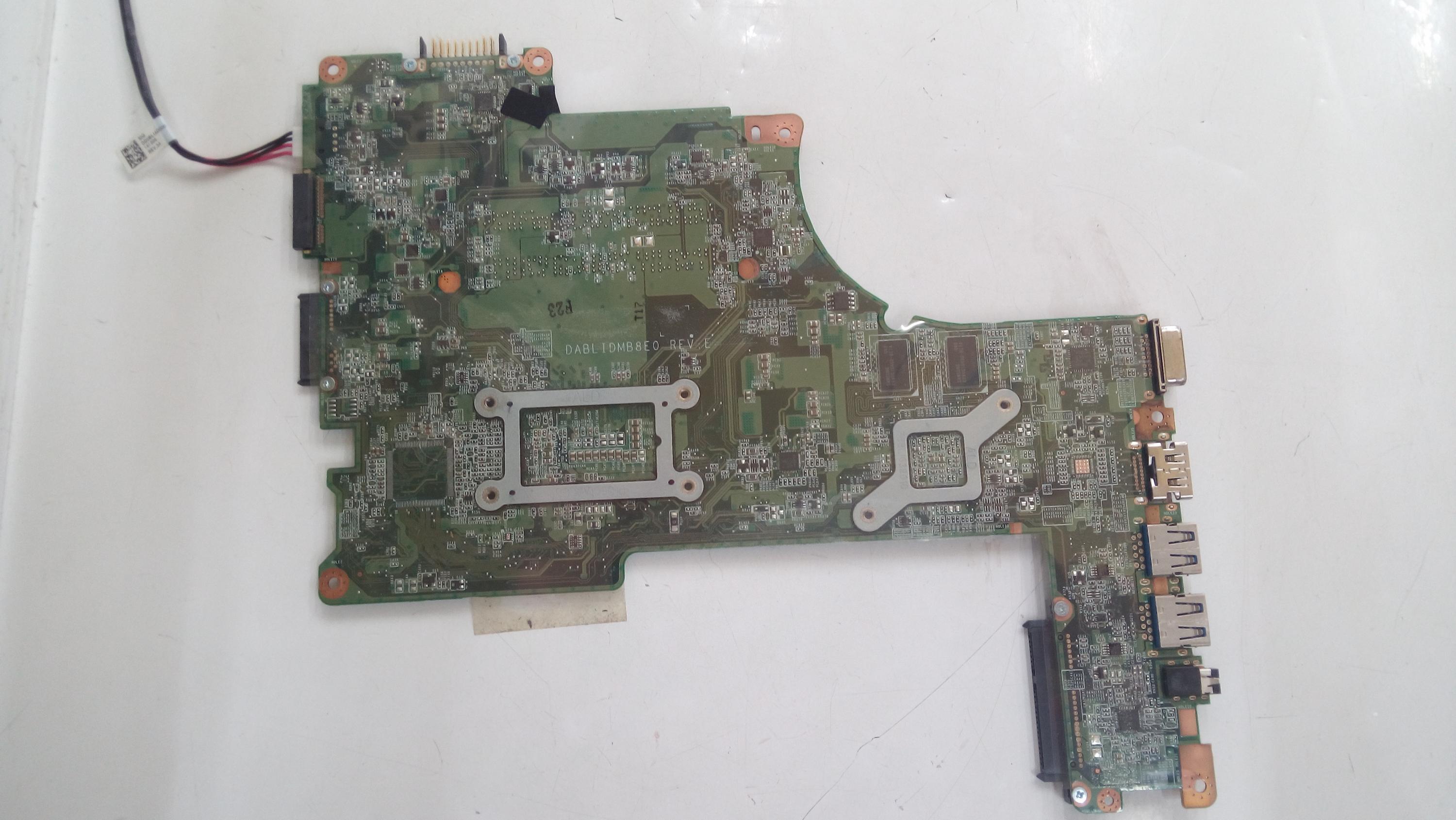

            Hello!
            Yesterday I received the new KBC that I had ordered and I have soldered it.
            I guess when you mention PC144, you really mean PC114, right?
            I attach photos with the different measurements with respect to mass.
            When PC114 is removed, the short stays on one side of PR121, just like R391 (Zone with overheat mark on the protective plastic of the motherboard)

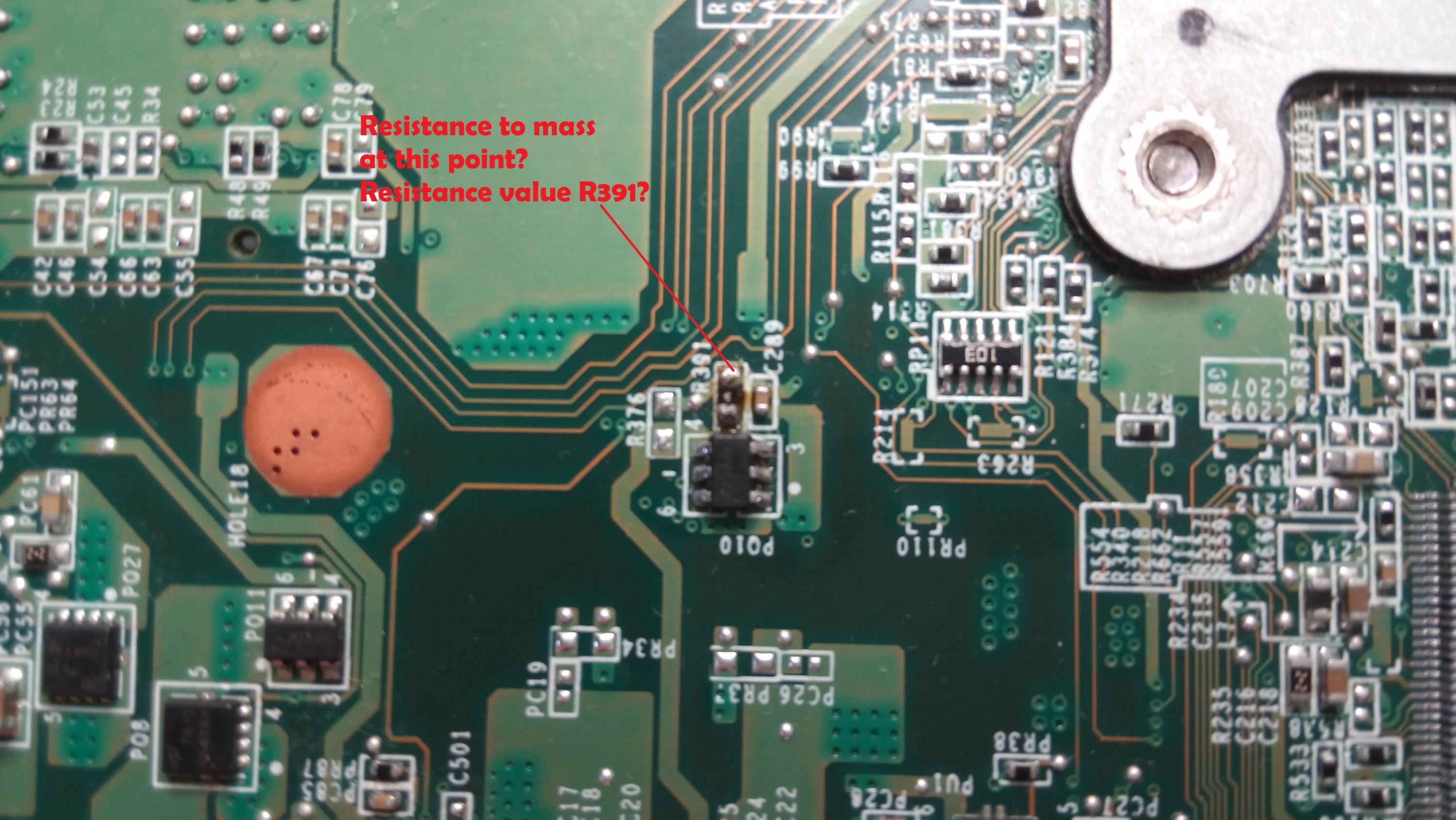

              With R284 removed from the motherboard to isolate pin 4 of the KBC, can I inject 1V in that line, and if it does not heat any component, increase it to a maximum of 3v?
              • zemog
                • Mar 2020
                • 8
                • España

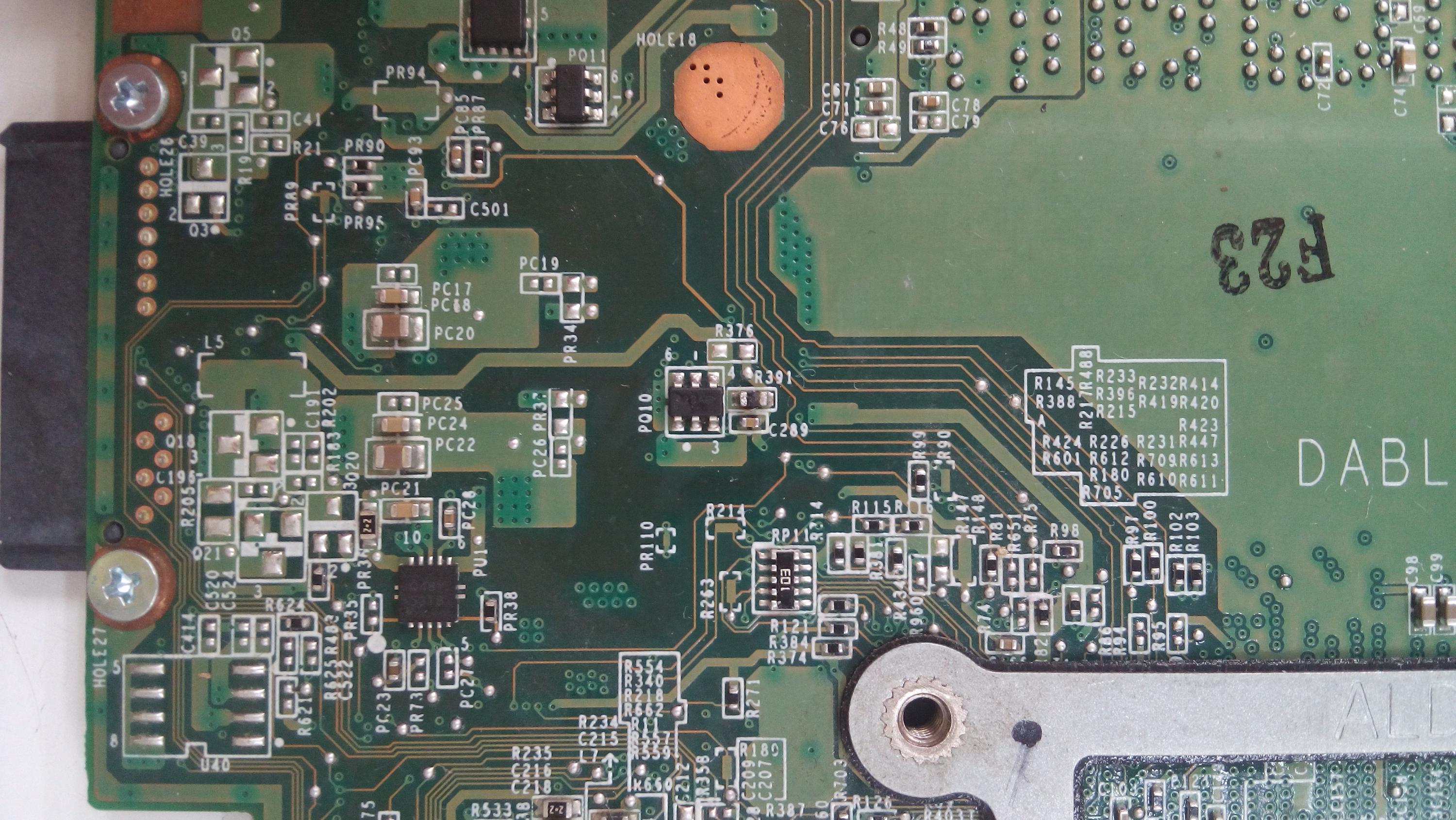

                Can someone tell me the value of the resistance R391 and C289?
                What resistance with respect to mass is there at the indicated point of R391?
                If possible, what voltage should there be at that point?

                  Expect a dead processor. (100%)
                  R391 0ohm small coil
