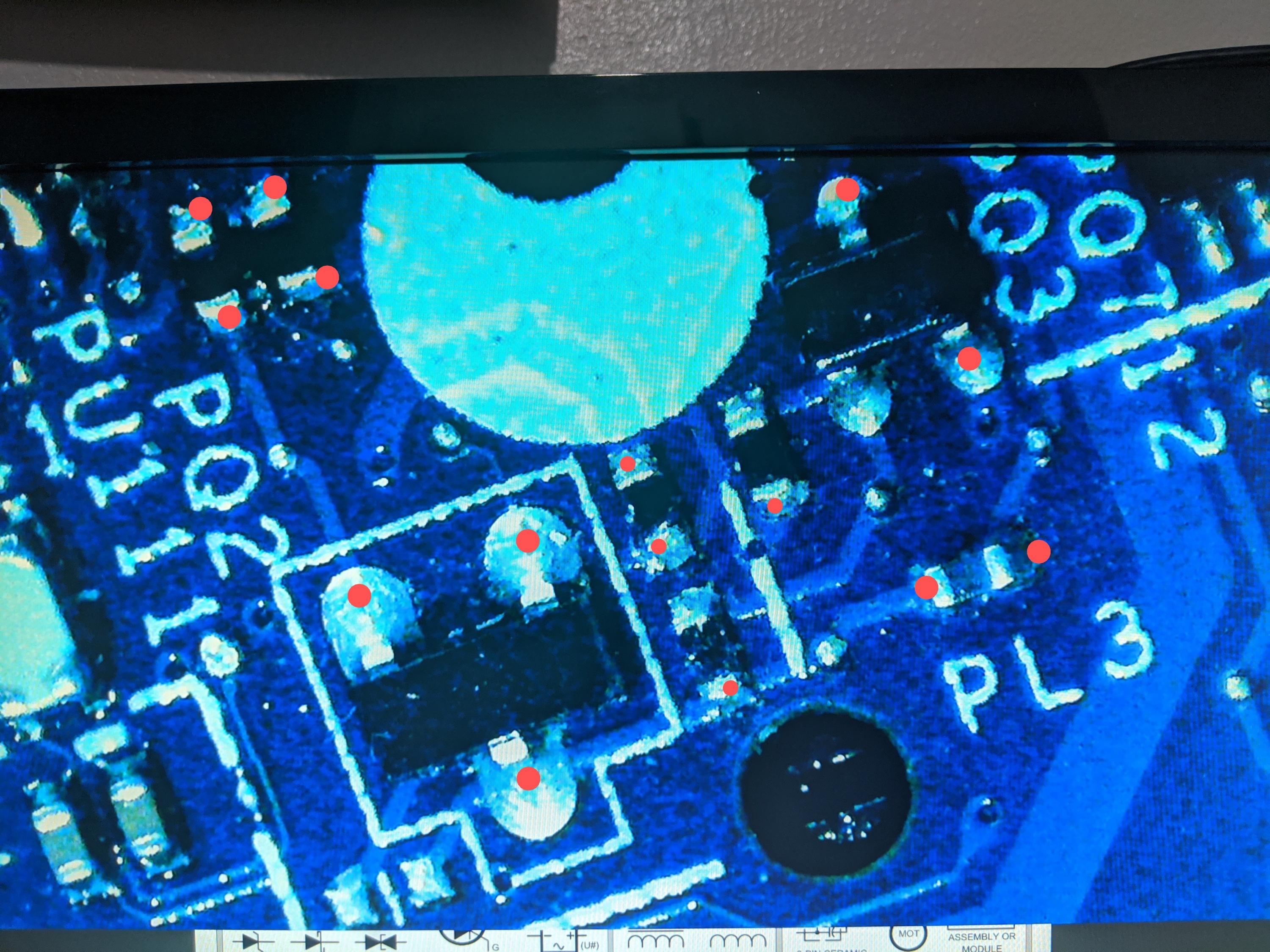

            When is on it looks like short coming from A37 #PSID_DISABLE cannot find PR13 and PR11 to check them.
            Boardview will be amazing for this.
            When is LCD connected short is on: PQ2 - all pins, PQ3 - 2 pins , PL3 - both pins. I marked all points with short around PQ2 and 3

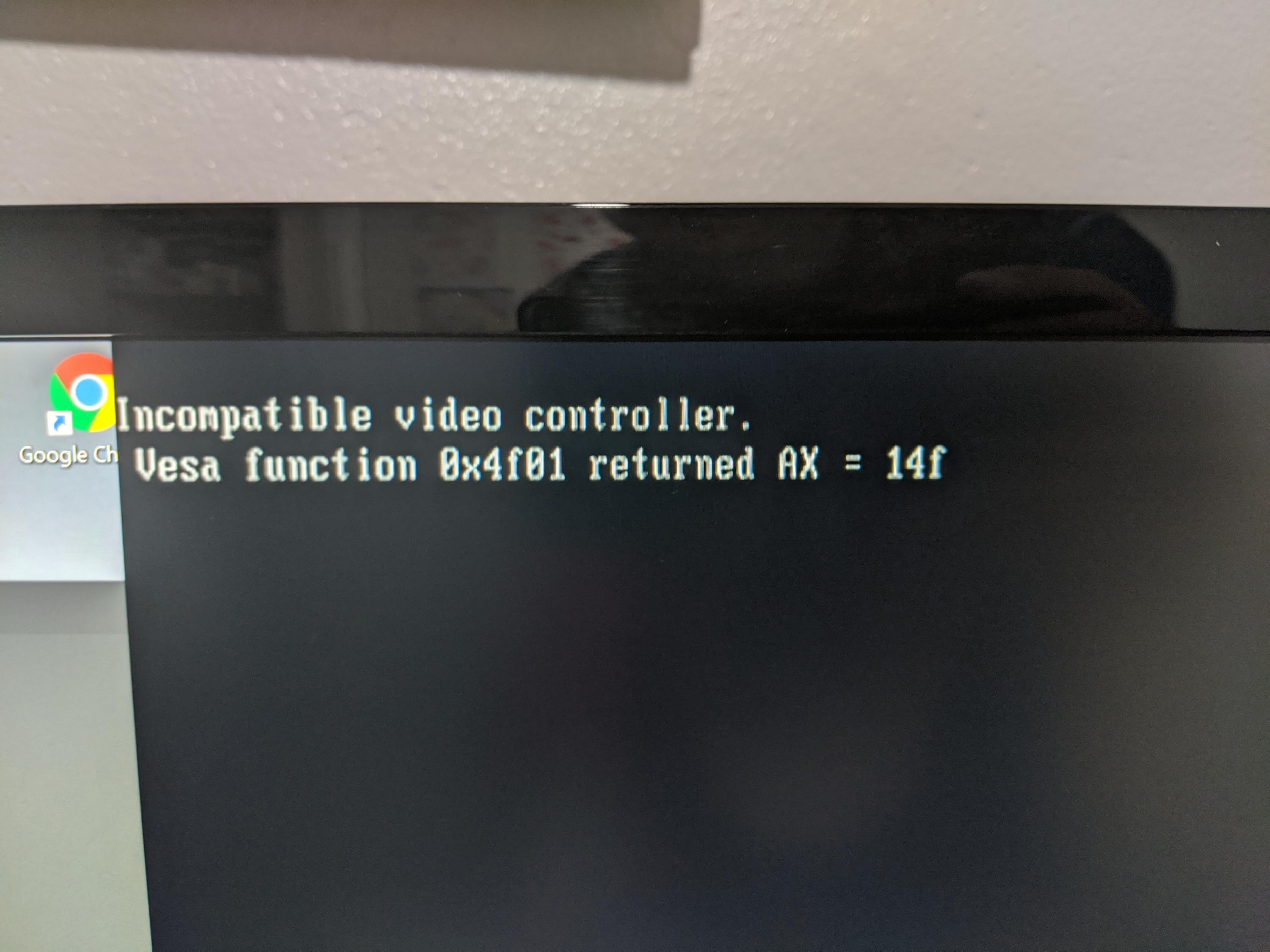

            If I run laptop without lcd connected it not short to ground anymore, but I cannot enter to bios when I connect monitor via HDMI and try to enter bios its showing this error:

              Pretty weird, remove the bridge between pin 3 and 4 of the PU111 and find out where is the short on pin 3 or on pin 4, looks like water damage motherboard layer problem.

                PD5 is no stuff.
                Short to ground must be measured with all power source disconnected. Measuring it with power makes no sense and risk damaging components.
