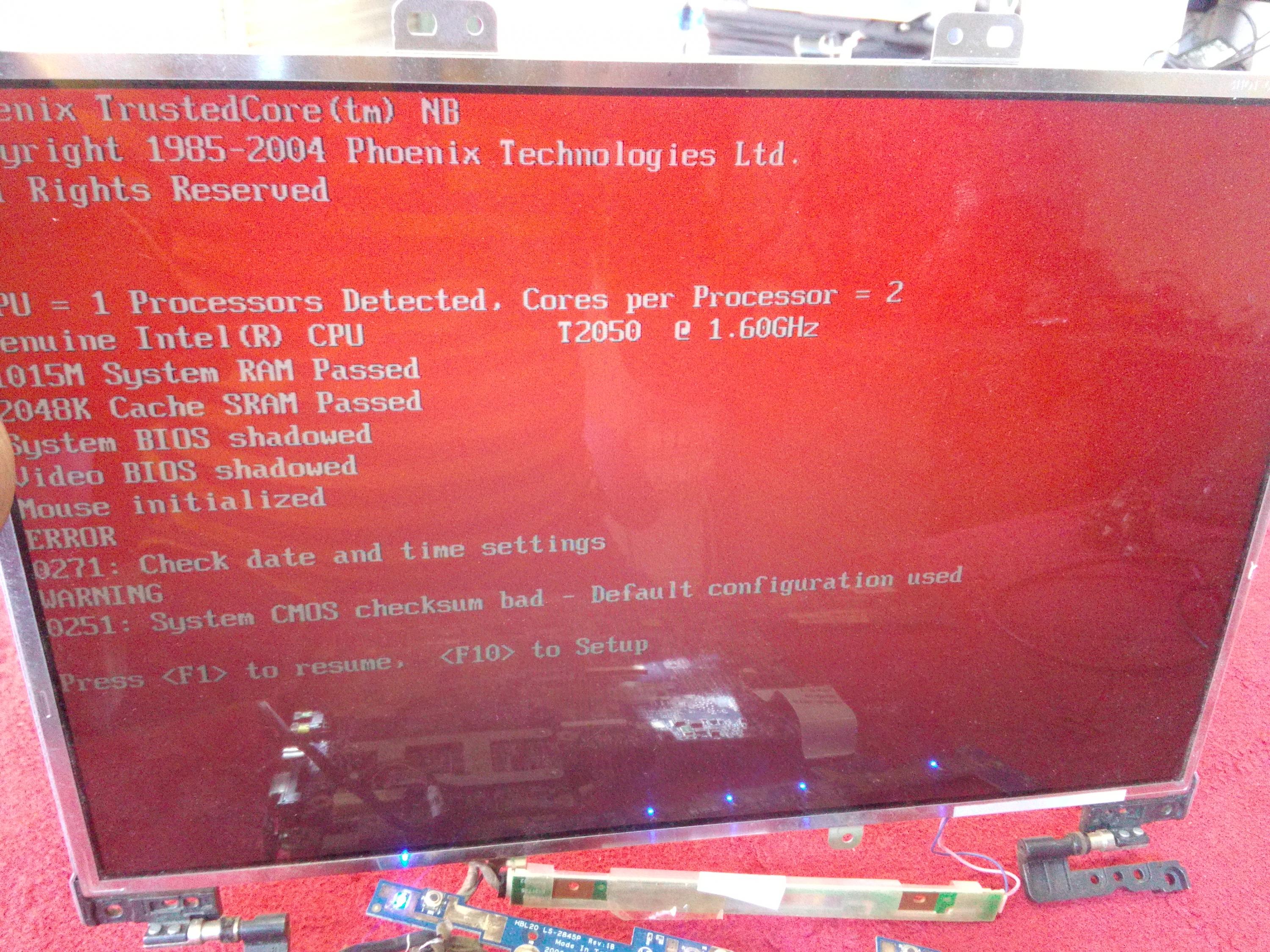

    Hy all tech friends, I have Hp hbl10 La-2841p display red color problem. I changed the display, and check lvds cable pinout ........all have ok.......
    After the external monitor vga have ok.......no red color problem......
    I attached the schematic and image of the problem
    Help needed........... Thanks in advance....

    lvds cable is likely broken.

      I changed this board power ic ,,,,,,thats why its problem happen ???????

        No and very unlikely. I'll still bet for broken LVDS cable.
