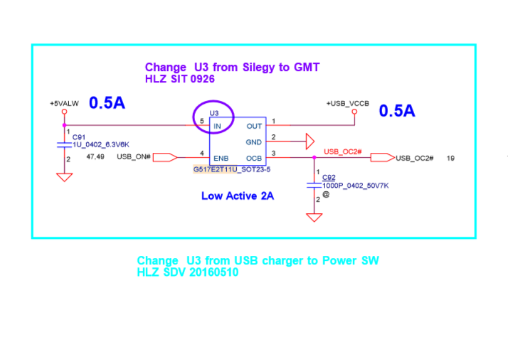

    I have this motherboard, in which a friend of mine put the charger in the usb port ... I already detected the anomalies by the diagram, I have the southbrigde in short and the ic G517E2T11U_SOT23-5 also burned, the suppose I / O looks good, my question is that I can't get this IC - G517E2T11U_SOT23-5 for sale, does anyone know of any compatible...
    Image schematic = anex
