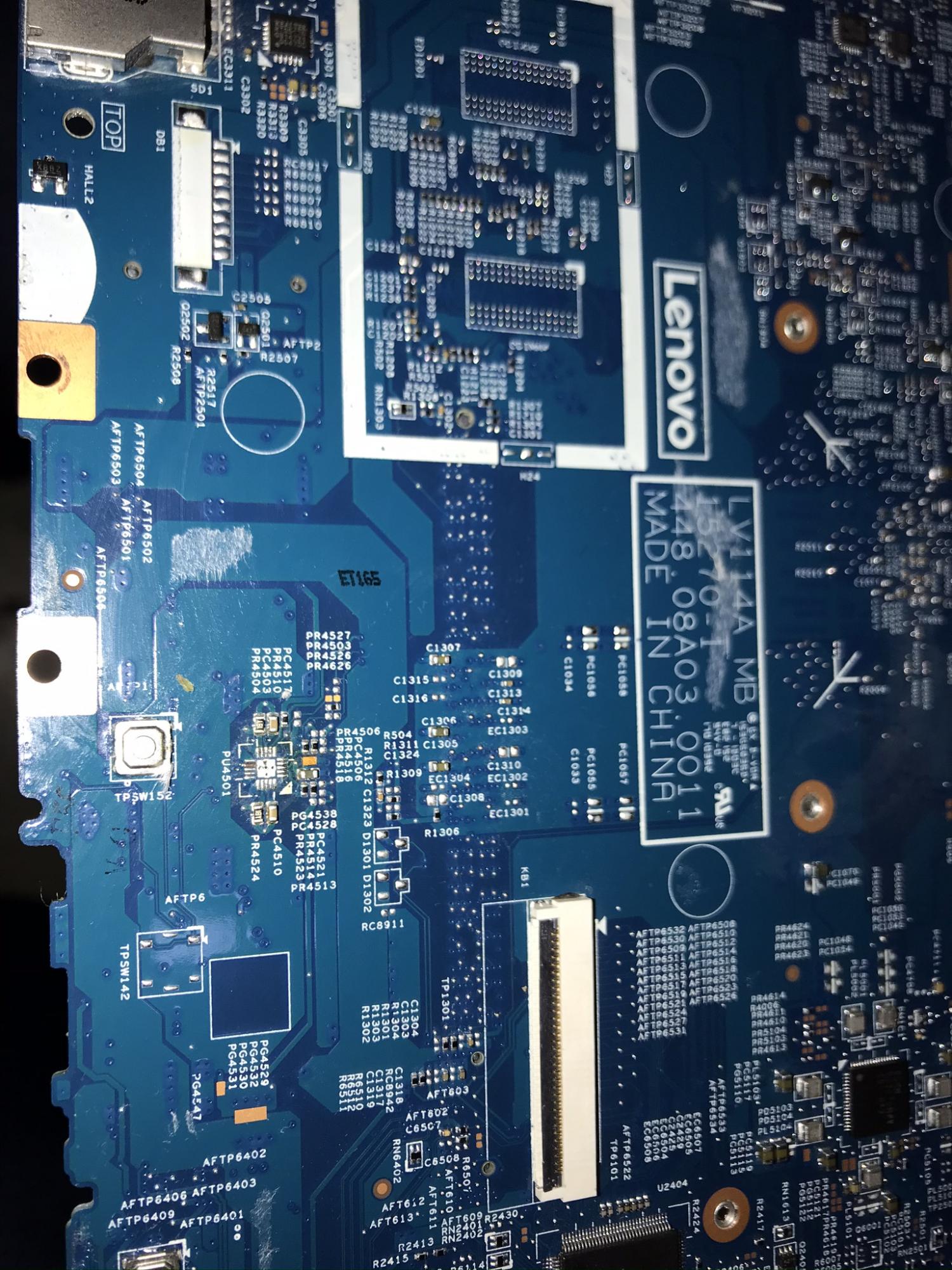

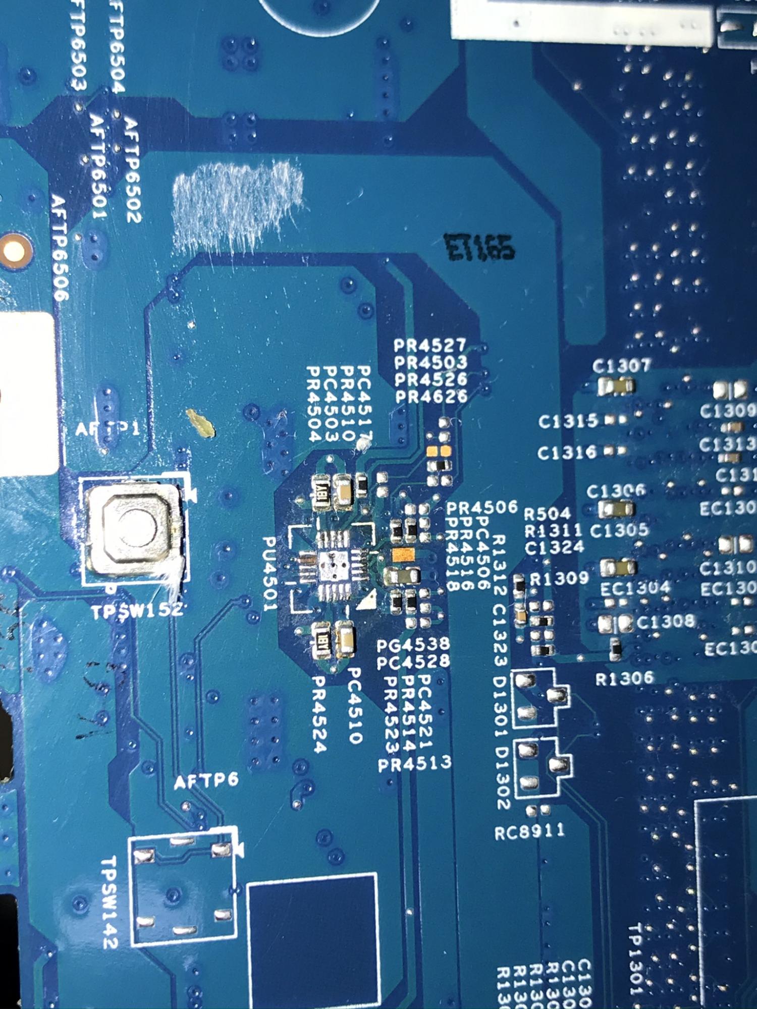

    hello, I have a notebook lenovo ideapad v110 lv-114 mb. It burned an integrated pu405. Any replacement for that chip?
    thank you very much for any help

    Can u read anything on the ic?? If yes, then tell us

      5X=3K .Richtek RT6575DGQW(PU4501)

        Re: Lenovo V110 die help
        the ic is fully carbonized
          thanks. I'm going to look in another motherboard if there is one, in my country it is difficult to bring something from China

            another substitute Tps51225C
