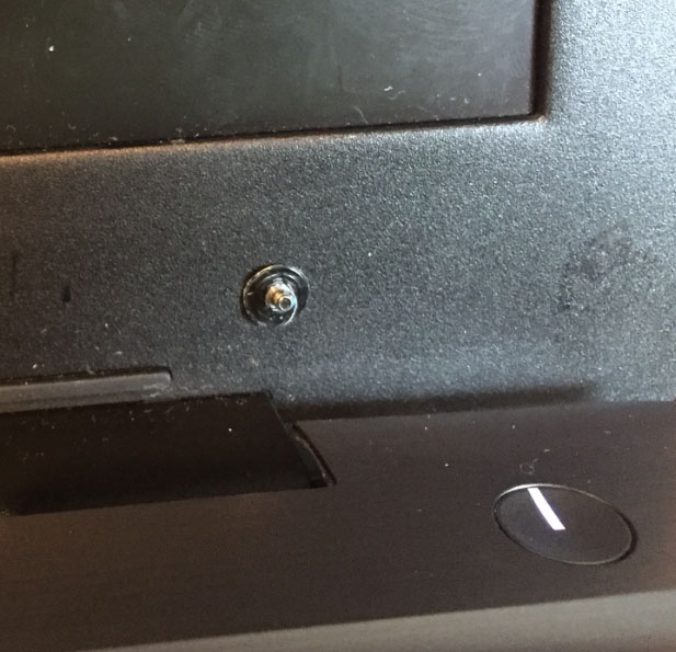

                  The easiest way to identify lid switch is to look where magnet on the screen panel touches motherboard-it has to be near the area where magnet touches the base of mb. However, screen going blank and resuming on powerswitch press is likely to be a lid sensor issue but that still cant explain screen going blank after intel hd driver installation.
                  • m3g4tr0n
                    • Aug 2011
                    • 88
                    Re: Dell Inspiron 5567 Black Screen after installing Drivers
                    @mcplslg123
                    magnet is at the bottom right of the screen near the power button.

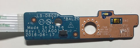

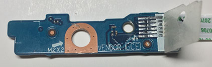

                    it's hard to see any corrosion as the board was cleaned by the owner. i could see some corrosion inside the power flex socket.
                    did some voltage tests on the power button pcb flex cable (not on the motherboard connector)
                    when laptop was off
                    Pin
                    1 0v (3valw)
                    2 5v (white_led_pwr)
                    3 0 --x
                    4 3.1v (power_sw#_mb)
                    5 0.8v (lid_close#_c)
                    6 0.07v
                    should pin1 not be 3v all the time. im getting that on pin4.

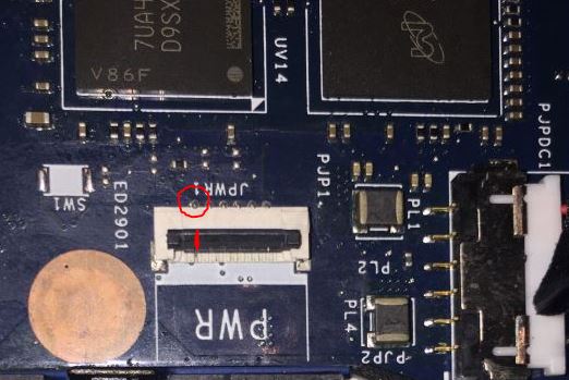

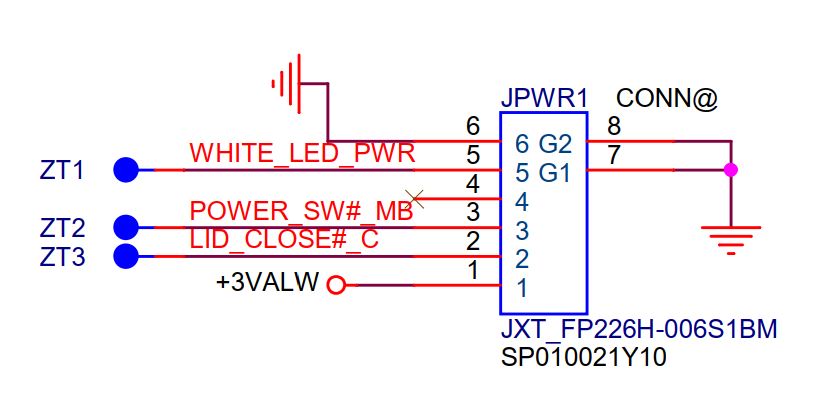

                        took some voltage measurements on the mb connector this time
                        Off
                        1: 3.3 (3valw)
                        2: 0.8 (lid_close#_c)
                        3: 3.1 (power_sw#_mb)
                        4: 0 (nc)
                        5: 0.2 (white_led_pwr)
                        6: 0 (gnd)
                        On
                        1: 3.3 (3valw)
                        4: 0 (nc)
                        5: 5 (white_led_pwr)
                        6: 0 (gnd)
                        the 3valw pin is missing on the connector.

                          So your lid switch is on the power button itself. Measure voltage on all pins of Lid switch or you can remove the lid switch and test whether display going blank & resuming on power button press problem is resolved or not.
                            problem was the 3valw, it was missing on the connector.
                            I put a jumper from the motherboard to the power button PCB and laptop is working fine.
                            Thanks everyone.
                                  Just to recap : Pin 2 should be 3.3 V when door is open and 0V when closed. This message goes to pin 41 from UE1 chip as signal LID_CLOSE#. At least on my Dell Inspiron 15-5567
