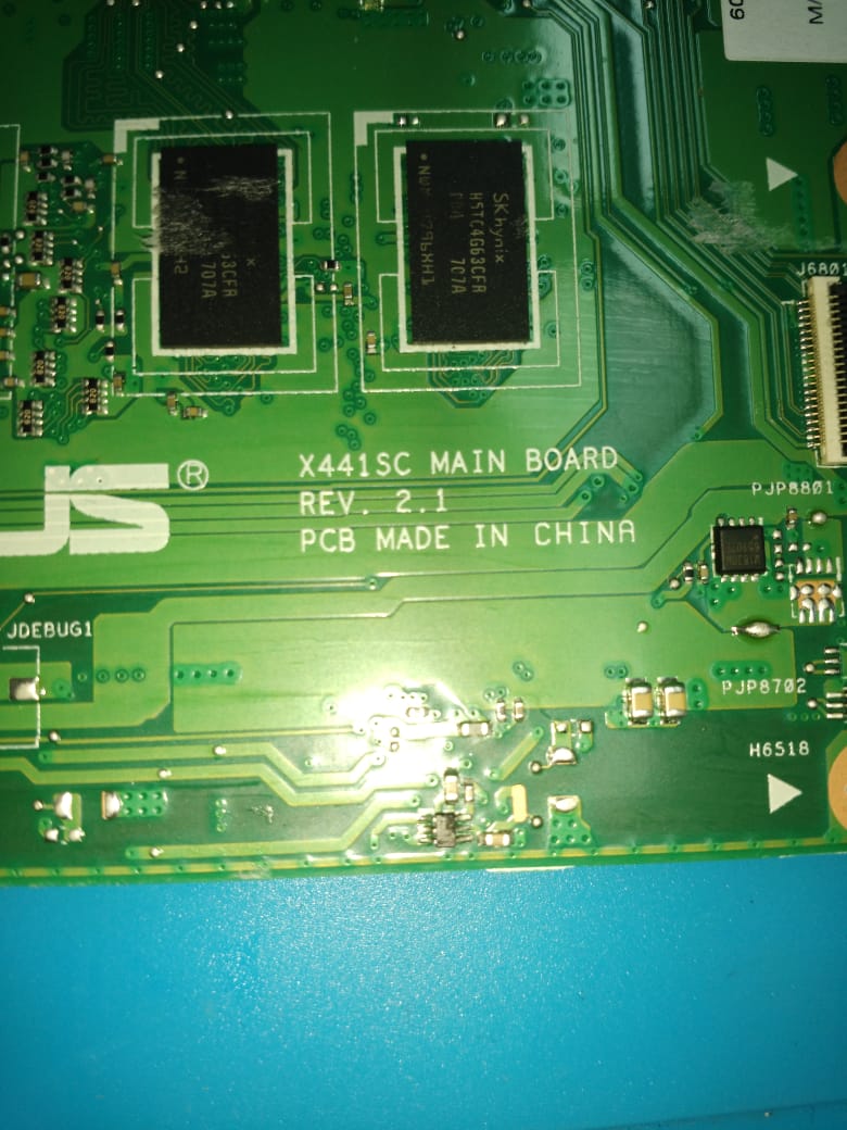

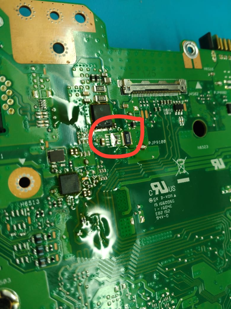

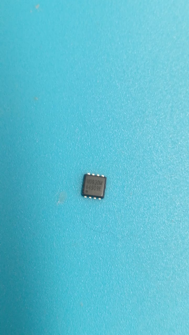

    this laptop dont trun on, but in verification process i was found that one ic is broken, near to lvds port the ic is m0930m 6490e, the problem is that i dont found datasheet to compare whit another similar and obviusly i dont have schematics or boardview.
    someone can tell me what kind of ic is this?? and the replacement. regardsss

    It is a N channel mosfet, you can replace it with an AON7430

      thx bro i use the ao7410 and is working regarddss
