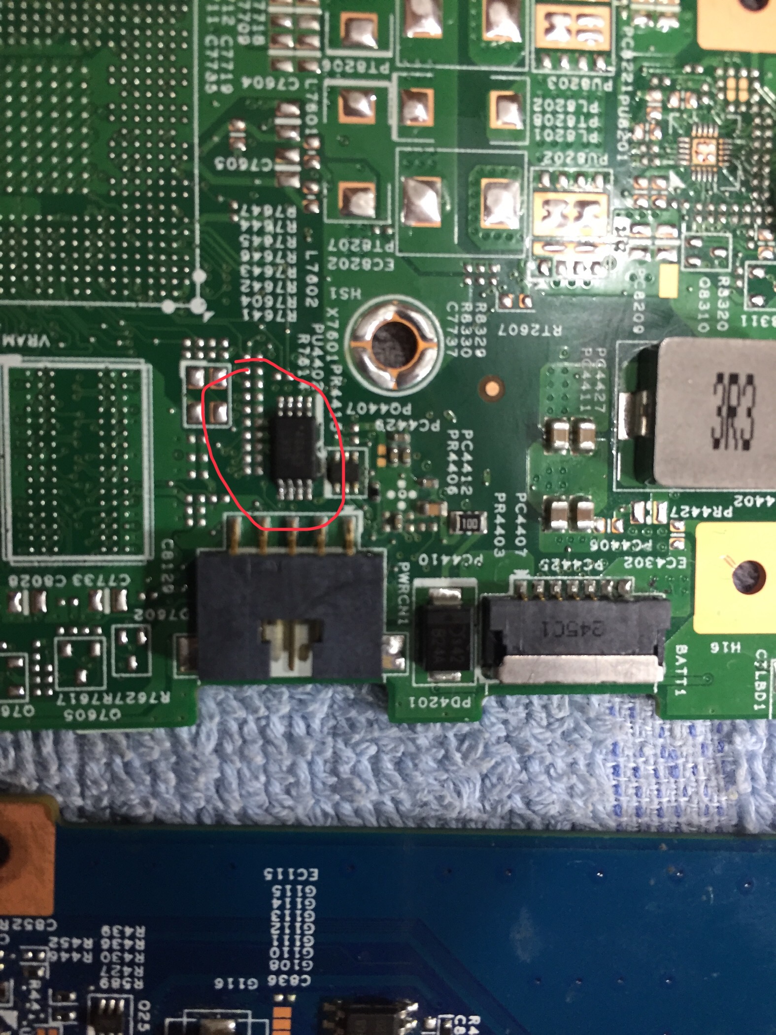

    Lenovo Flex 2 14" LF14M MB Please help me to identify component
    Hi there...
    Board No.:
    LF14M MB
    13281-1
    448.00X01.0011
    I've got Lenovo Flex 2 14" which doesn't charge battery. Sometimes it starts only for about 10 seconds & then cuts off. If I got lucky & manage to boot to windows, it shows battery fully charged with crossed battery icon. When I disconnect the charger it will cut off immediatelly. I can hear some buzzing noise from component PU4402 which says 49AG3 L393 on it (please refer to the pic). Any idea what component is it as I can't find schematic for this board? Thanks in advance.

    Re: Lenovo Flex 2 14" LF14M MB Please help me to identify component
    Seem it's LM393DR-GP with TSSOP8 package, not sure 100%. (modern packages, not like old LM393 SOP8)
    If we read Wistron Storm2 schematic, there is IC LM393 on block charger.
      You're right...Just found out it's TI LM393 voltage comparator in TSSOP8 package...

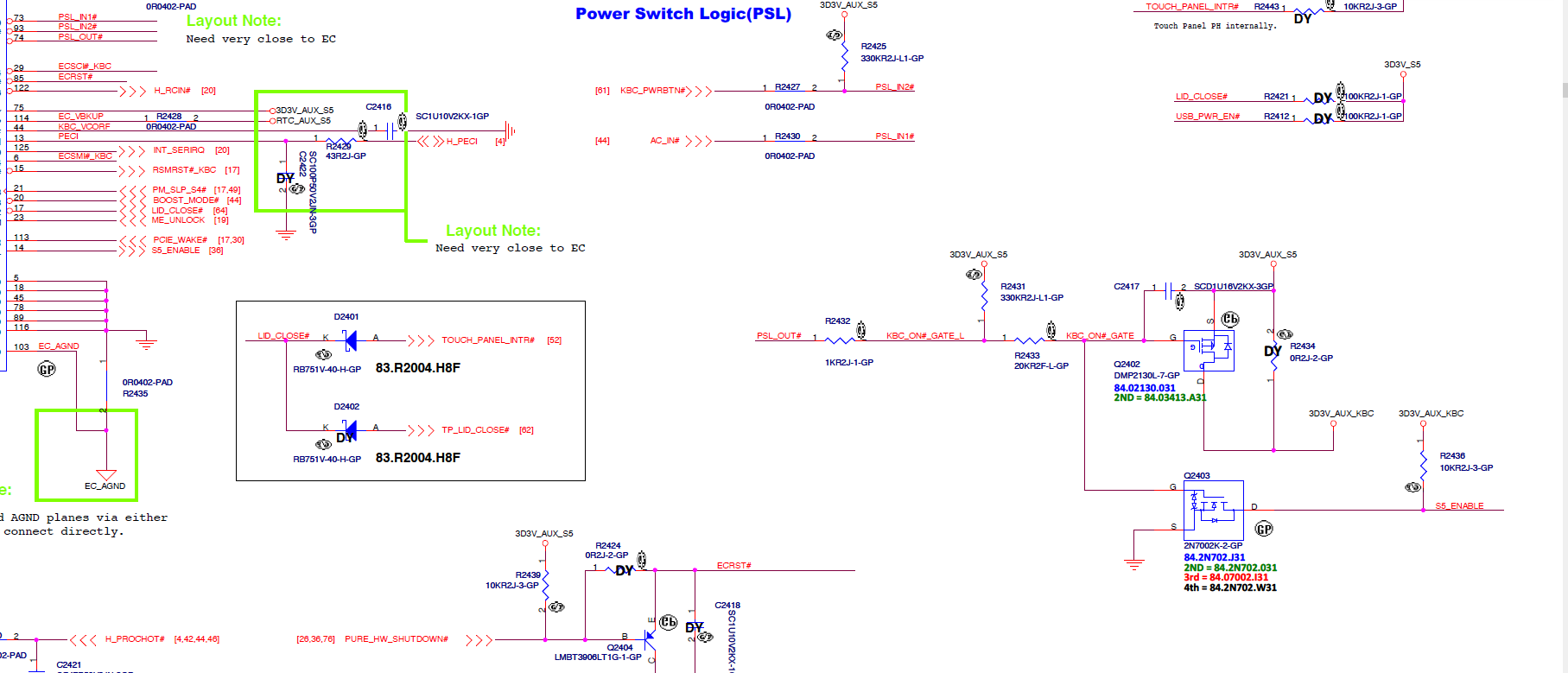

                  What about AC_IN# signal?
                  Purpose to know pinout NPCE285P
                  Link:
                  The suamain link goes to a 404 error page.
                  This link is working: http://suamainlaptop.com/uploads/files/schematics/

                    Does anyone know what signals must be present on NPCE285 before it sends PSL_OUT# ?
                      • 21874
                      Check page 96 of the cedar schematic posted by on/off , 3D3V_AUX_KBC "Red Words: Controlled by EC GPIO"
                        Originally posted by loser18
                        I think the problem is motherboard doesn't enter into S5 state as I've missing 3D3V_AUX_KBC voltages on all pins (19,46,76,88,115) of KBC (it's a NUVOTON NPCE285). There's no short on them. As far as I understand the 3D3V_AUX_KBC voltage is pulled down by Q2402 FET which should be activated by PSL_OUT# signal. This signal must be low, however it reads 3.3V ???
                        I don't see Q2402 in my HD image. LF14M_448.00X01.0011_Rev13281-1_photo-mb
                        only see Q2403. on redwood schematic seem q2402 not installed.
                        Wistron Redwood Wistron Redwood also use NPCE285P (in fact your board use NPCE285G) and same IC charger BQ24715.
                        The suffix G that could be mean programmable, but not sure.
                        on Redwood Suffix P, but there is ec eeprom MXIC25L100 (programmable external meaning). Redwood HD image :
                        http://ascnb1.ru/forma1/viewtopic.php?p=680558#p680558
                        I'm confuse right now about signal AC_IN#, active low or active high.
