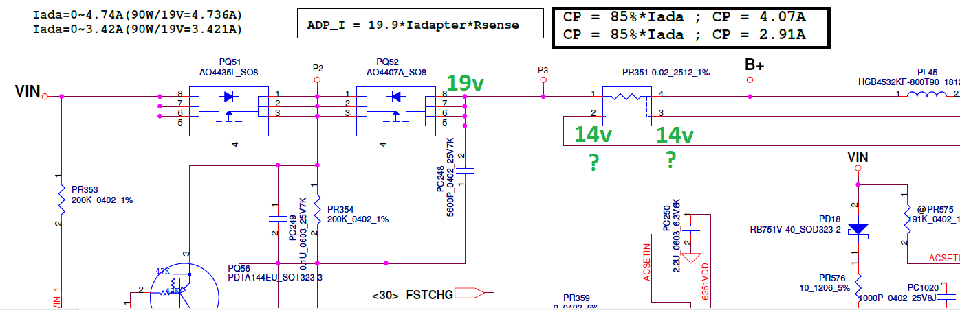

    ACER 5733 No Boot
    Having Problem with Motherboard no power LA-6582P Rev 1.0
    Thinking problem in Charging Circuit, Please Help.
    Voltage show in picture are on motherboard without battery plugged

    Re: ACER 5733 No Boot
    What is the voltage on PIN4 of PQ51/52?? Remove PR351 and see if you get 19V on atlest one side of PR351.
