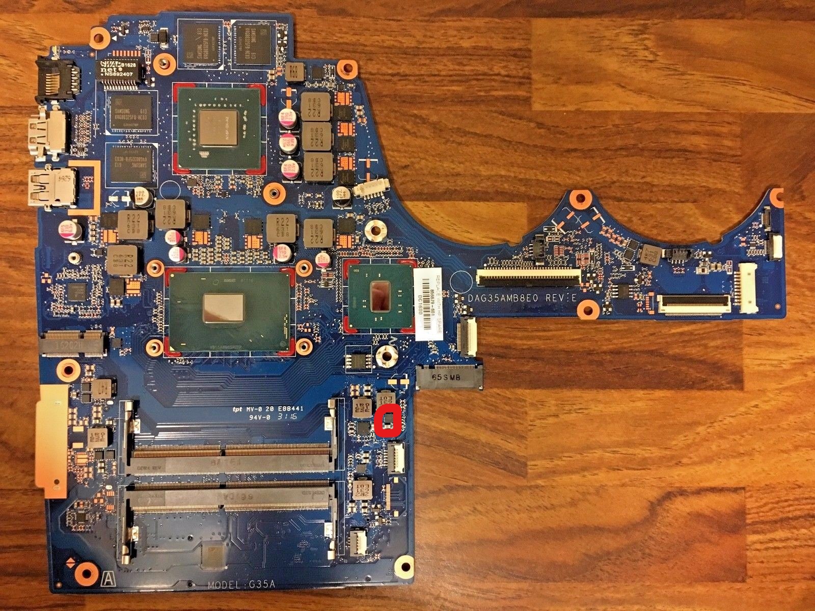

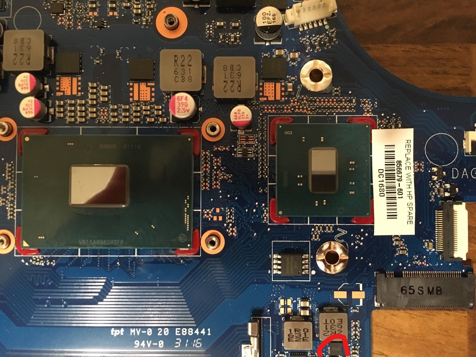

    I need help finding out what this part is called and where I can purchase this part. I have uploaded some pictures of the part.
    • 21889
    Re: HP Pavilion 15t-bc000 Parts Help
    Here`s a schematic https://www.badcaps.net/forum/showthread.php?t=63186
    It looks like a richtek or silergy part. Maybe SY8208B or SY8208C .
      • 21889
      Its a silergy SY8208C .
