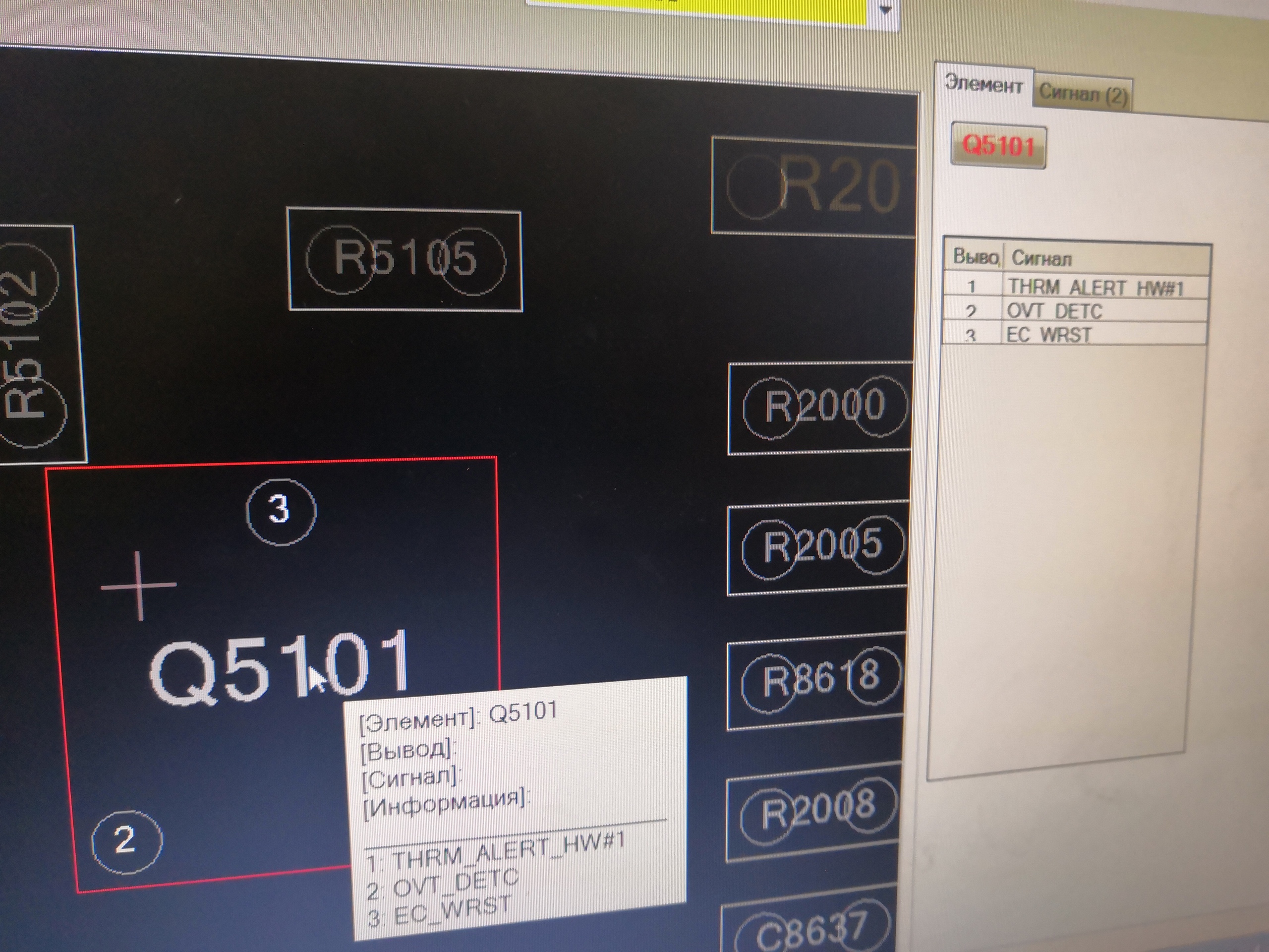

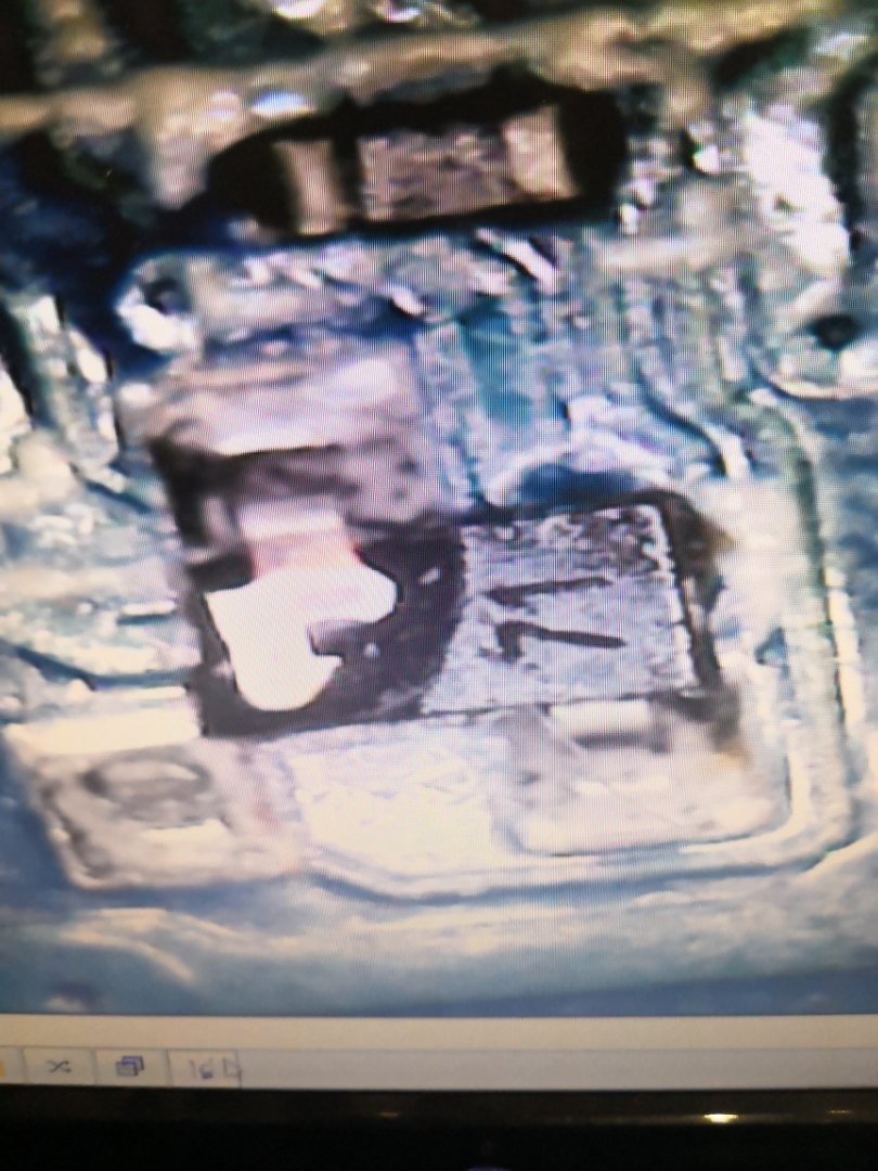

    Hi, this plate came after another service. Laptop became dead after cleaning by owner. SR30w has been replaced in previous service and it didn't help. During the visual inspection, the broken element Q5101 (METR3904-G) was found near the screw hole in the Board and replaced. Probably it was initial сause of the fault.
    My steps.
    1) Visual inspection
    2) replacement of broken element
    3) BIOS with clear ME (cause HUB has been replacement)
    Now the Board is trying to turn on, but goes down after a couple of seconds.
    #PlstRst turned into 3.3
    Shoud i reball or replace hub? Whats wrong with this plate. How can i fix it?
  • DioTheSlayer
    • Oct 2018
    • 4
    • Russia
    Re: hp omen 15 ax232ur (dag35dmbad0) turns off
    By the way, there is exist exchange between bios and hub.
    Resistant on usb data is ok.
