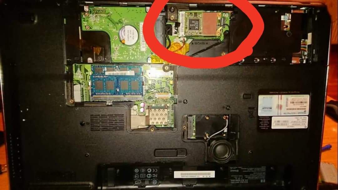

            Have a really stupid question.
            Can I put the WiFi card into the pci slot for tv tuner, currently in it a 309-b avermedia.
            I tried it and yes, it works in that slot heh, but the wifi antenas can't reach it, so the signal is poor. Have to disassemble it completely and see if i can get them there
            • 123XYZ123
              • Feb 2017
              • 53
              • NY
              Re: HP Pavilion dv8 Wi-Fi problem
              Can I say that the mini PCIe WiFi slot is faulty?
              And there is a difference, the WiFi card feels really loose in it, while in the other slot it fits perfectly.
              Any ideas for the antennas? ��
