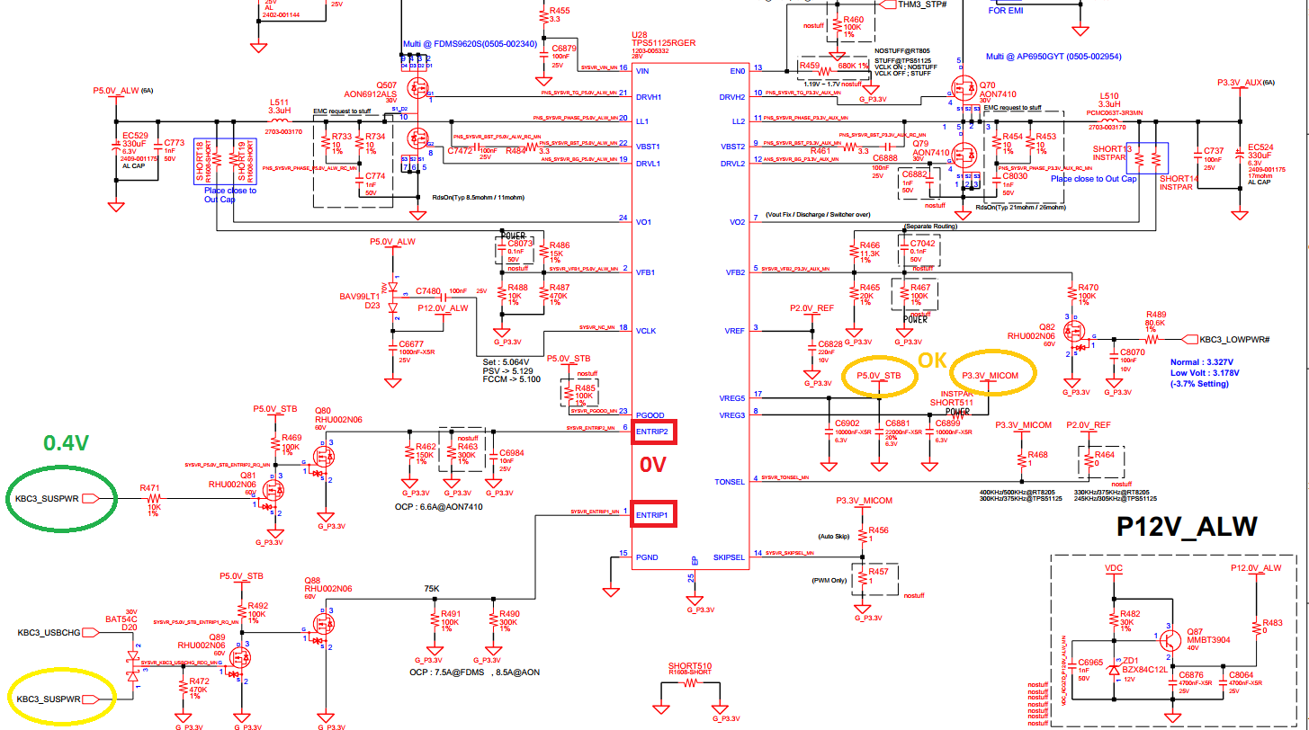

    I have this board with this serial number :
    BA41-01900A
    at this time ist dead
    there is TPS51125 chip for 3.3v and 5v Line
    i checked, dont have voltage.
    also checked VREG3 and VREG5 . ist OK
    checked ENTRIP1 and ENTRIP2 , ist 0.4V
    i thinks "KB9010" is dead
    any suggestion ?

    In addition to KB9010, there are a number of other circuits that can be faulty. but KB9010 is the most probable suspect. What voltage is at pin13 of TPS51125 ?
      Pin13 =3.0V
      how i can test KB9010 ?

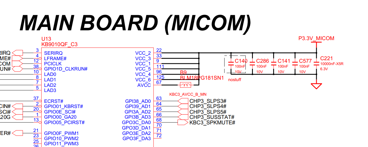

        First check pin 26 or 50. Those pins are kbc power. If shorted, then remove kbc and re check for shorts on those pins. If it doesnt reach any conclusion , you need to measure which kbc pins are showing very low resistance or shorted to ground and what those pins stand for-thereby making your own conclusion.
        Btw, you can remove the kbc , clean the pads and then connect adapter and re check voltages on tps 51125.
          i tested power supply for KBC , ist ok
          in addition, Pin power supply isnt 26&50

            first reprogram KB9010. if there was no result, replace KB9010 if you got another one. If you are not skilled in microsoldering, do not replace it yourself.
            • kokono
              • Jun 2018
              • 203
              Re: Samsung MCLAREN REV: 1.0
              Update :
              i changed KB9010 "WITHOUT" any Program
              and now working perfect

                In this model, io programs itself. No need to program io afterwards.
