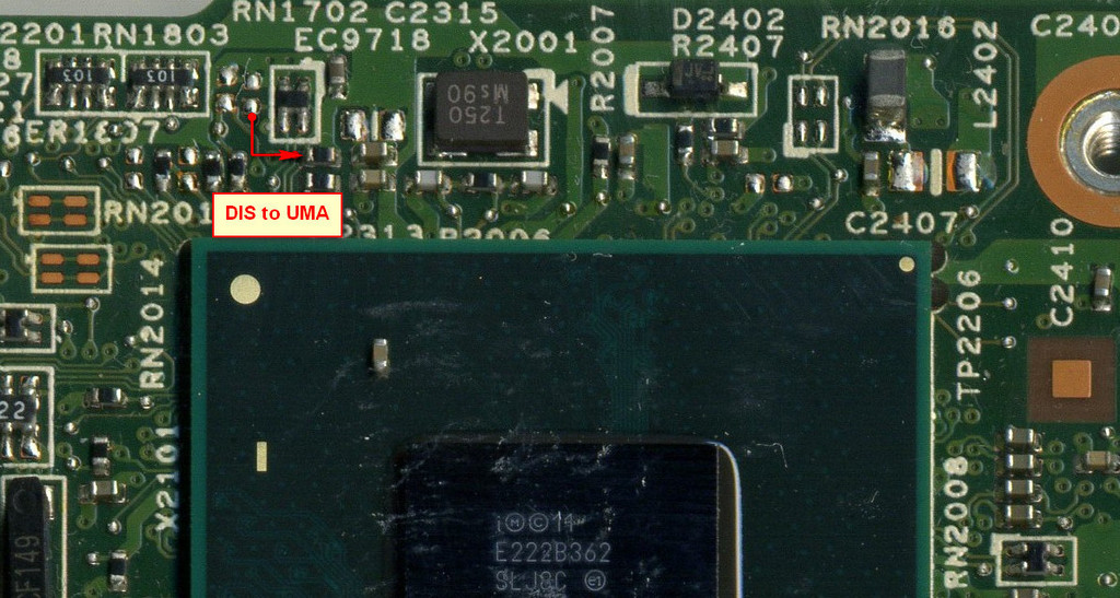

    Model: Dell Inspiron 14z-5423
    MB codeBM40
    MB runs for 10 mins and gets off. graphics chip becomes red hot.
    Anybody have the dis-uma conversion guide or even boardview.
    I've digged in to the schematics and seems like these two resistors only needs to beshifted but i cant find there location on mb.
    R2005 needs to shifted to R2004(PEG_CLKREW#R)
    R2013 needs to shifted to R2013(BOARD ID)
    can anybody help??

    Re: Dell inspiron 14z-5423 dis to uma
    No boardview available . I found a guide someone made but i`m not a member on their forum. https://laptoprefix.com/viewtopic.php?t=3241
      Thanks SMDFlea for response. I was able to convert this mb to uma. Its working perfect now with over 8 hours , still running.
            @mcplslg123 can you please share an image where is the resistor located
              Here you go my friend. You need to remove coil also for discrete graphics power.
                thank you mcplslg123 where is the coil to remove located?
                  Poke into schematics and you can easily find out the coil for graphics supply. I dont have a pic saved for that and neither i have the mobo in hand-so cant help on that.
