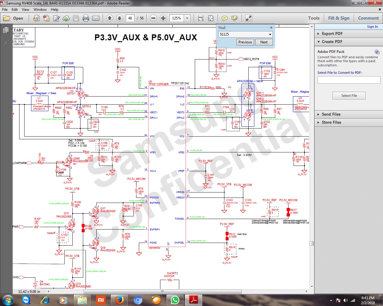

    Hi, friend. Somebody has experienced. Samsung RV408. IC TPS51125 is hot. And do not want on. I am injecting at 5v and 3v. Its hot ic TPS 51125. Changed the same. Please help. Thanks friends ...
    Vreg 3 out 2.6v Vreg 5 out 4.7v hot IC ...
    Caps already in the same change ...

    It's possible that there is a short on 3v or 5v line, search on schematic if there is some jumper pad to exclude those lines and verify that the voltages are ok.
      Solved sir. Caps short...
      thx sir...

        error rtc, C146, C145
